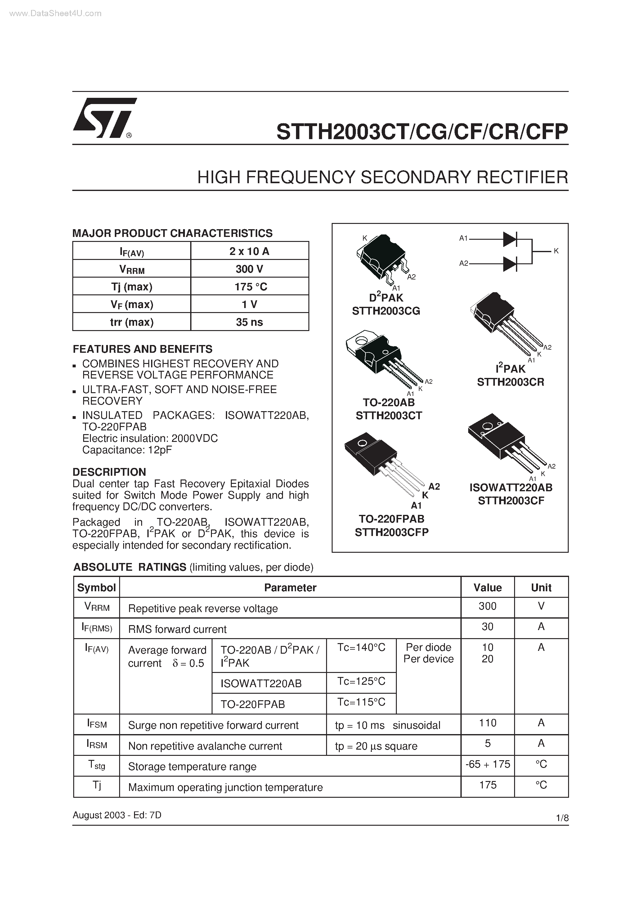

STTH2003CF-HIGH FREQUENCY SECONDARY RECTIFIER
Producer:ST Microelectronics
Description:HIGH FREQUENCY SECONDARY RECTIFIER
