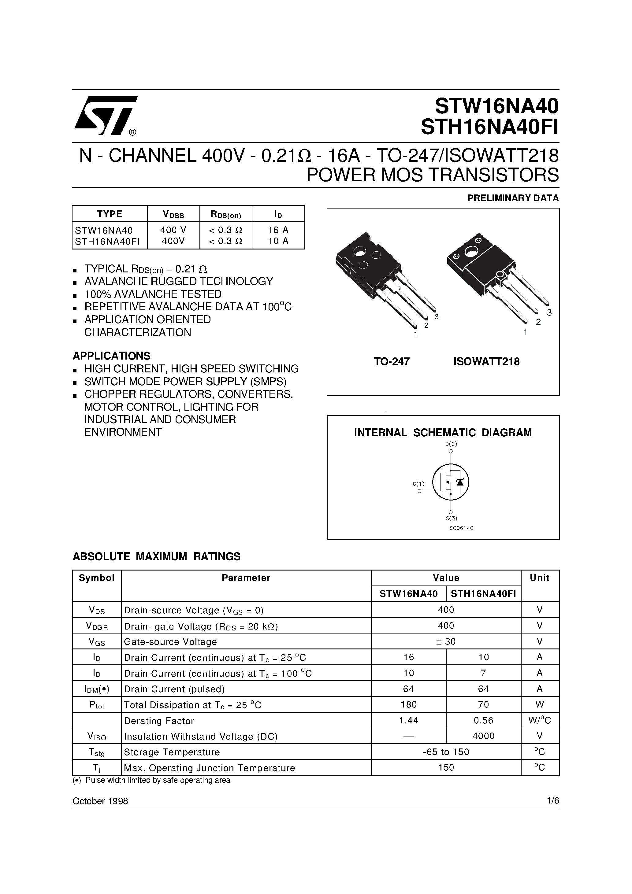

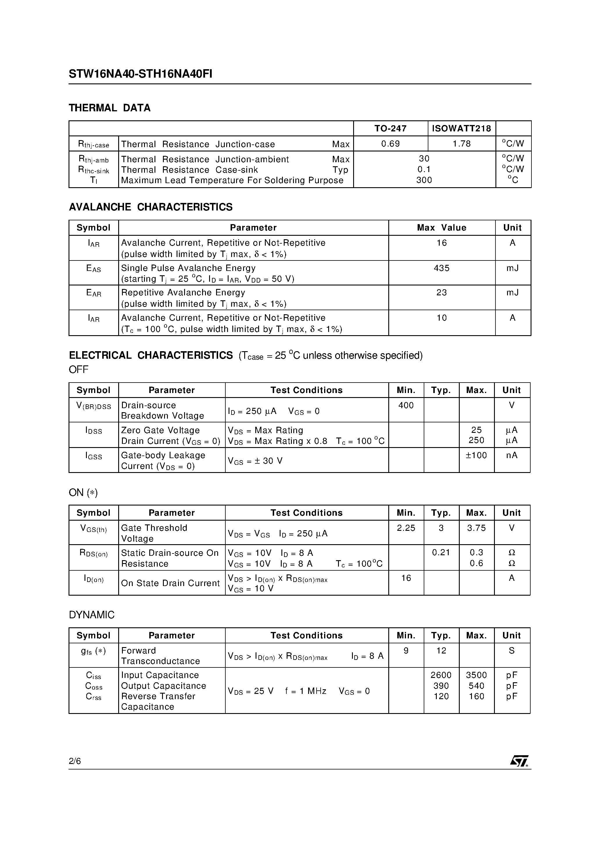

STW16NA40-N - CHANNEL 400V - 0.21ohm - 16A - TO-247/ISOWATT218 POWER MOS TRANSISTORS
Producer:ST Microelectronics
Description:N - CHANNEL 400V - 0.21ohm - 16A - TO-247/ISOWATT218 POWER MOS TRANSISTORS
