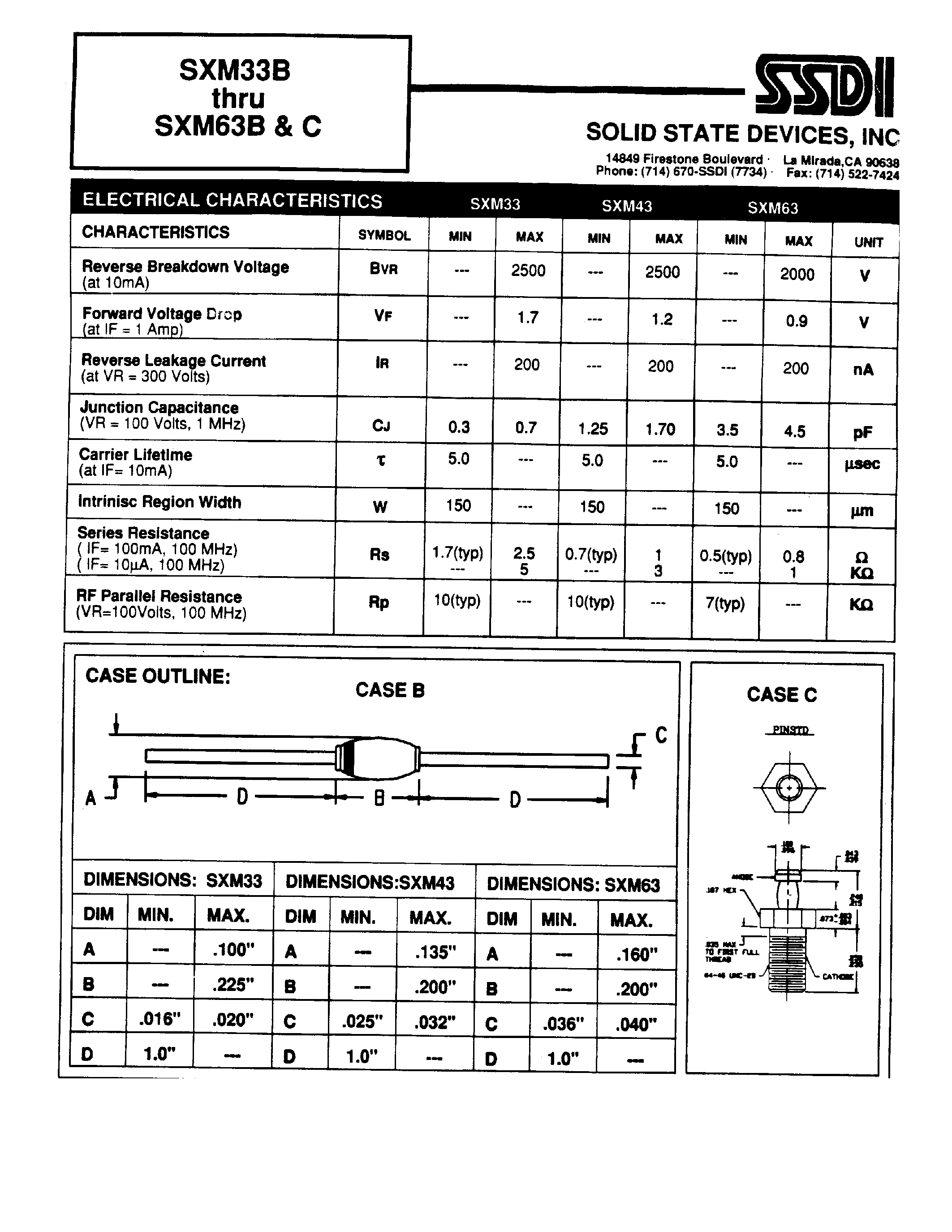

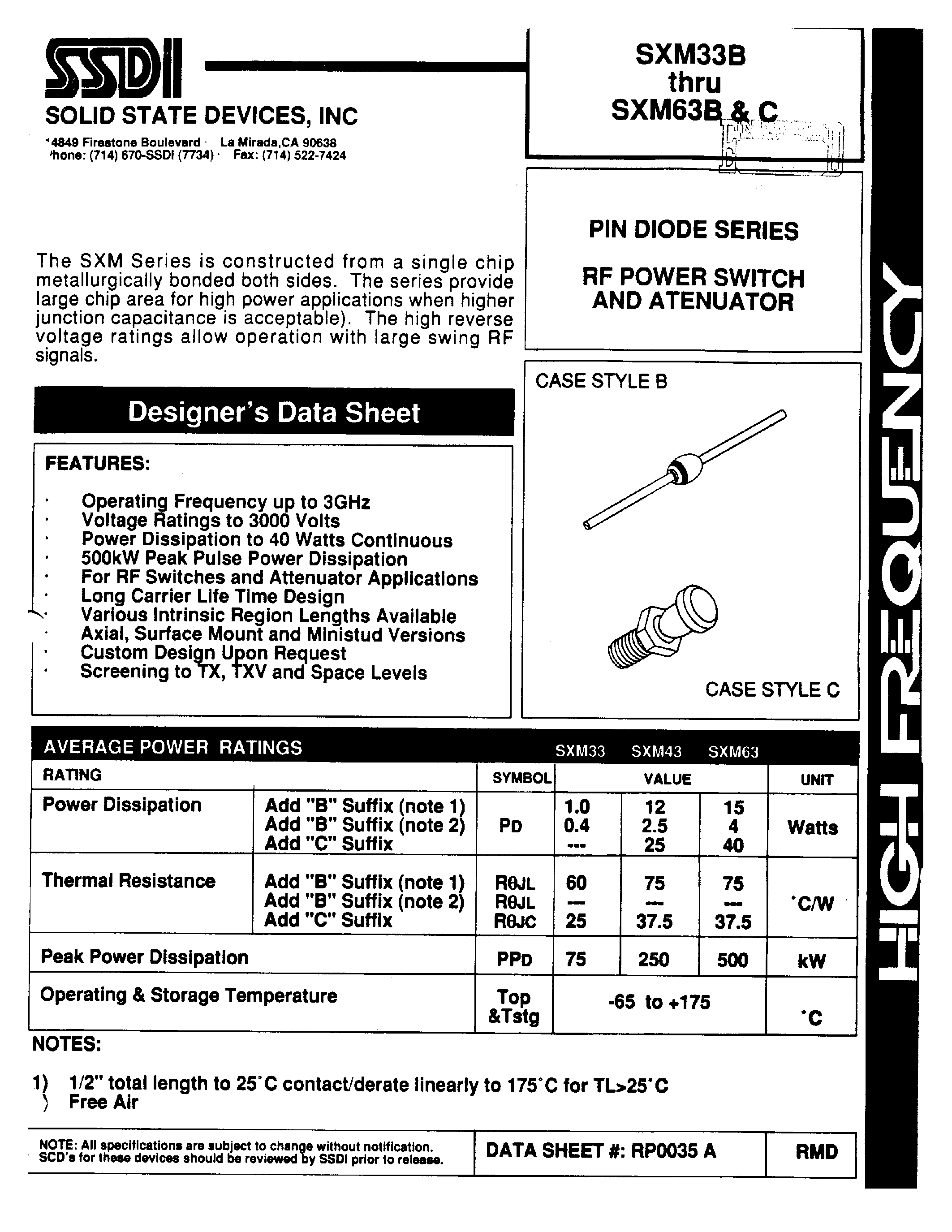

SXM33B-(SXMx3B) PIN DIODE RF POWER SWITCH AND ATENUATOR
Producer:SSDI
Description:(SXMx3B) PIN DIODE RF POWER SWITCH AND ATENUATOR
