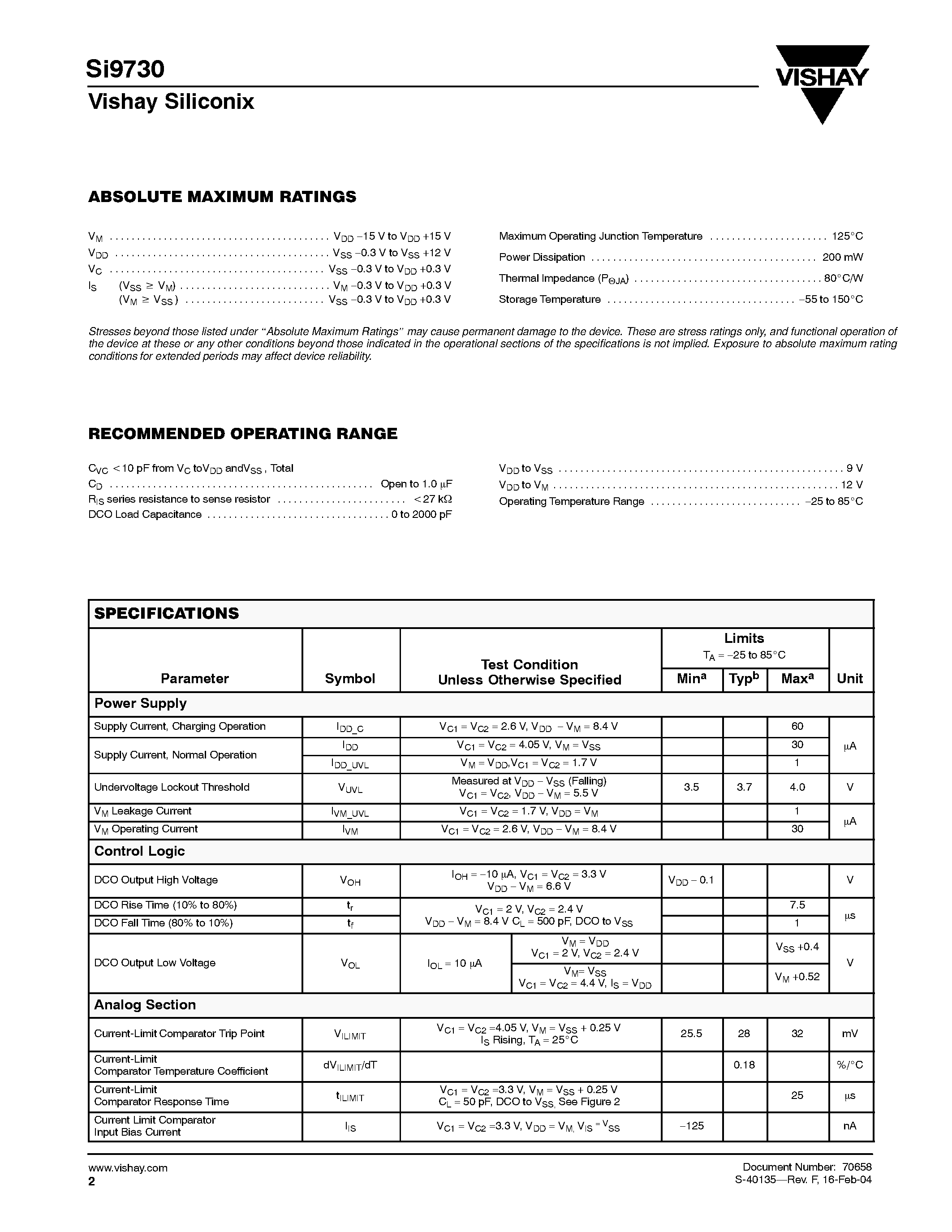

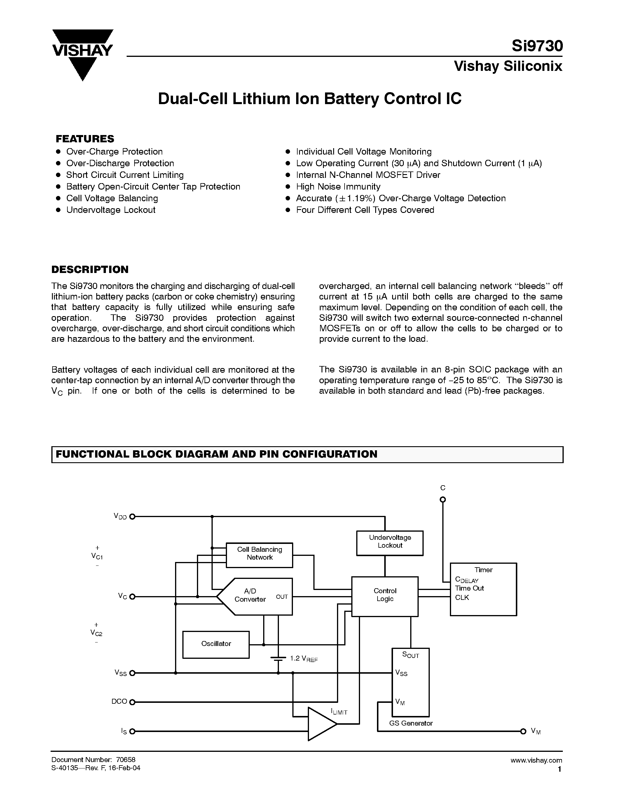

Si9730CBY-T1-E3-Dual-Cell Lithium Ion Battery Control IC
Producer:Vishay Siliconix
Description:Dual-Cell Lithium Ion Battery Control IC
