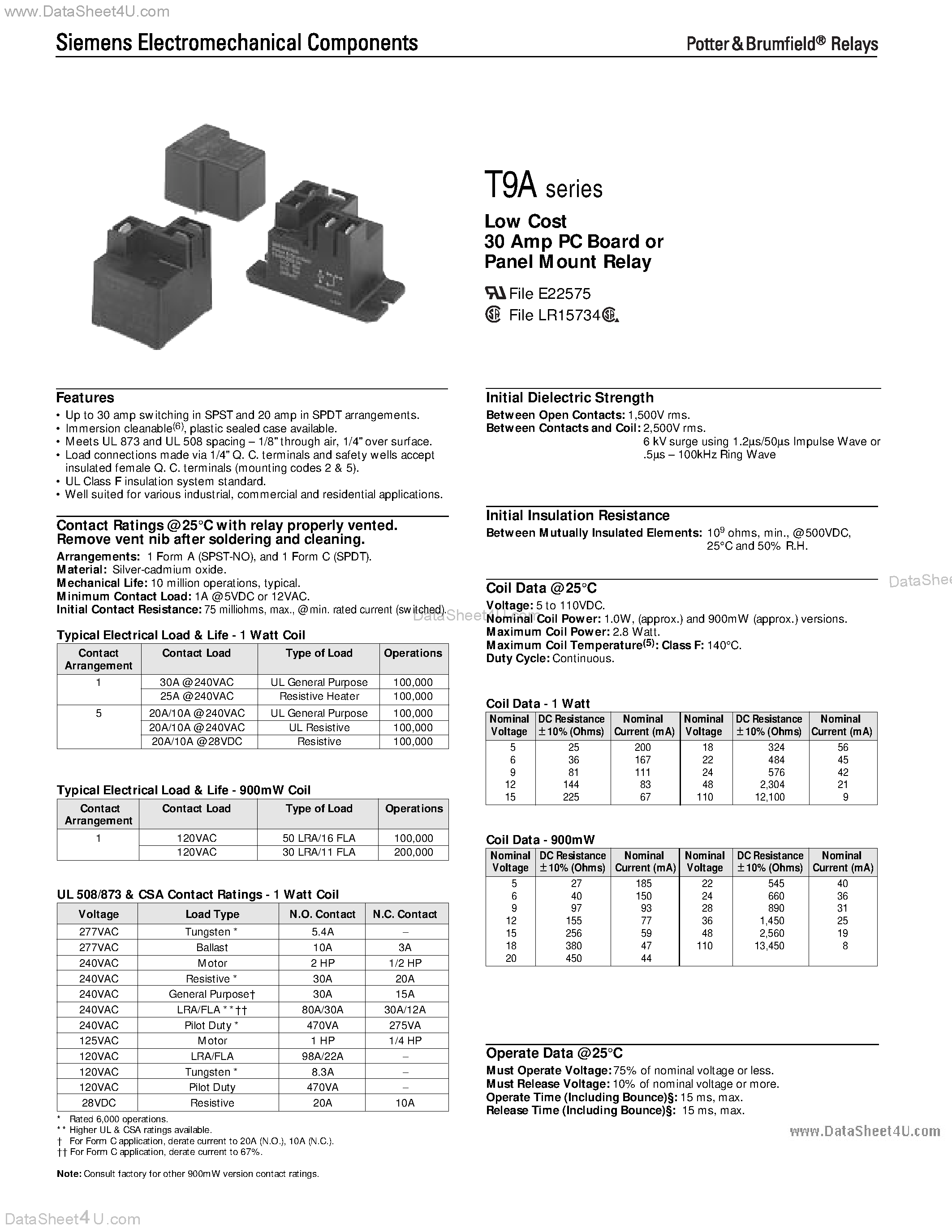

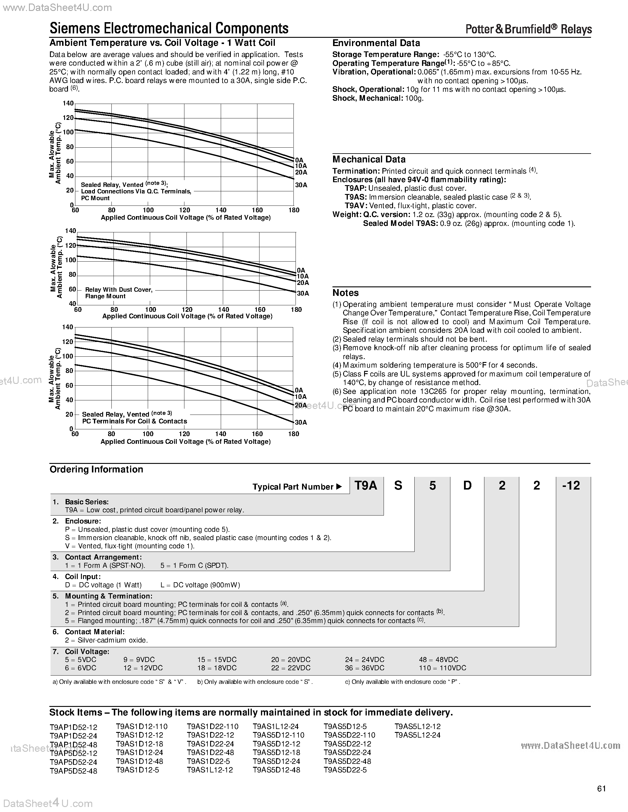

T9AP1D52-xx-(T9A Series) Low Cost 30 Amp PC Board or Panel Mount Relay
Producer:Siemens
Description:(T9A Series) Low Cost 30 Amp PC Board or Panel Mount Relay
