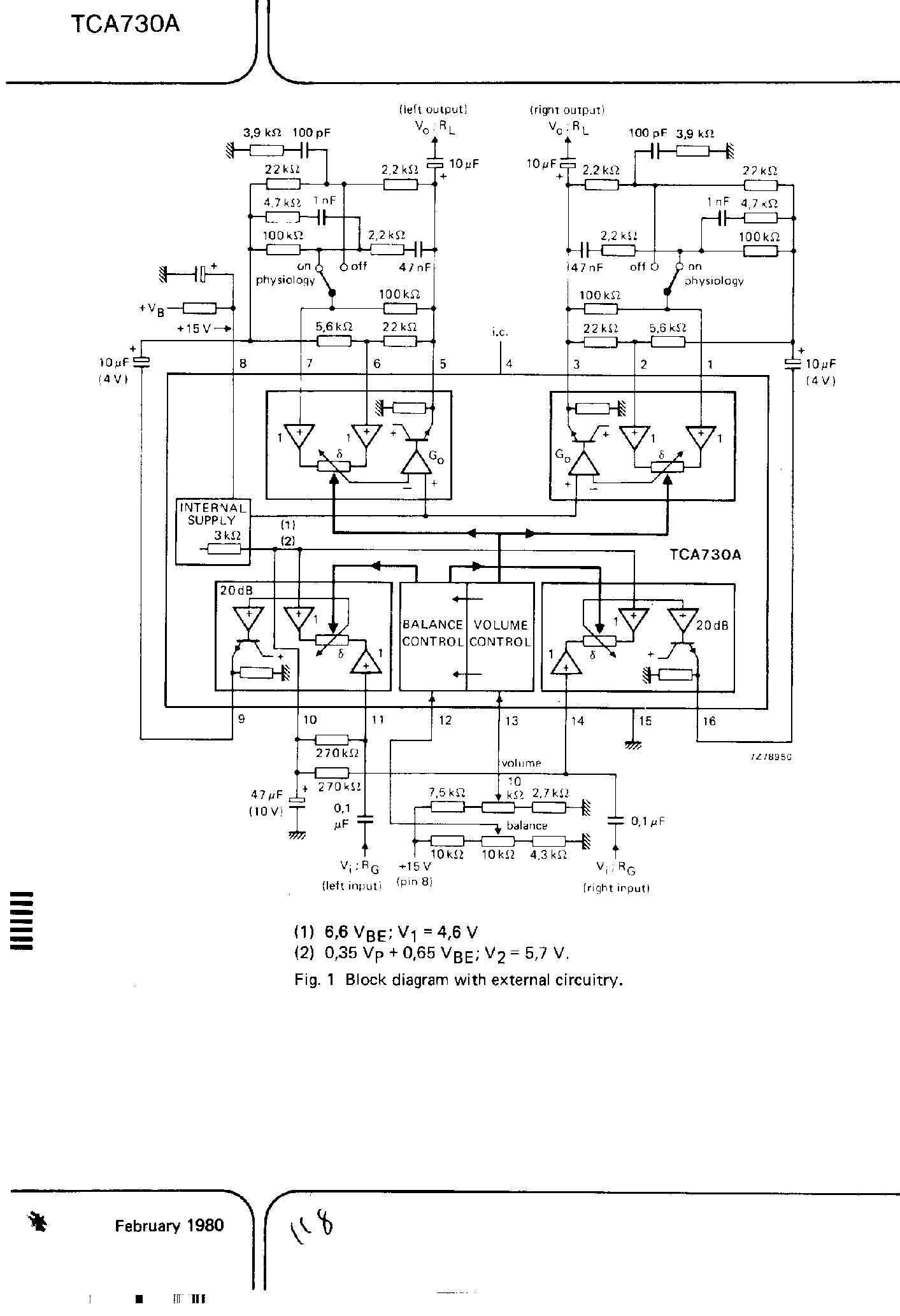

TCA730A-D.C. VOLUME AND BALANCE STEREO CONTROL CIRCUIT
Producer:ETC
Description:D.C. VOLUME AND BALANCE STEREO CONTROL CIRCUIT
