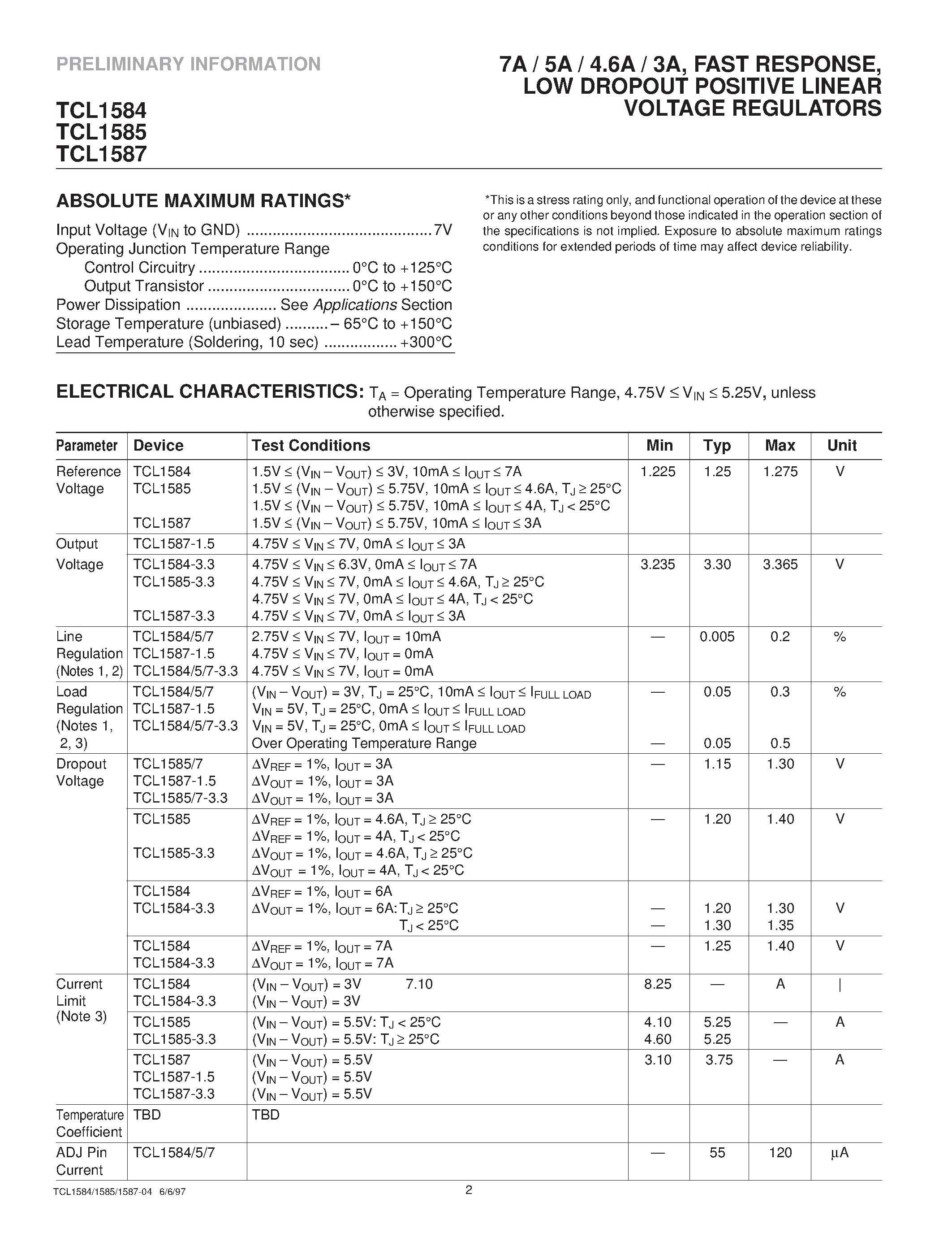

TCL1585-7A / 5A / 4.6A / 3A/ FAST RESPONSE/ LOW DROPOUT POSITIVE LINEAR VOLTAGE REGULATORS
Producer:TelCom Semiconductor
Description:7A / 5A / 4.6A / 3A/ FAST RESPONSE/ LOW DROPOUT POSITIVE LINEAR VOLTAGE REGULATORS
