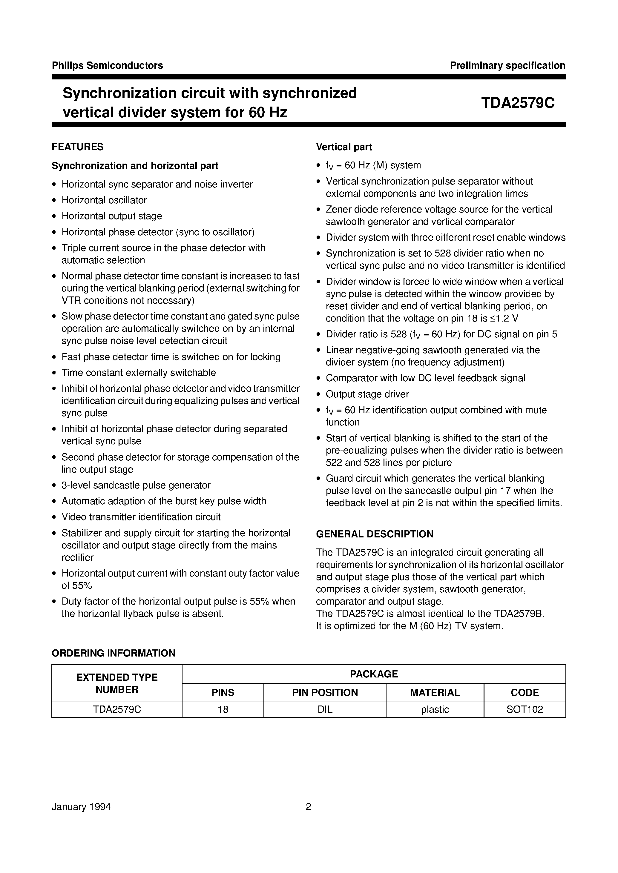

TDA2579C-Synchronization circuit with synchronized vertical divider system for 60 Hz
Description:Synchronization circuit with synchronized vertical divider system for 60 Hz
Others with the same file: TDA2579C
Datasheet TDA2579C - Synchronization circuit with synchronized vertical divider system for 60 Hz page 1
Datasheet TDA2579C - Synchronization circuit with synchronized vertical divider system for 60 Hz page 2
