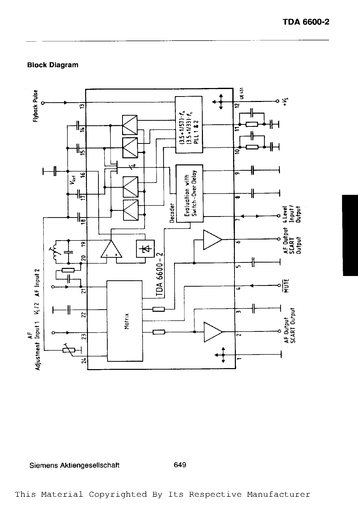

TDA6600-2-TV Stereo Decoder with Matrix Preliminary Data
Producer:Siemens Semiconductor
Description:TV Stereo Decoder with Matrix Preliminary Data
