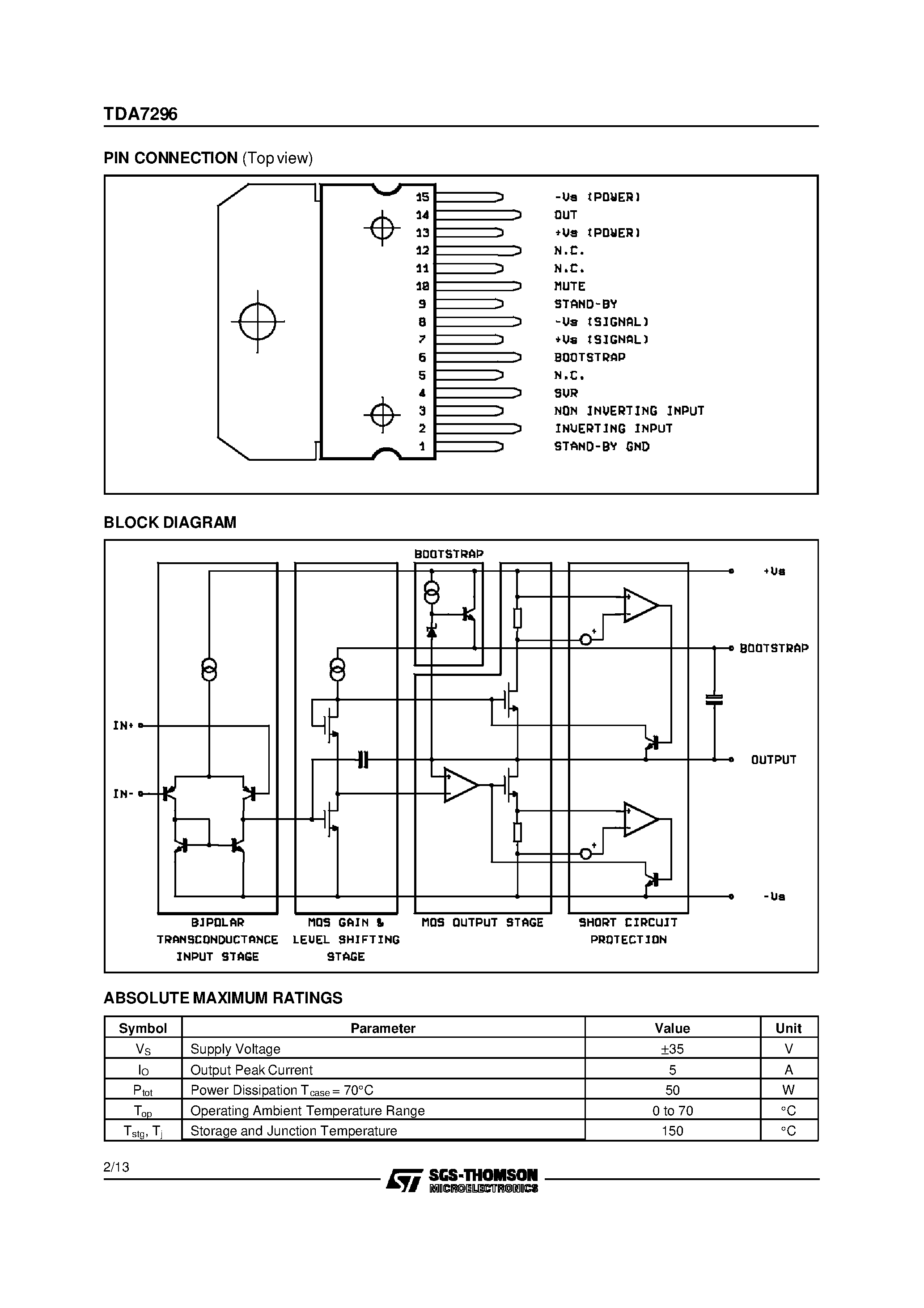

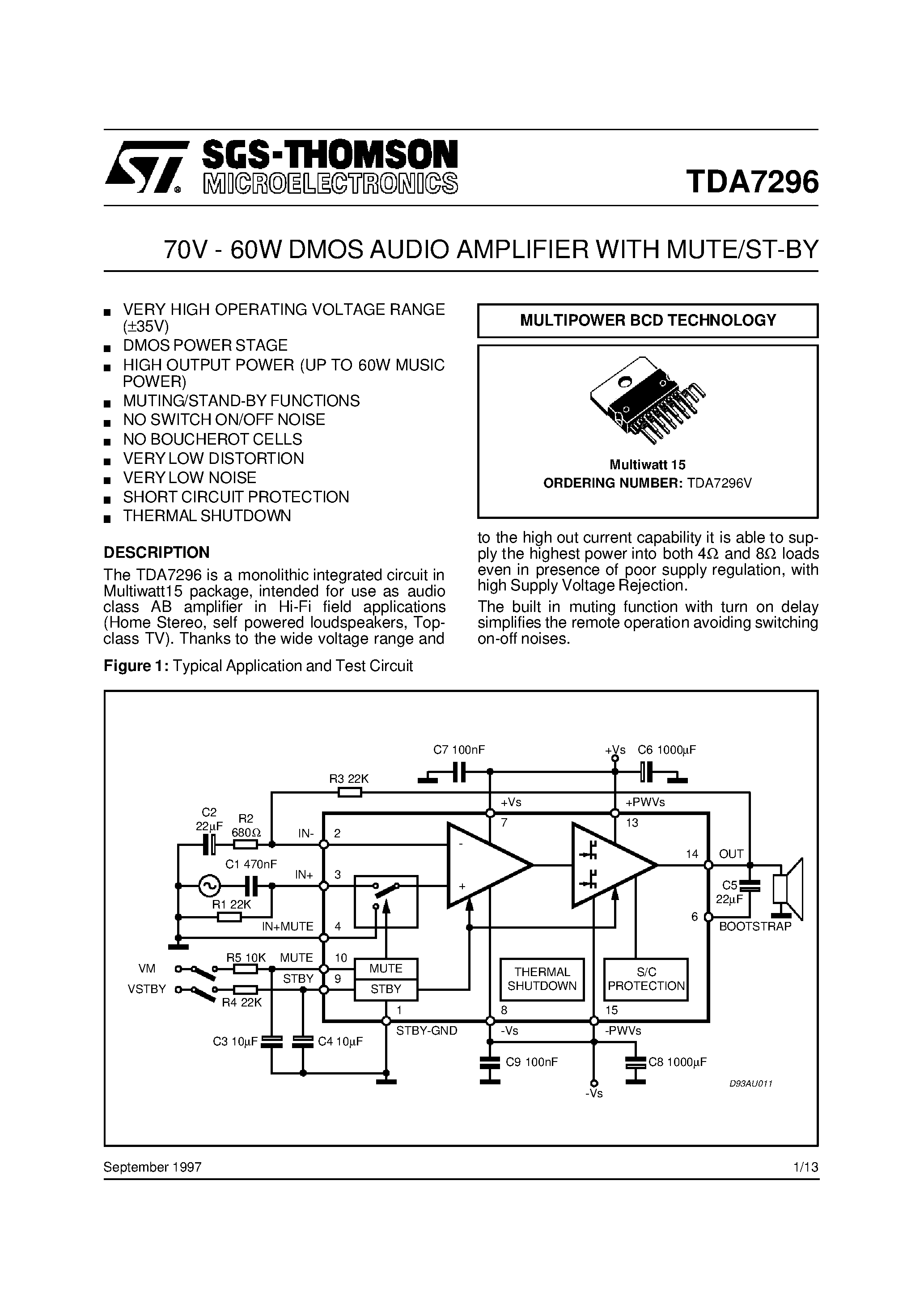

TDA7296V-70V - 60W DMOS AUDIO AMPLIFIER WITH MUTE/ST-BY
Producer:ST Microelectronics
Description:70V - 60W DMOS AUDIO AMPLIFIER WITH MUTE/ST-BY
Others with the same file: TDA7296V
Datasheet TDA7296V - 70V - 60W DMOS AUDIO AMPLIFIER WITH MUTE/ST-BY page 1
Datasheet TDA7296V - 70V - 60W DMOS AUDIO AMPLIFIER WITH MUTE/ST-BY page 2
