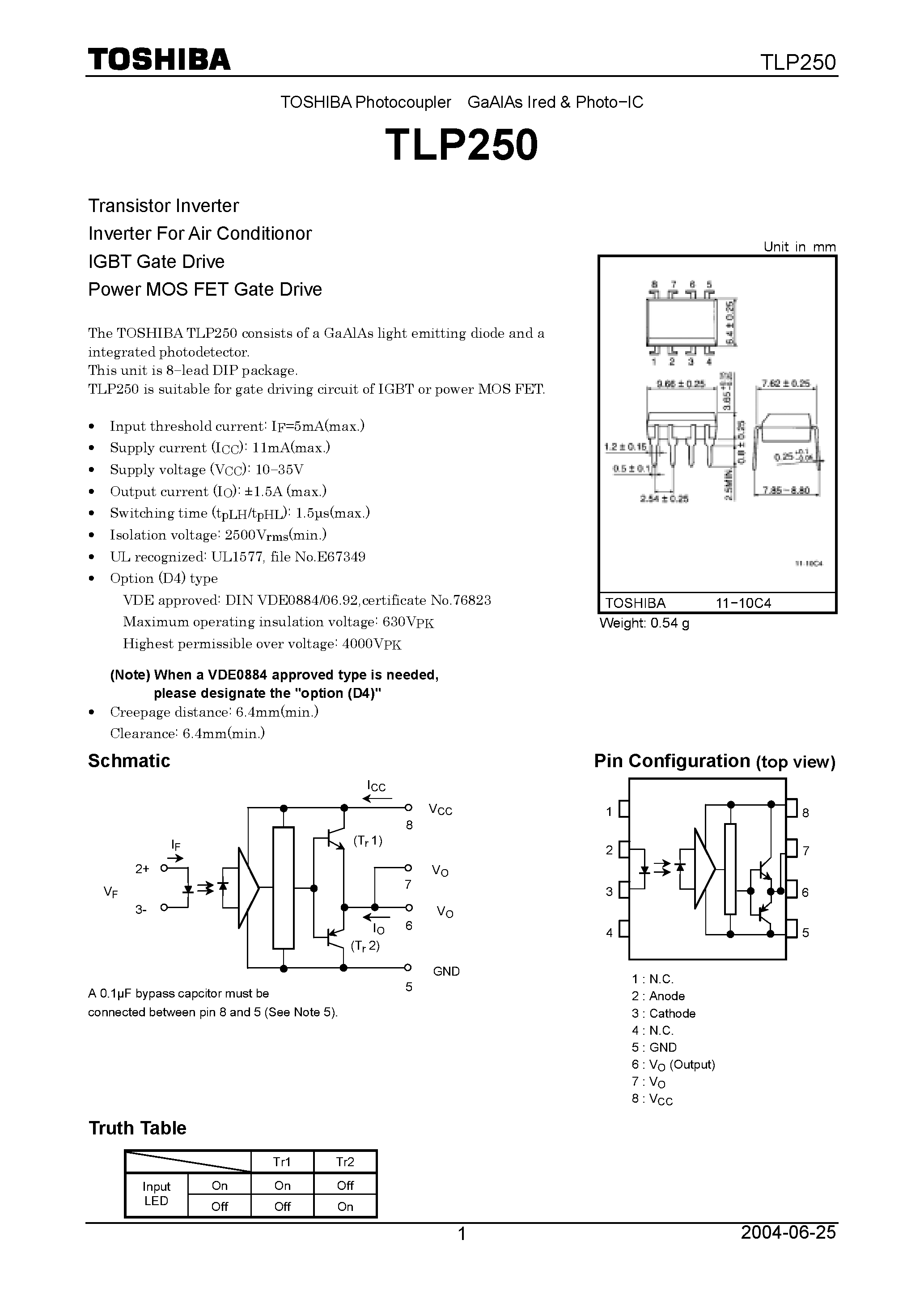

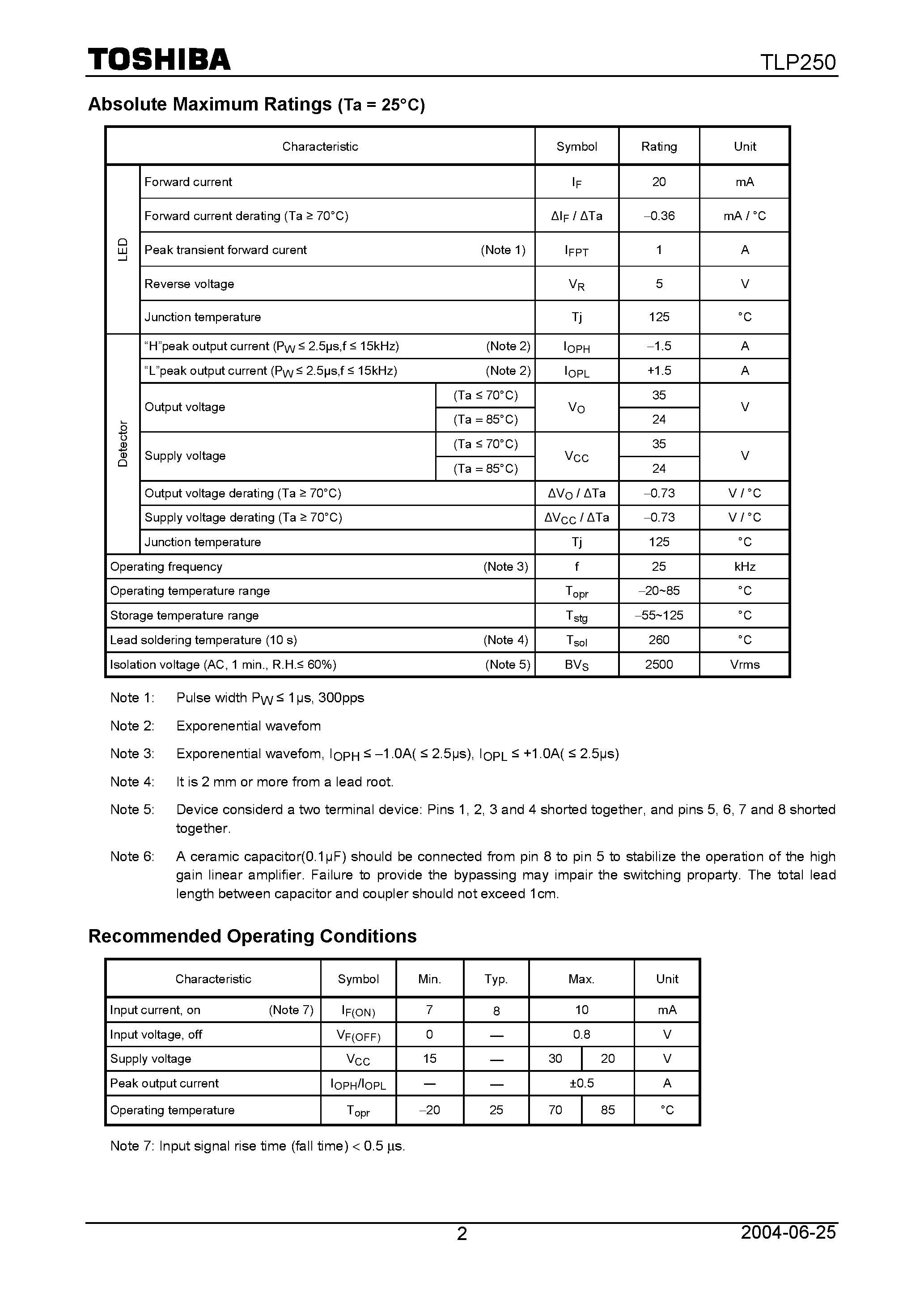

TLP250-TRANSISTOR INVERTER FOR AIR CONDITIONOR IGBT GATE DRIVE POWER MOS FET GATE DRIVE
Description:TRANSISTOR INVERTER FOR AIR CONDITIONOR IGBT GATE DRIVE POWER MOS FET GATE DRIVE
Others with the same file: TLP250
Datasheet TLP250 - TRANSISTOR INVERTER FOR AIR CONDITIONOR IGBT GATE DRIVE POWER MOS FET GATE DRIVE page 1
Datasheet TLP250 - TRANSISTOR INVERTER FOR AIR CONDITIONOR IGBT GATE DRIVE POWER MOS FET GATE DRIVE page 2
