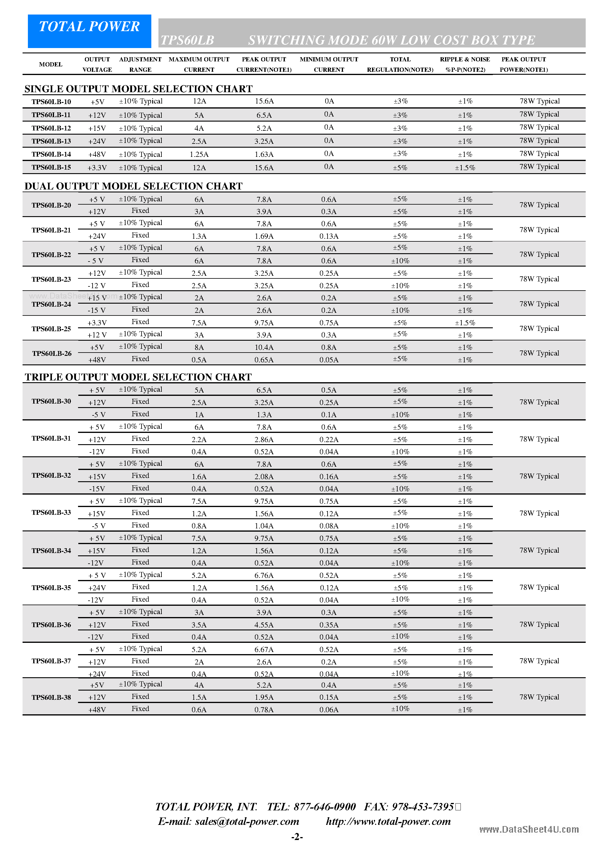

TPS60LB-SWITCHING MODE 60W LOW COST BOX TYPE POWER SUPPLY
Producer:Total Power International
Description:SWITCHING MODE 60W LOW COST BOX TYPE POWER SUPPLY
