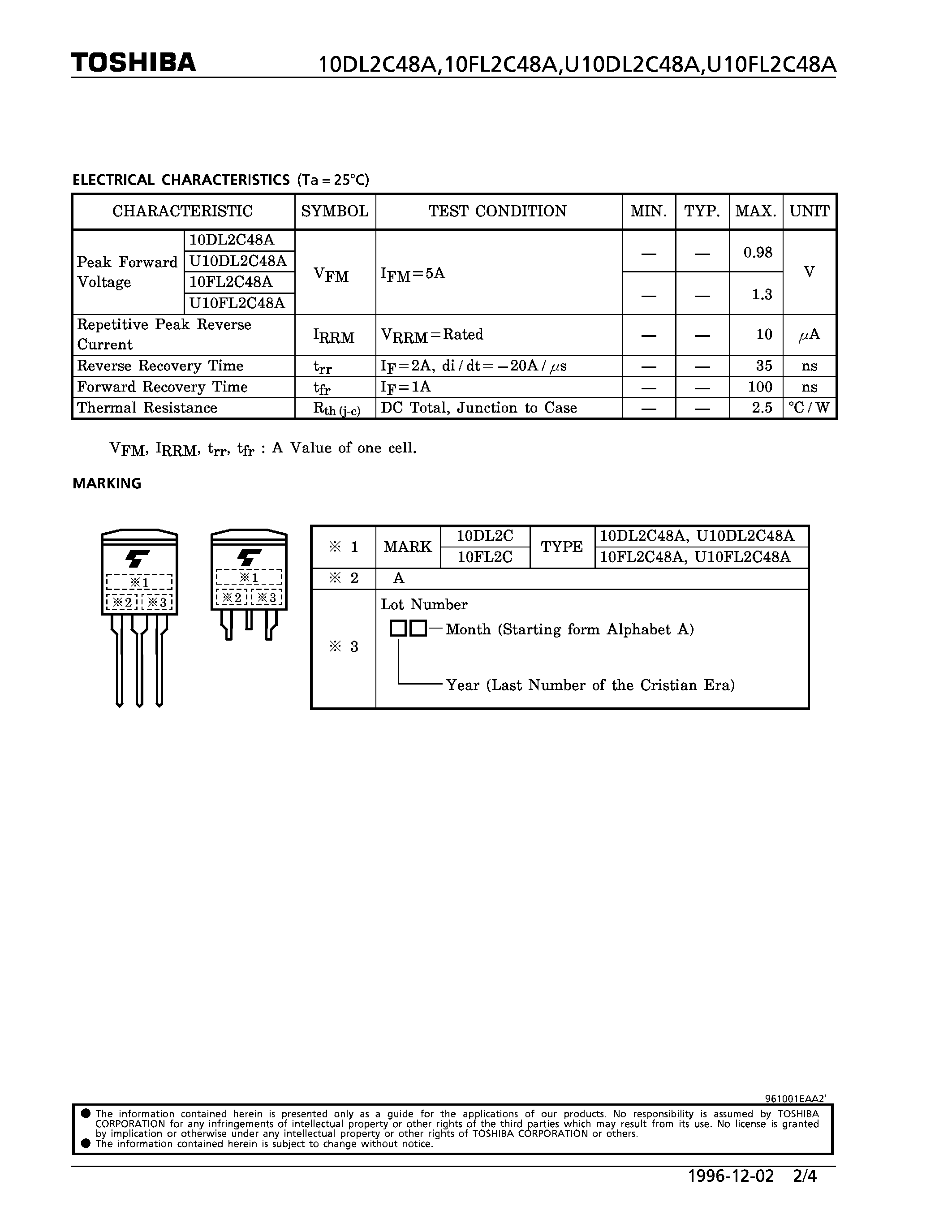

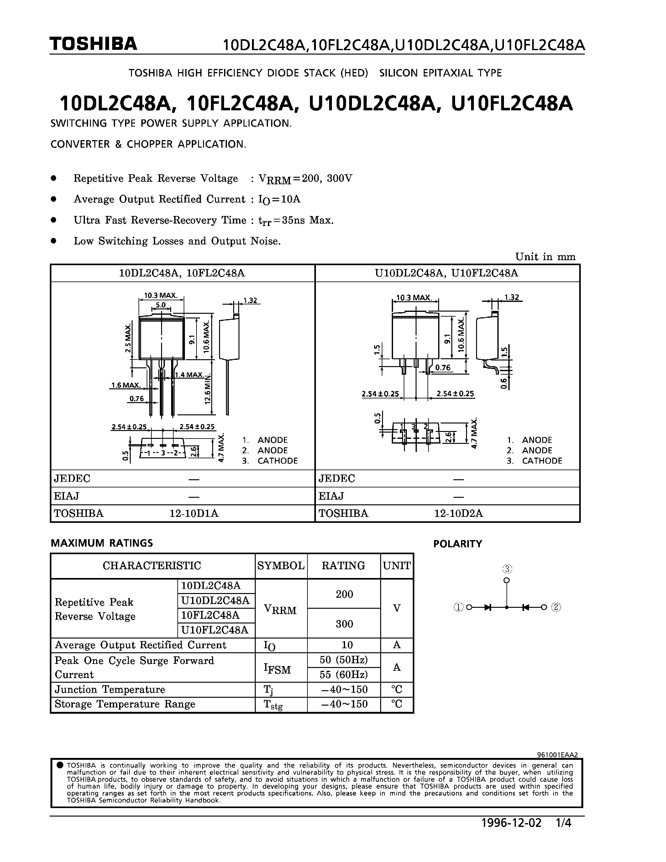

U10DL2C48A-DIODE STACK (SWITCHING TYPE POWER SUPPLY APPLICATION. CONVERTER & CHOPPER APPLICATION.)
Description:DIODE STACK (SWITCHING TYPE POWER SUPPLY APPLICATION. CONVERTER & CHOPPER APPLICATION.)
Others with the same file: U10DL2C48A
Datasheet U10DL2C48A - DIODE STACK (SWITCHING TYPE POWER SUPPLY APPLICATION. CONVERTER & CHOPPER APPLICATION.) page 1
Datasheet U10DL2C48A - DIODE STACK (SWITCHING TYPE POWER SUPPLY APPLICATION. CONVERTER & CHOPPER APPLICATION.) page 2
