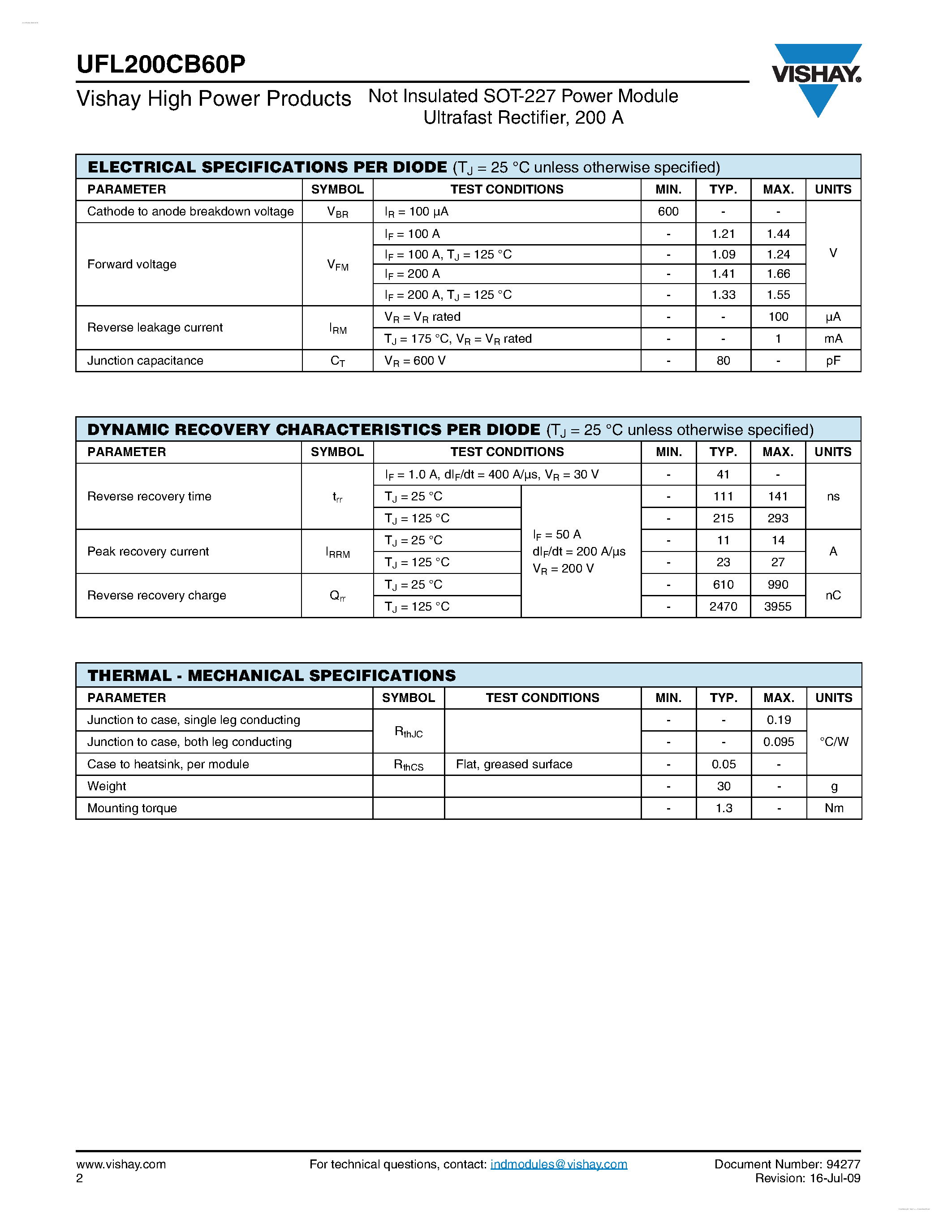

UFL200CB60P-Power Module Ultrafast Rectifier
Producer:Vishay Siliconix
Description:Power Module Ultrafast Rectifier
Others with the same file: UFL200CB60P
Datasheet UFL200CB60P - Power Module Ultrafast Rectifier page 1
Datasheet UFL200CB60P - Power Module Ultrafast Rectifier page 2
