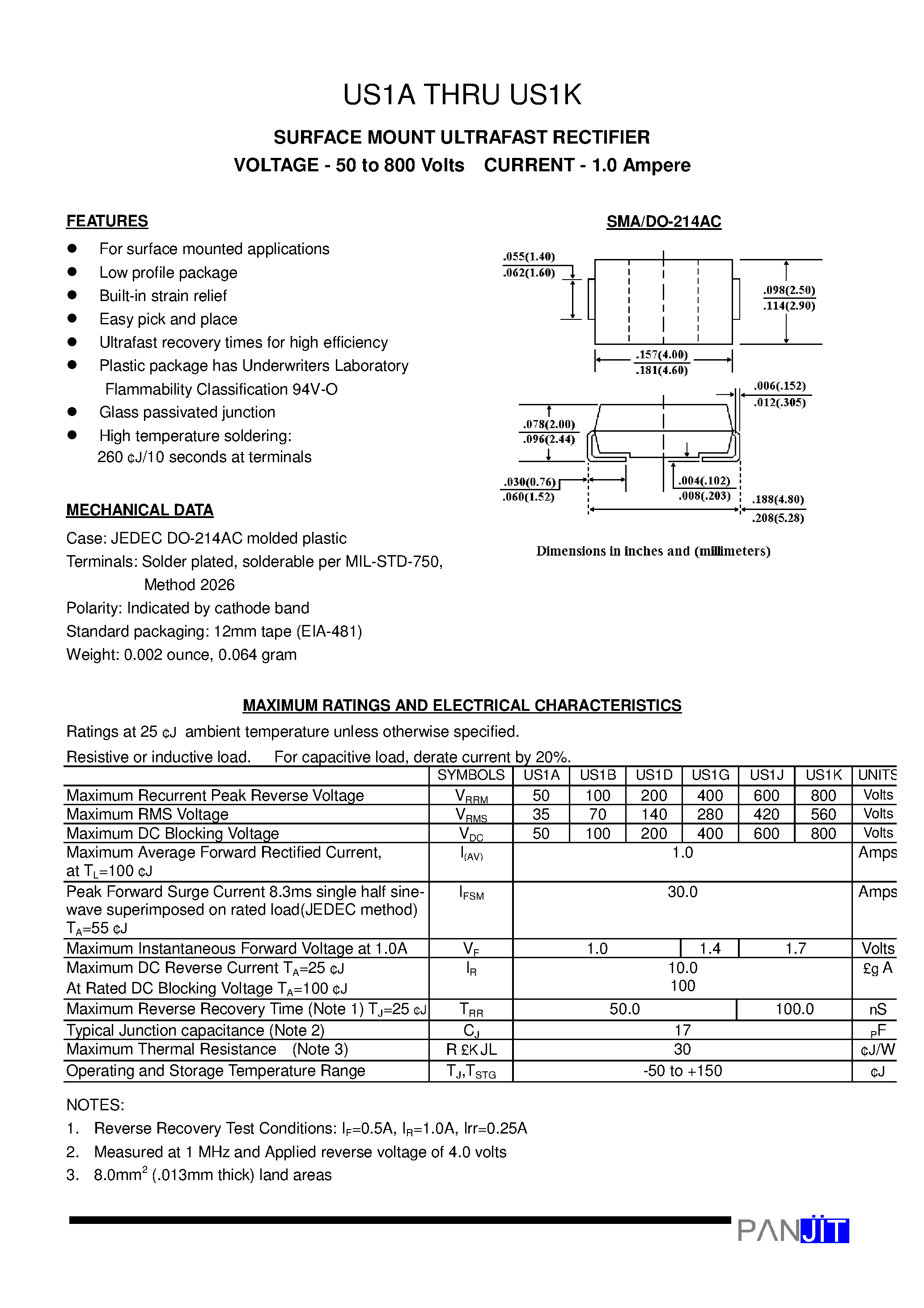

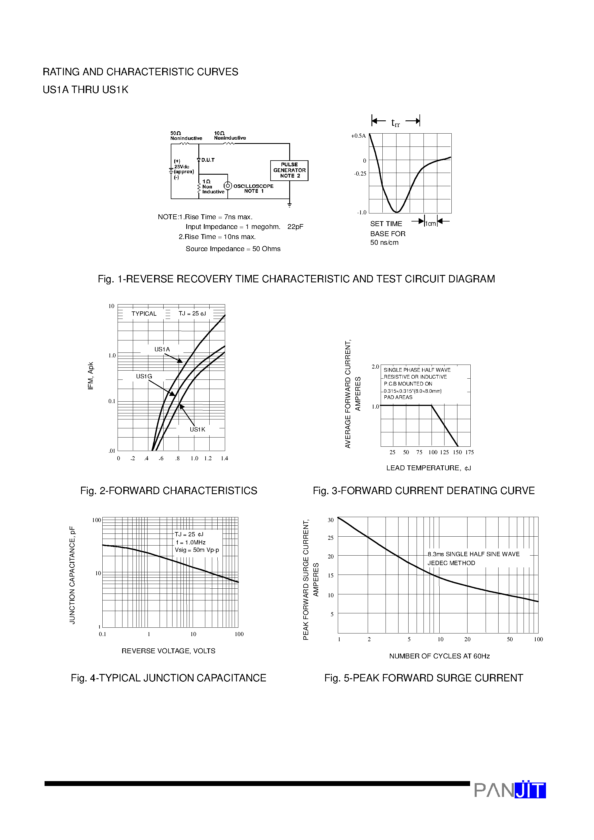

US1B-SURFACE MOUNT ULTRAFAST RECTIFIER(VOLTAGE - 50 to 800 Volts CURRENT - 1.0 Ampere)
Producer:Pan Jit International Inc.
Description:SURFACE MOUNT ULTRAFAST RECTIFIER(VOLTAGE - 50 to 800 Volts CURRENT - 1.0 Ampere)
Others with the same file: US1B
Datasheet US1B - SURFACE MOUNT ULTRAFAST RECTIFIER(VOLTAGE - 50 to 800 Volts CURRENT - 1.0 Ampere) page 1
Datasheet US1B - SURFACE MOUNT ULTRAFAST RECTIFIER(VOLTAGE - 50 to 800 Volts CURRENT - 1.0 Ampere) page 2
