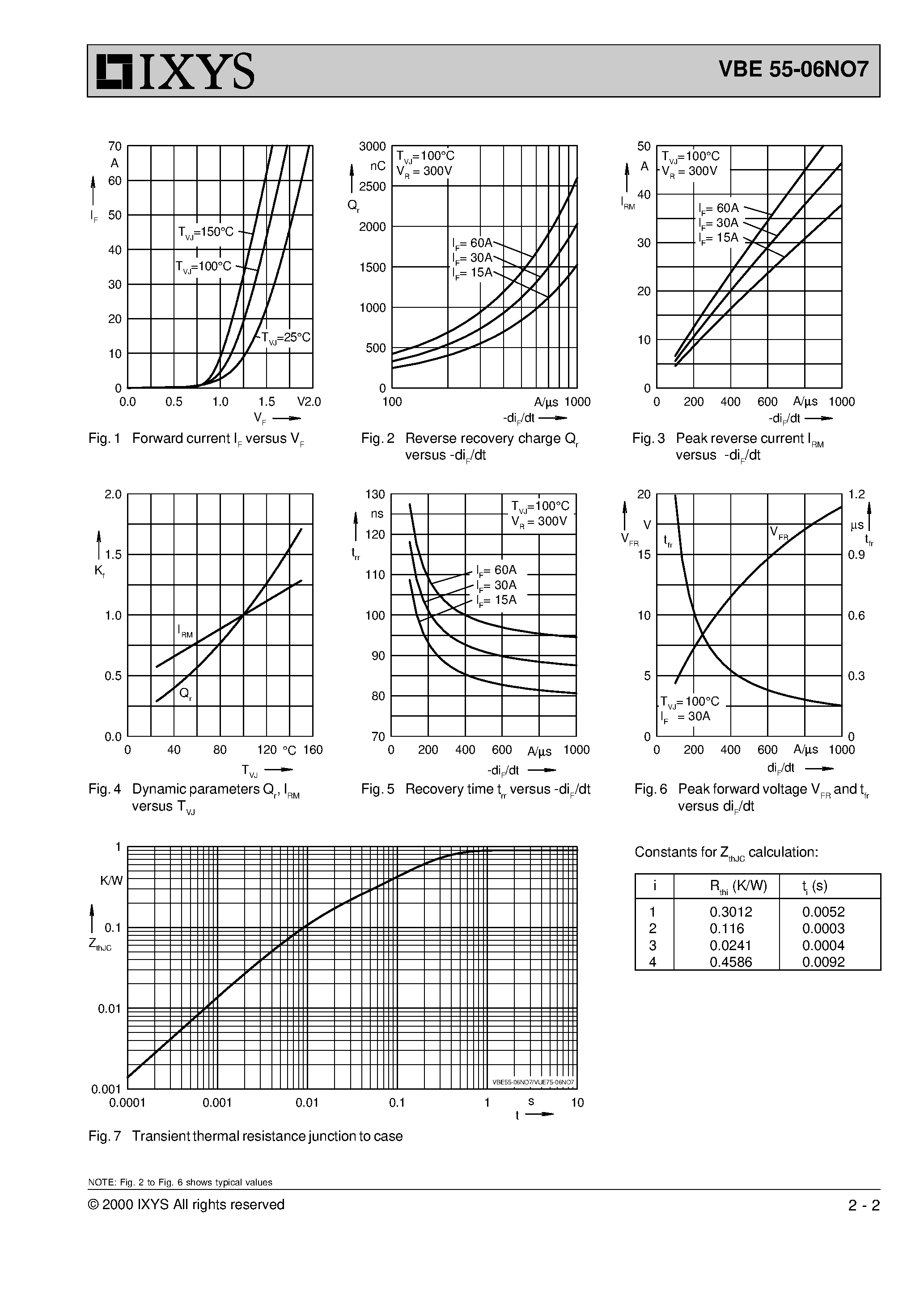

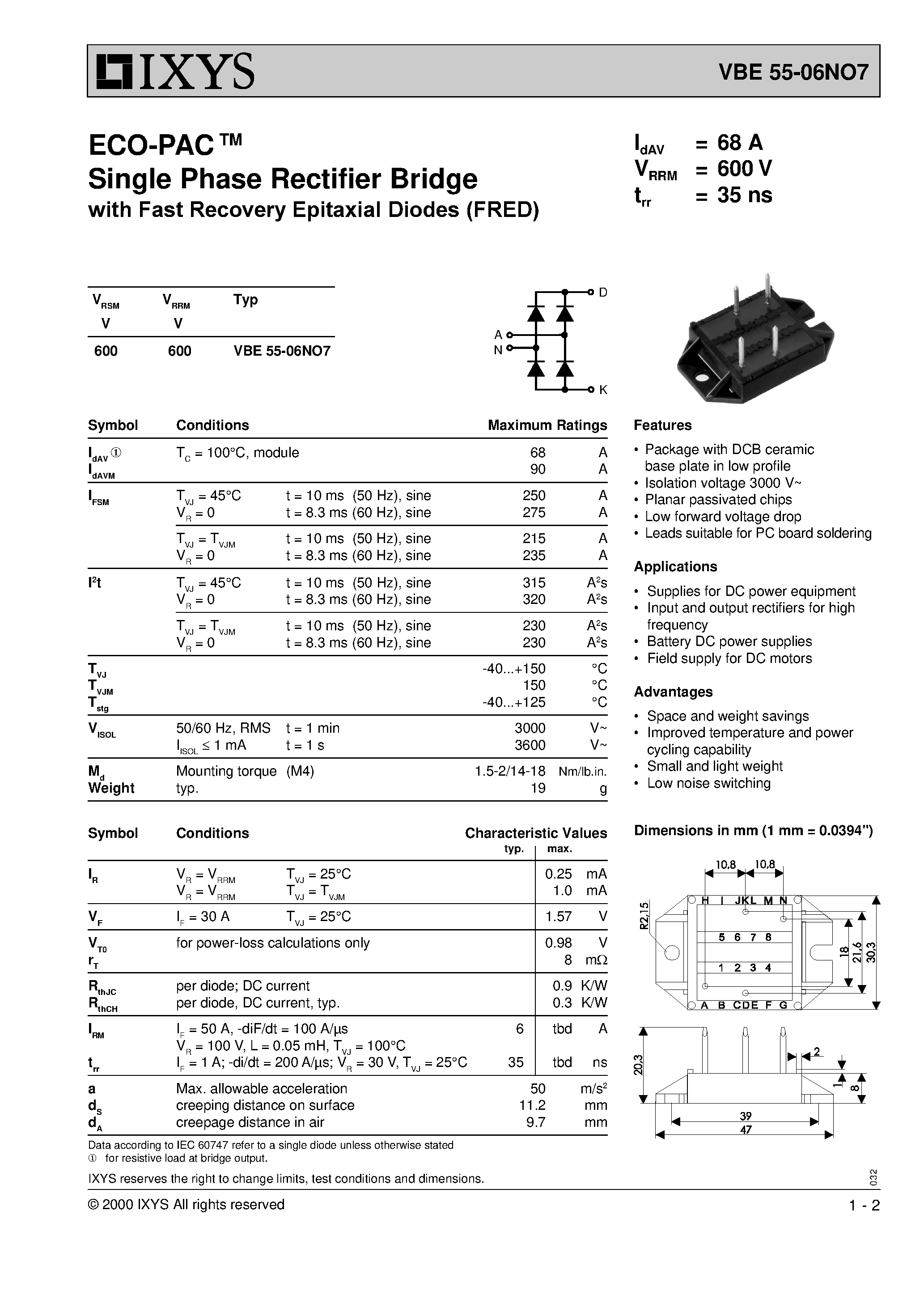

VBE55-06NO7-ECO-PAC Single Phase Rectifier Bridge WITH FAST RECOVERY EPITAXIAL DIODES (FRED)
Producer:IXYS Corporation
Description:ECO-PAC Single Phase Rectifier Bridge WITH FAST RECOVERY EPITAXIAL DIODES (FRED)
Others with the same file: VBE55-06NO7
Datasheet VBE55-06NO7 - ECO-PAC Single Phase Rectifier Bridge WITH FAST RECOVERY EPITAXIAL DIODES (FRED) page 1
Datasheet VBE55-06NO7 - ECO-PAC Single Phase Rectifier Bridge WITH FAST RECOVERY EPITAXIAL DIODES (FRED) page 2
