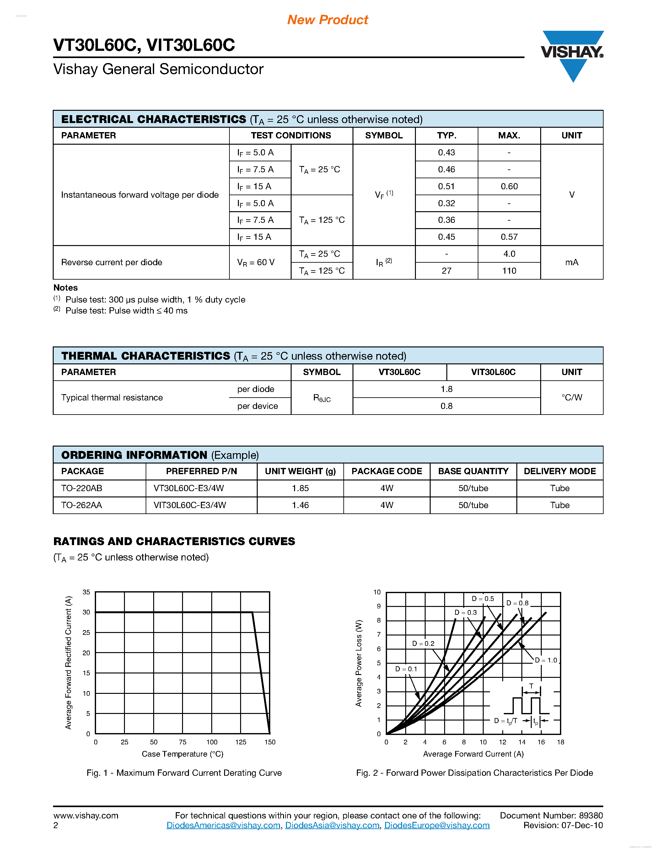

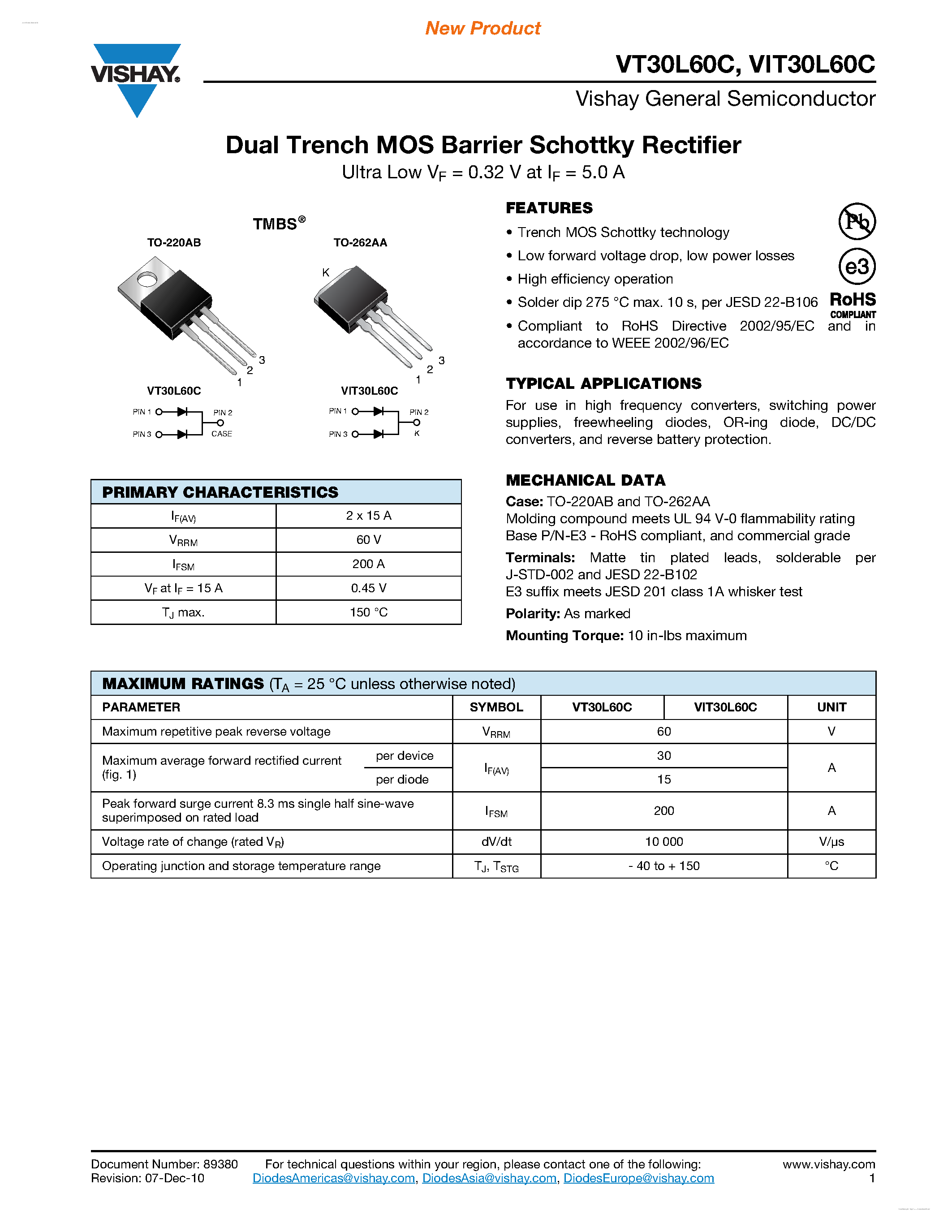

VT30L60C-Dual Trench MOS Barrier Schottky Rectifier
Producer:Vishay
Description:Dual Trench MOS Barrier Schottky Rectifier
Others with the same file: VT30L60C
Datasheet VT30L60C - Dual Trench MOS Barrier Schottky Rectifier page 1
Datasheet VT30L60C - Dual Trench MOS Barrier Schottky Rectifier page 2
