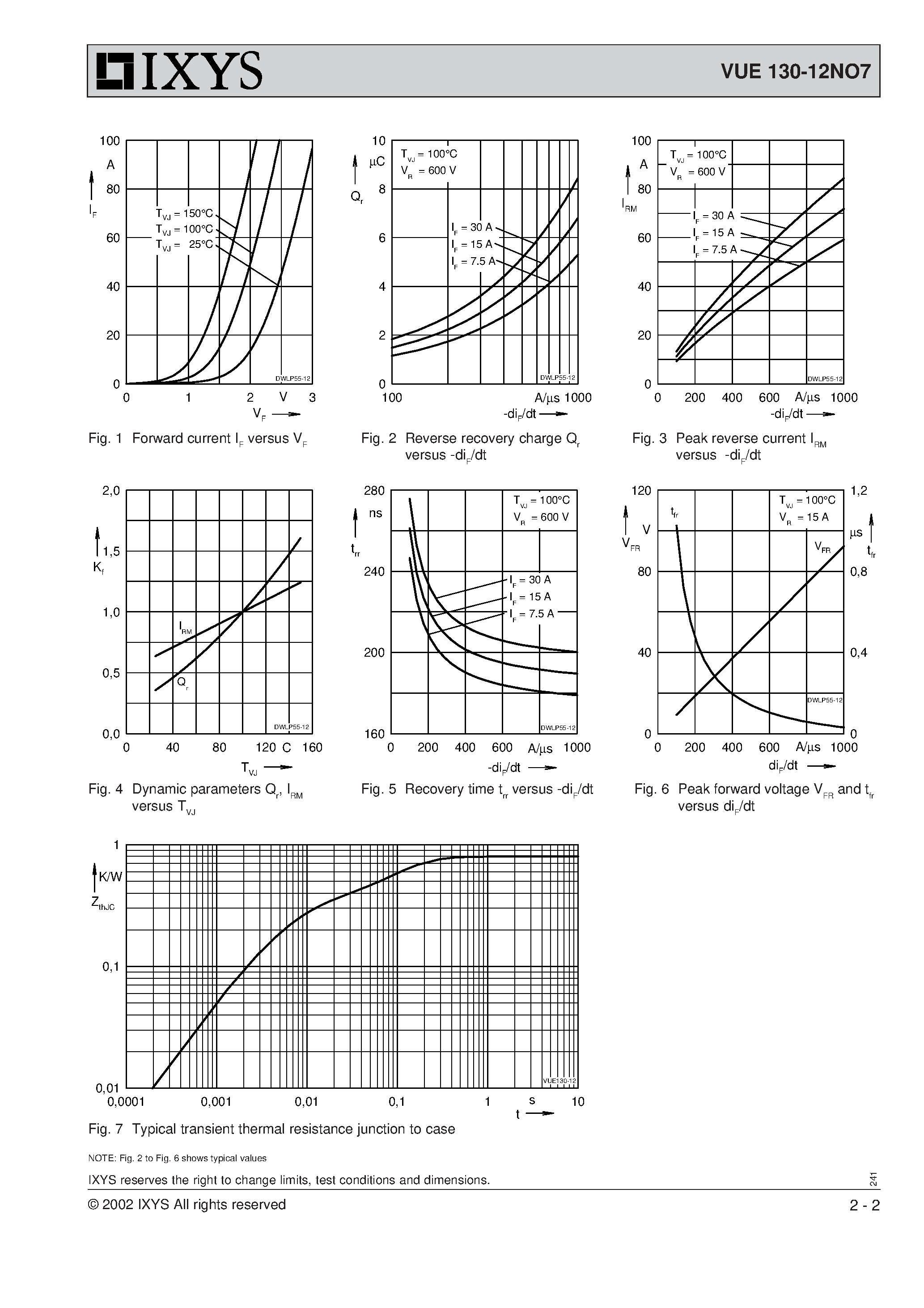

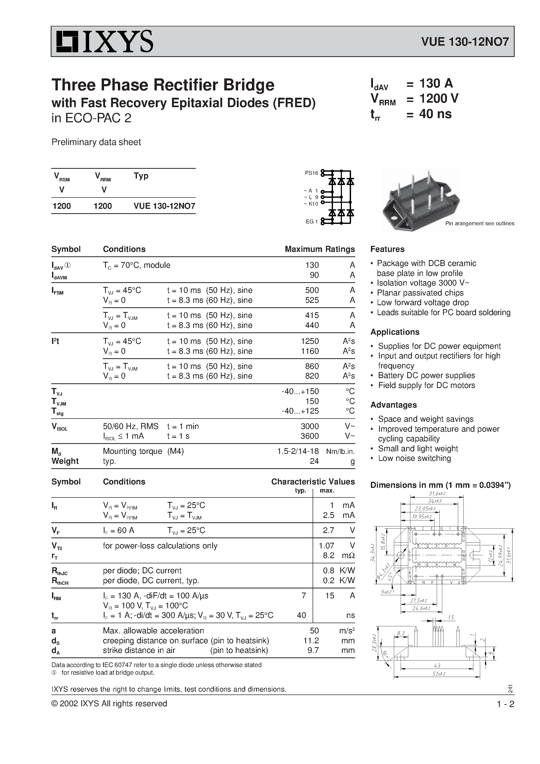

VUE130-12NO7-Three Phase Rectifier Bridge with Fast Recovery Epitaxial Diodes (FRED)
Producer:IXYS Corporation
Description:Three Phase Rectifier Bridge with Fast Recovery Epitaxial Diodes (FRED)
Others with the same file: VUE130-12NO7
Datasheet VUE130-12NO7 - Three Phase Rectifier Bridge with Fast Recovery Epitaxial Diodes (FRED) page 1
Datasheet VUE130-12NO7 - Three Phase Rectifier Bridge with Fast Recovery Epitaxial Diodes (FRED) page 2
