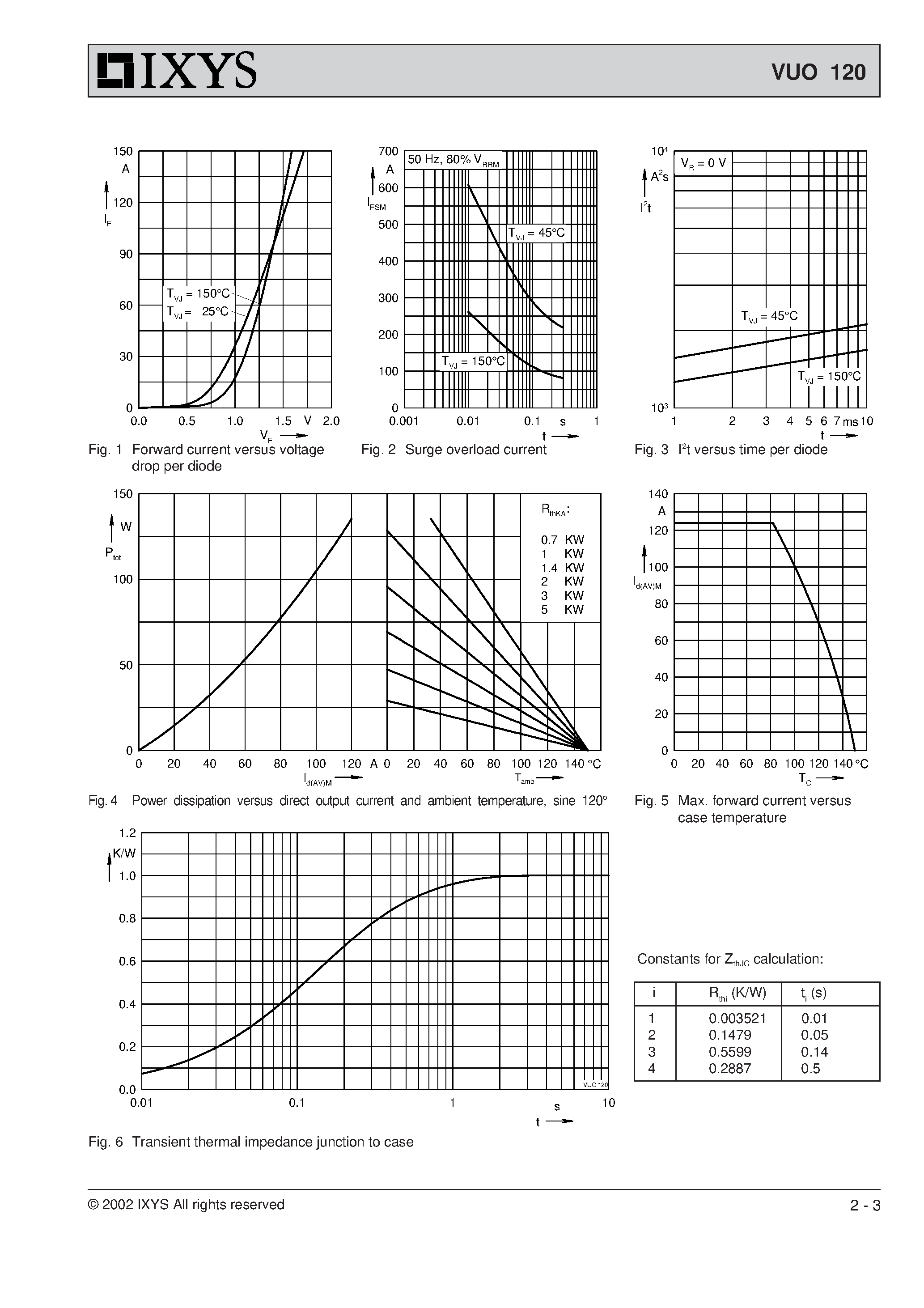

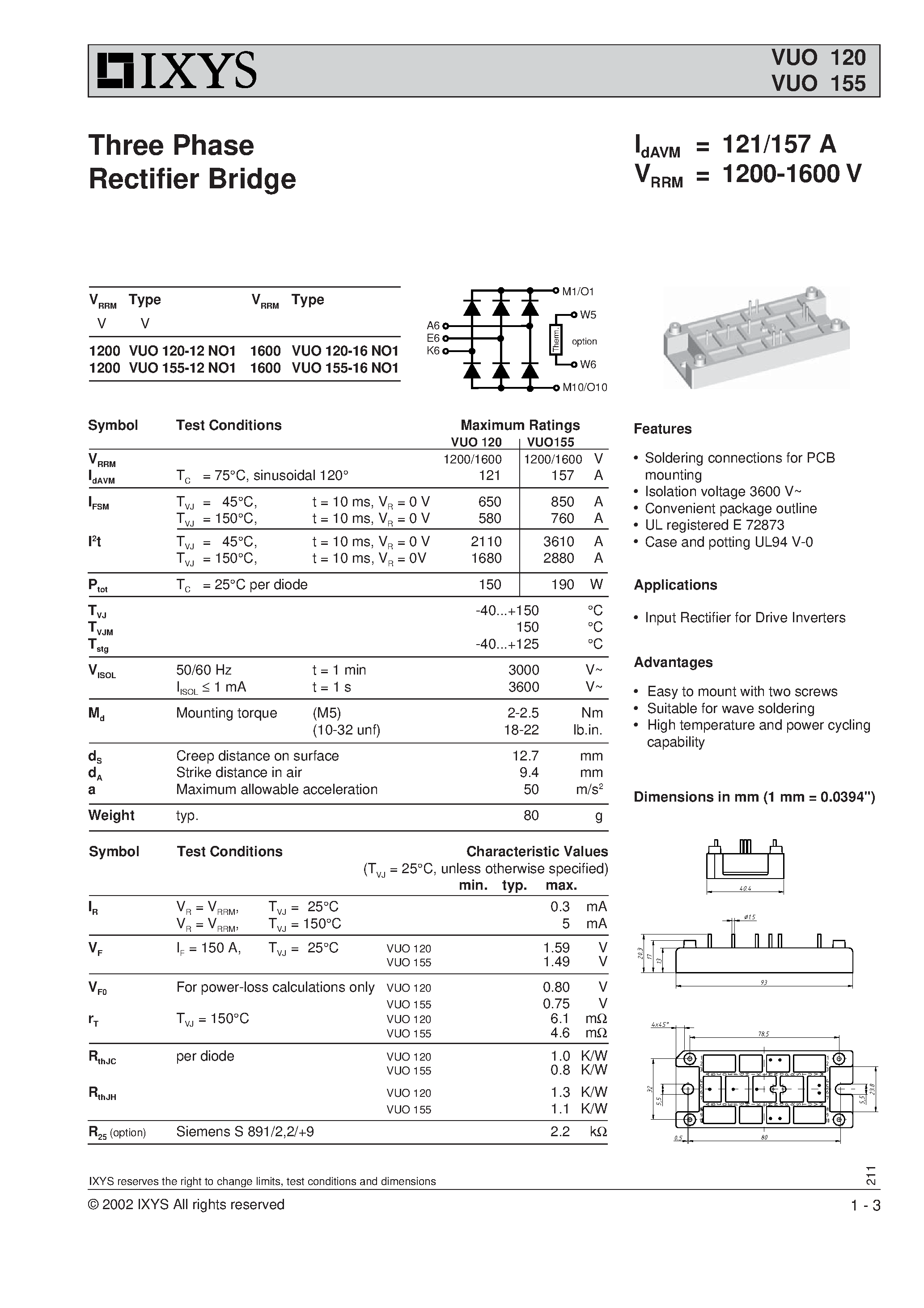

VUO120-12NO1-Three Phase Rectifier Bridge
Producer:IXYS Corporation
Description:Three Phase Rectifier Bridge
Others with the same file: VUO120-12NO1
Datasheet VUO120-12NO1 - Three Phase Rectifier Bridge page 1
Datasheet VUO120-12NO1 - Three Phase Rectifier Bridge page 2
