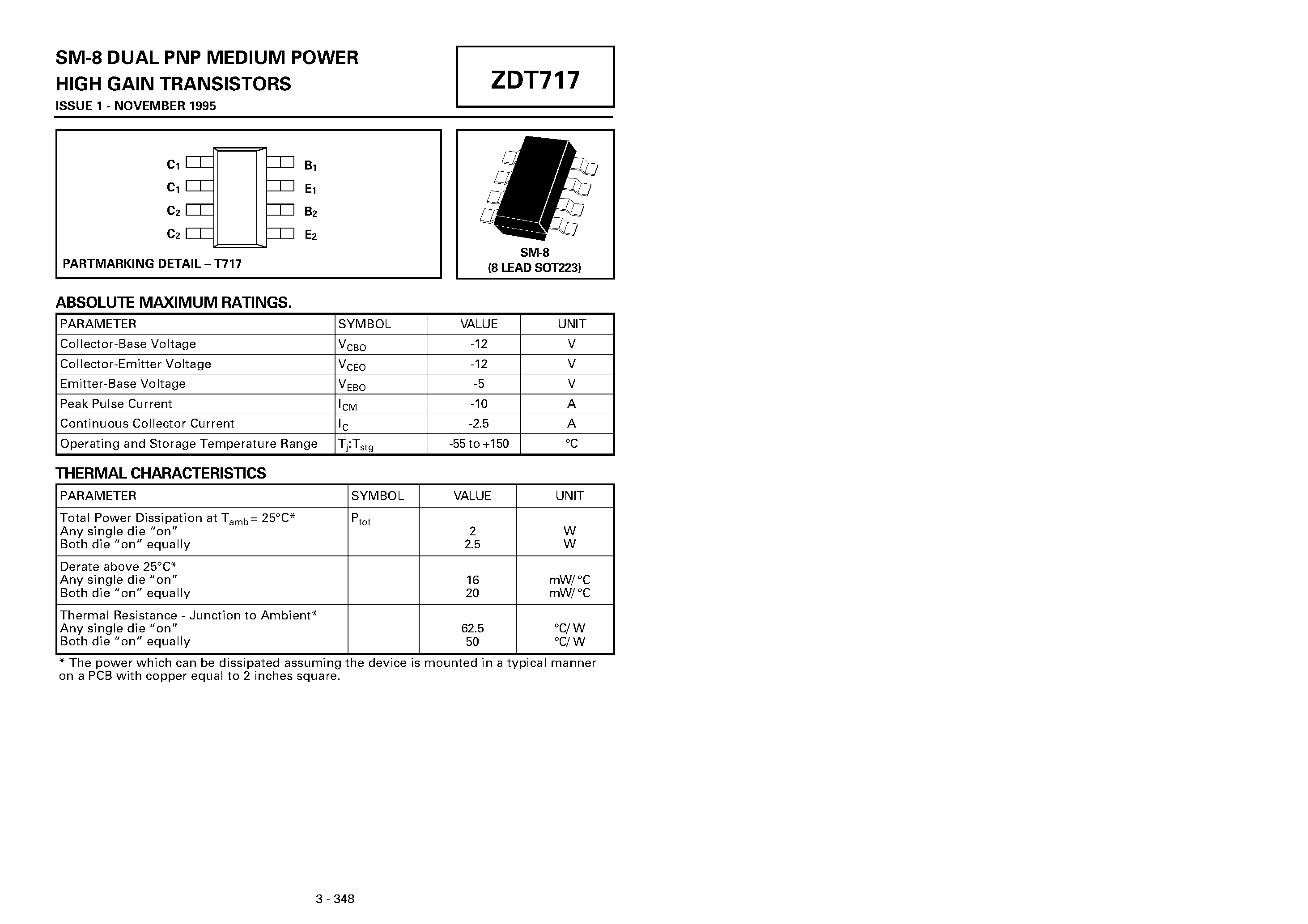

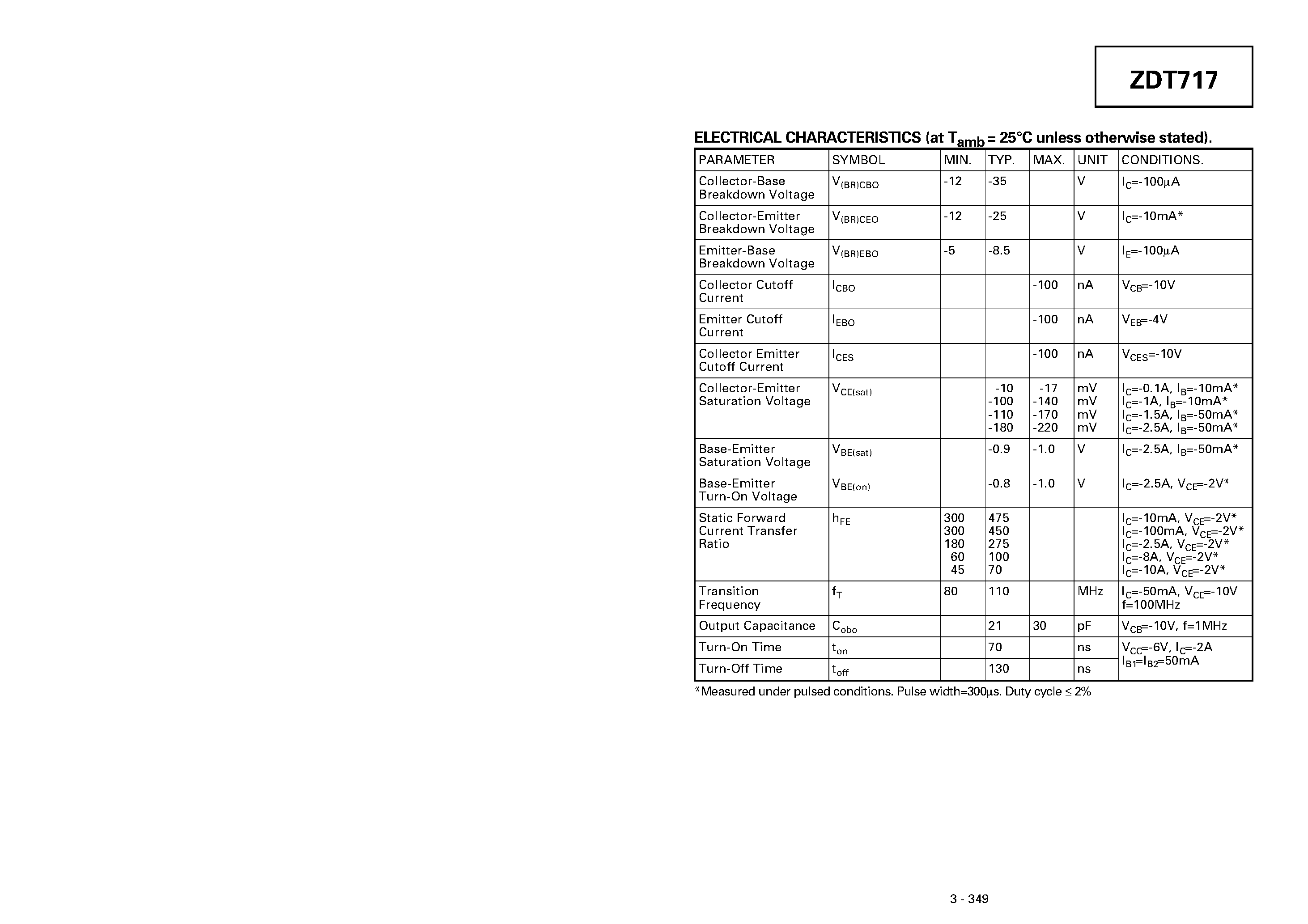

ZDT717-DUAL PNP MEDIUM POWER HIGH GAIN TRANSISTORS
Producer:Zetex Semiconductors
Description:DUAL PNP MEDIUM POWER HIGH GAIN TRANSISTORS
Others with the same file: ZDT717
Datasheet ZDT717 - DUAL PNP MEDIUM POWER HIGH GAIN TRANSISTORS page 1
Datasheet ZDT717 - DUAL PNP MEDIUM POWER HIGH GAIN TRANSISTORS page 2
