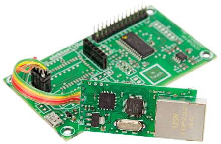

Connecting to the Android I/O board
There is no single connector on the Android I/O board that exactly matches the one on the USR-TCP232-T module. However, all connectors do have the links we need: the supply voltage (3.3 V and GND) and the serial data (TX and RX). The USR-TCP232-T module also has a configuration pin. This is only required when we want to configure the module via the serial port. Since we're going to configure the module via the Ethernet network, this pin isn't really required.
As we saw earlier, we can use any of the connectors on the board. The author decided to use the connector for the ESP8266 (MOD4). There are two ways in which to make the connector: via a ribbon cable or using a (double-sided) experimenter's board with the connectors for the USR-TCP232-T module and the MOD4-connector mounted on it. Figure 1 shows the wiring diagram. Note that the two pins either side of the Ethernet connector on the USR-TCP232-T module are not electrically connected to any of the parts on the module; they are there to provide mechanical stability to the module.
The wiring diagram for the two connectors on the cable linking the USR-TCP232-T module to the Android I/O board
Figure 1. The wiring diagram for the two connectors on the cable linking the USR-TCP232-T module to the Android I/O board

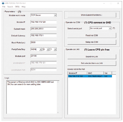

To set up the USR-TCP232-T, we can download a Windows program from the manufacturer's website [3]. This program sends a special UDP packet containing all parameters to the module in order to change its settings [2].
Below is a comprehensive set of instructions on how to set up the USR-TCP232-T (also see Figure 2). But first you must determine which addresses you can use in your network and what its subnet mask is. On a Windows PC you type the command 'ipconfig' in a 'DOS box' (this is opened by typing 'cmd' from the start menu). You will then see the IP address of the PC and the subnet mask. Choose a higher address within the subnet; as an example, when the subnet mask is 255.255.255.0 you could use .240 as the last number for the IP address. This address won't be in use, unless you have hundreds of devices connected in your subnet. Once the router has spotted that this address is in use, it won't allocate this address to other devices. The DHCP server in the router can also be configured so that it won't dynamically allocate all addresses. The author has configured his router so that the DHCP server will only allocate addresses from .10 to .100. The other addresses can then be statically configured in the peripheral devices.
Screen dump of the ‘USR-TCP232-T24 V5.1.0.1.exe’ program, with the settings shown that are used to configure the module
Figure 2. Screen dump of the ‘USR-TCP232-T24 V5.1.0.1.exe’ program, with the settings shown that are used to configure the module
You can use any port number you like. 'Logical' choices are '23' (the port for Telnet), '2000' (the port used by default by the RN-171) or '20108' (the default port of the USR-TCP232-T module).
In the following example the subnet mask is '255.255.255.0' and the module gets the IP address of 192.168.178.120 with a port at 20108. The gateway (router) has the address 192.168.178.1. The MAC address is different for every module, so the MAC address used here is just an example. Follow these steps:

  • Start the configuration program on the PC (USR-TCP232-T24 V5.1.0.1.exe).
  • Click on 'Search in LAN'. The program will then find the module on the network.
  • The module will appear in the 'Device list in the net'. Select the module by clicking on it.
  • Select the following settings:
    • - Module work mode: TCP server
    • - Module IP: 192.168.178.120
    • - Subnet mask: 255.255.255.0
    • - Default gateway: 192.168.178.1
    • - Baud Rate (bps): 9600
    • - Parity/Data/Stop: NONE, 8, 1
    • - Module port: 20108
    • - 'Destination IP' and 'Destination port' are grey and can't be filled in.
  • Click on 'Set selected item via LAN'
  • The following then appears in the Logs: "The param of Device which MAC is 00C18B5C42E1 set OK, You can search for new setting later."
The module is now ready for use.

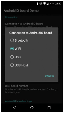

To get the app on an Android phone to connect to the USR-TCP232-T module, we have to select WiFi (in the 'Android I/O board Demo' app, for example) for the setting in 'Connection to Android I/O board' (Figure 3). For the 'WiFi address' and 'WiFi port' you should type in the IP address and the port number of the USR-TCP232-T module. In this case, 'WiFi' should be considered to be 'IP network'.
In de demo-app ‘Android IO board Demo’ you have to select Wi-Fi for the setting ‘Connection to Android I/O board’. In this case it really means ‘IP network’
Figure 3. In de demo-app ‘Android IO board Demo’ you have to select Wi-Fi for the setting ‘Connection to Android I/O board’. In this case it

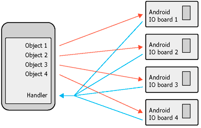

Controlling several Android I/O boards simultaneously

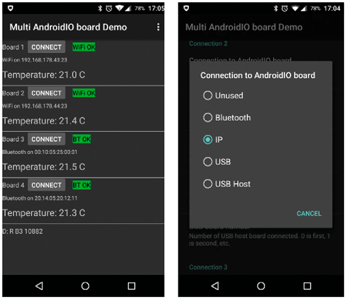

It is possible to control several Android I/O boards from a single app. This can also include a mix of different communications methods: IP (Wi-Fi and Ethernet), Bluetooth and USB (see Figure 4). There isn't really a limit to the number of Android I/O boards you could control! With IP networks in particular, it's possible to have the Android I/O boards very far apart from each other. Despite this, they can still be controlled and interrogated by a single app.
In the ‘Multi AndroidIO board Demo’ you can see that four different boards are connected, where the temperature of each one is shown. For each board you can select a different connection method.
Figure 4. In the ‘Multi AndroidIO board Demo’ you can see that four different boards are connected, where the temperature of each one is shown. For each board you can select a different connection method.
All the data sent back by the Android I/O is processed by a single handler
Figure 5. All the data sent back by the Android I/O is processed by a single handler
When multiple Android I/O boards are controlled, a separate object from the IOFunction class has to be created for each board. We can also create an array of objects, if that is easier in your code. For example:
IOBoardFunctions[]   IOBoard = new IOBoardFunctions[4];
for (int i=0; i<4; i++)   { IOBoard[i] = new IOBoardFunctions(); }
The choice of object determines which Android I/O board will be used for the initializing of the Android I/O board, making a connection or the transmission of data. For example:
IOBoard[2].initiate(2, hnd, “192.168.178.120”, 23, 1, this);
This ensures that the object IOBoard[2] will be linked to the Android I/O board with the specified IP address and port number. The data sent back from all the different Android I/O boards can be processed by a single handler. The first parameter passed with the .initiate (in this example it is '2'), acts as a channel number. It is included with all data in the '.arg1' field of the Message object [4]. This way the app will know exactly from which Android I/O board the data comes from. The figure below shows this graphically.
There is an accompanying demo app (including source code) with this article, which simultaneously reads the temperature sensors of four Android I/O boards. From the menu you can select the communications method for each of the Android I/O boards independently. The app then reads the temperature sensors once per second.
In the source code you can see exactly how multiple Android I/O boards can be controlled. This code and the apk file can be downloaded from [5].
