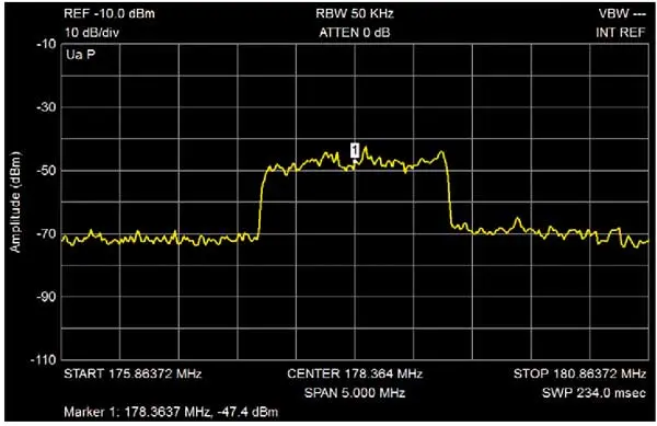

If you wish to use an off-the-shelf antenna, you must first establish whether it will receive signals at all in the DAB+ region; this is because some active antennas have a built-in lowpass filter. The simplest way to find out is to connect it to a spectrum analyzer (Figure 1), otherwise test it with a DAB+ receiver. As is well known, the VHF (FM) band covers from 88 to 108 MHz, whilst DAB in Band III goes from 174 up to 230 MHz. L-Band in the region of 1.5 GHz (used for DAB in some territories) is irrelevant for broadcast reception in vehicles.
Image of the DAB+ spectrum at 178 MHz, Channel 5c
Figure 1. Image of the DAB+ spectrum at 178 MHz, Channel 5c.

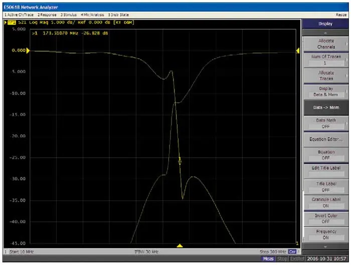

If you connect both filters in parallel using a T-adapter, there is a strong mutual influence on the frequency response (Figure 3). After this I experimented further dividing the signal with a resistive power splitter and additional 6 dB attenuators after the power splitter. Although the mutual influence is reduced, it's still not elegant. And there is additional attenuation of 3 or 6 dB. The low-pass filter also shows a falling frequency response. This is not an optimal solution then.
Both filters are connected in parallel here by T-adapter. This creates a strong mutual influence on the frequency response
Figure 3. Both filters are connected in parallel here by T-adapter. This creates a strong mutual influence on the frequency response.

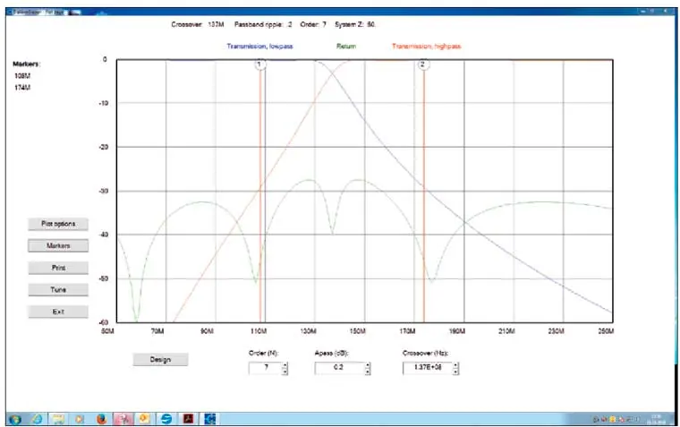

Both filters are matched to each other in such a way that they can (and must) be driven in parallel by the source. For calculation there is the 'Diplexer Design' software by James L. Tonne [1]. This program allows you to select between lowpass/highpass and bandpass/bandstop variants. The following description covers only the lowpass/highpass version.
On the Design page of this program (Figure 4) you can define the characteristics of the diplexer. The 'Order' is a measurement of the complexity, and hence outlay (the number of components), and the abruptness of the filtering achievable. 'Crossover freq' indicates the point of intersection of the two filters. In this VHF/DAB+ example it is roughly in the middle between the highest VHF frequency (108 MHz) and the lowest DAB+ frequency (174 MHz). The crossover frequency can be fine-tuned to the extent to make the attenuation of the unwanted band in each filter more or less equal. You can also attempt to replace 'awkward' (i.e. not made commercially) coil values calculated with readily available ones.
Design page of the Diplexer Design program
Figure 4. Design page of the Diplexer Design program.
The lowpass in the upper section begins always with a series inductance. When calculating an individual filter you can select whether you want to start with the series inductance (T-struc-ture) or a shunt capacitor (Pi-structure). Here this is not an option. Correspondingly the highpass always begins with a series capacitor.
'Passband ripple' indicates the amplitude of the periodic variation in the passband region, as in a Chebyshev filter. The greater the ripple, the sharper the filter and vice versa. 'System Z' indicates the impedance, in our example 50 ohms. When you press the 'Plot' button, you reach the next screen-grab (Figure 5).
Plot page of the Diplexer Design program
Figure 5. Plot page of the Diplexer Design program.
You can change the order, ripple and crossover frequency again at this stage and observe the effects directly. You can set the presentation style using 'Plot Options' and at 'Markers' superimpose markers.

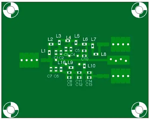

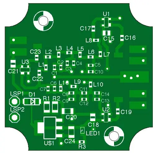

Following this work, I developed a PCB using EAGLE. Awkward coil and capacitor values were handled using available values wired in parallel and series. It is possible to connect capacitors in parallel and install them side by side without any problems. Connecting coils in series is another matter. The two magnetic fields can interact, creating a transformer (albeit a very bad one), and the effective inductance value is not the desired sum of the two values. Accordingly the coils were offset by 90 degrees and, as far as the SMD layout would permit, separated from one another by distance.
The maximum order is 7. By omitting the capacitors and coils (substituting wire links) you can, however, also achieve every deeper order. The coils are available in 0603 packages.

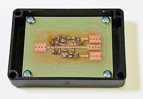

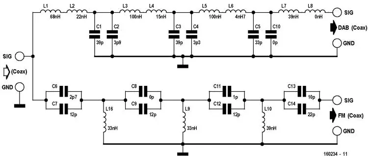

The schematic of the practical circuit is shown in Figure 6, with the associated PCB in Figure 7. This PCB fits in a small plastic box and can be screwed in place (Figure 8). The input and output cables are soldered direct to the PCB. On its upper side there is an area of groundplane between the two filters; the underside is entirely groundplane.
Schematic of the passive frequency splitter for FM/DAB+
Figure 6. Schematic of the passive frequency splitter for FM/DAB+.
EAGLE layout for the circuit in Figure 6
Figure 7. EAGLE layout for the circuit in Figure 6.
Prototype of the diplexer in its plastic housing
Figure 8. Prototype of the diplexer in its plastic housing.

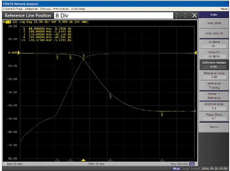

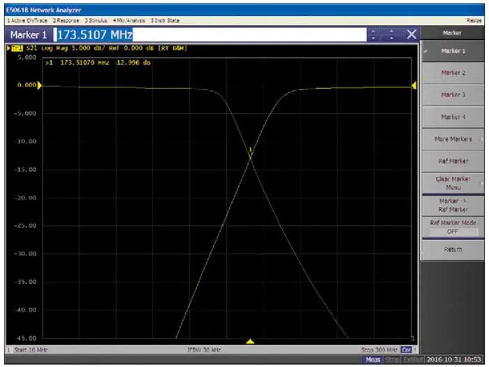

The resulting measurements in Figure 9 corroborate this design within the scope of the component tolerances. At approximately 45 dB attenuation the lowpass goes into 'saturation'. Although definitely undesirable, that's not functionally significant.
Frequency curve of the diplexer with markers
Figure 9. Frequency curve of the diplexer with markers.

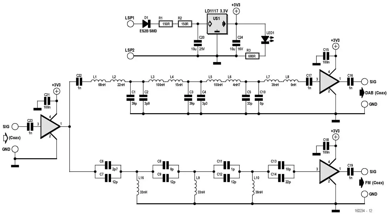

Active version
As the transmit power of DAB+ transmitters is rather modest in comparison with analog VHF stations, I searched for an appropriate preamplifier and struck rich with the MAX2630 from Maxim.
As shown in the datasheet [2], it comes in a 4-pin SAT143 package. The only extra circuitry, besides the bypass capacitor for the supply voltage, is one capacitor each at the input and output. Since it fits perfectly on a scrap of perfboard, no PCB had to be developed for testing. Its gain is around 15 dB and the noise figure is 4. The measured frequency response runs in an almost straight line up to 250 MHz (and evidently carries on much further).
Encouraged by these results I developed an active diplexer: see Figure 10. The input and the two outputs are each fitted with a MAX2630.
Schematic of the active diplexer
Figure 10. Schematic of the active diplexer.
The amplifier on the input probably makes sense only if a passive antenna is installed in the car. With the higher level from an active antenna, this could be too much of a good thing. You can then you can bridge the input and output of the amplifier with a wire link or an SMD zero-ohm resistor. The same applies on the FM output if the receiver is being overdriven. However, the amplifier on the DAB+ output probably does make sense in most cases.
PCB layout for the active diplexer
Figure 11. PCB layout for the active diplexer.
The power is supplied by a 3.3-V voltage regulator, with each amplifier drawing about 7 mA. The series diode at the input prevents damage from incorrect polarity; the two resistors should reduce the thermal power dissipated by the regulator. The 12 V can be tapped off the car radio at the output provided for powering an active antenna. The PCB of the active diplexer (Figure 11) fits in a diecast aluminum box from Hammond (type 1550WQ).

  • Stig Hansen/19.06.2020 - 11:13
    Hi Alfred. -Lovely article you have made :-) -BUT, I'm a little confused... -should the top of the schematic(low pass filter) not be connected to the FM , and the bottom of the schematic (high pass filter) not be connected to DAB ? -MFG. Stig Hansen, Dänemark.
