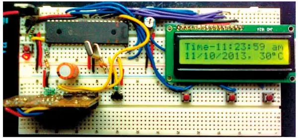

Presented here is a simple realtime clock with temperature logger. The project shows time, date and real-time temperature on the LCD. The logger records the maximum and minimum temperature for each day and can keep entries for 51 days. The recorded temperatures can be viewed any time together with the dates. The temperature is sensed via single-wire temperature sensor and the maximum and minimum temperatures for each day are stored in EEPROM via I2C protocol. Fig. 1 shows the author's prototype.
Author’s prototype
Fig. 1: Author’s prototype
