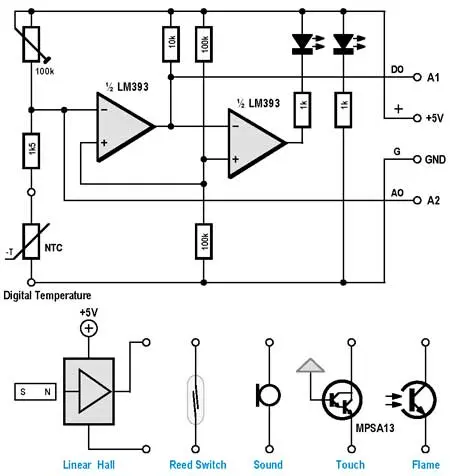

When we examine the circuit of the board in Figure 1 more closely, its function becomes clear. Once more we find the actual sensor in a voltage divider that this time is preset with a 25-turn precision trimmer pot. A second voltage divider made up from two 100 kΩ resistors provides a reference voltage of 2.5 V for the comparator. The temperature sensor (Digital Temp) can now be adjusted so that the sensor voltage at the desired temperature will likewise be exactly 2.5 V. A rising temperature at the NTC sensor makes the comparator switch on the digital output DO, whilst a falling temperature switches it off. The second comparator connected downstream operates only the status LED. Thanks to these LEDs we can test all seven sensors without any need for software.
Sensors with comparators
Figure 1. Sensors with comparators.
The circuit does not include a bypass capacitor (see inset), meaning that any variations or spikes on the supply voltage may affect the operation. The length of the wiring and other random factors can also have some influence. In actual fact with the temperature sensor and the heat rising, we find a narrow region in which the output oscillates, which is possibly caused by parasitic capacitance on the PCB. If we fit a small capacitor between the input and the second comparator output, we can see an oscillator in action. This is easy to recognize with the oscilloscope. The status LED on the sensor PCB shows it as well. When things warm up slowly, it lights up initially at half brightness (state of oscillation) and only after this does it reach full brilliance (stable condition). If the software behaves strangely, bear this point in mind.
The other sensors using this circuit behave in more or less the same way, even if the changes in the measured value are usually not so gradual. Most comparable with the NTC sensor is the phototransistor in the flame sensor. The dark housing allows the longer wavelengths to pass through preferentially, in order for flames to be detected. The Hall sensor differs in that it expects an operating voltage on its third pin. The fact that the reed switch is connected as an analog sensor may surprise you. But there are two out-of-phase outputs. When a magnet is brought closer, one output goes on and the other goes off. Sound and touch behave somewhat differently; normally they deliver a squarewave signal with rapid transitions. The two sound sensors employ one large and one small electret microphone. With the pot adjusted correctly, half waves of loud sound Figure 1. Sensors with comparators. signals appear at the output as square waves. This must be taken into account during your evaluation testing. In the same way the touch sensor generally provides a 50 Hz squarewave signal (60 Hz in North America) when activated.
The comparator circuit delivers a sharp switchover point, without any hysteresis. This means that with a slow change of temperature, a region can occur in which the output flutters a bit. In a program you can take account of this and poll the digital output only at longer intervals. Or you could use the analog output signal AO direct from the voltage divider and evaluate this, something that we'll describe in greater detail below. Unlike the analog NTC sensor already described, you will then have the advantage that a desired temperature can be set externally using the pot.

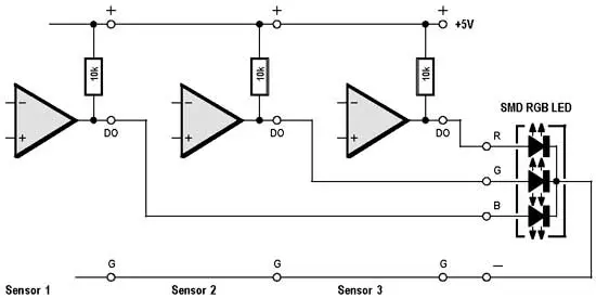

It's also interesting to note that the digital output of this board can control an actuator directly, without any assistance from a microcontroller. Output DO is connected to the input of the relay PCB. That's it - the temperature controller or thermostat is complete. Admittedly without hysteresis, which in some applications could be problematic. If you feel like connecting one of the LEDs directly to the comparator, you need to bear in mind that a comparator has an open collector output. Therefore it switches down actively, so that in the High state only the pull-up of 10 kΩ supplies current, meaning that the LED does not illuminate very brightly. Nevertheless, applications are conceivable in which three separate sensors directly drive the three colors of an RGB LED (Figure 2), not with great intensity but clearly visible nevertheless. The resulting color mixture of pink perhaps then stands for "hot and loud".
Direct connection to RGB LED
Figure 2. Direct connection to RGB LED.

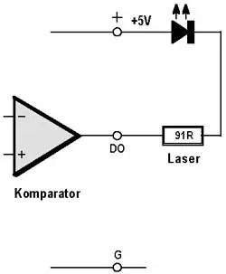

If you wish to control laser lights directly, you'll need to hook these up between DO and +5 V (Figure 3). On/Off reverses the situation, but you can now switch larger currents up to about 20 mA. With this arrangement an interesting experiment can be carried out: opto-thermal feedback. The laser is pointed precisely towards the NTC sensor (see header photograph). The switching temperature is then set exactly at the changeover point using the potentiometer. Once the correct position is found, the laser starts to flash. Here's how: when switched on, it warms the sensor slightly. The digital output switches on, which turns off the laser because of the inverted connection. This gives the sensor the chance to cool down again until the comparator flips and the sequence begins once more.
The laser on the comparator output
Figure 3. The laser on the comparator output.

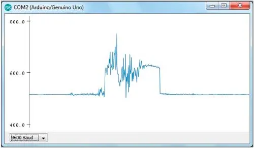

Microphone signals
Figure 4. Microphone signals.

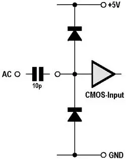

It even works without the sensor board. At input A1 we have just a piece of insulated wire connected (Figure 6). If you then touch the outside of this insulation, it still flashes! This happens because the input of the controller has extremely high impedance. The wire, insulation and finger form a small coupling capacitor of a few picofarads in value. If an AC voltage is applied to the input, it is limited to the input voltage range by the internal protection diodes. The open input does admittedly have a disadvantage compared to the correct touch sensor. The idle state is not unambiguous, you see, which makes evaluation tricky.
Input Port used as contact sensor
Figure 6. Input Port used as contact sensor.

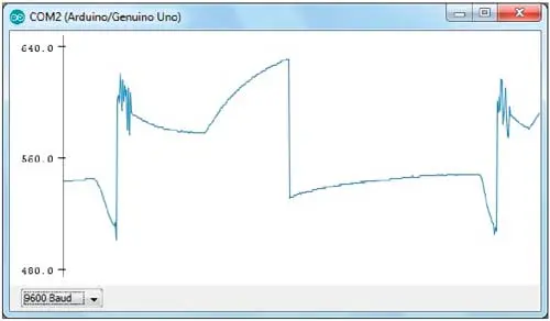

Switching using the sound sensor
Figure 7. Switching using the sound sensor.

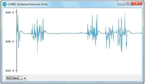

Temperature sensor in action
Figure 8. Temperature sensor in action.

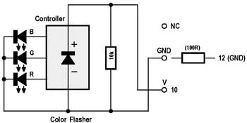

Another interesting actuator is the color-changing LED (Color Flash), in actual fact a three-color LED package with a built-in controller. This automatic LED produces a color transition between red, green and blue. This is another case requiring a dropper resistor, since color-change LEDs of this kind are in fact designed for 3 V. Incidentally, although there is indeed a resistor of 10 kΩ on the board, it is connected in parallel (Figure 9). For 5 V a dropper resistor of 100 Ω would work best. Here again, however, the compromise presented in the previous article works again: you can connect the LED between two Port pins, in order to achieve a degree of current limitation using the internal resistance of the Ports. Pin 12 (B4) is recommended for the opposite pole.
Color-changing LED
Figure 9. Color-changing LED.
Incidentally, the internal controller of the color-change LED, like most ICs, includes an inverse polarity-protection diode on its supply voltage connections and therefore reacts sulkily if you reverse the supply connections. Without the dropper resistor a reversed power connection could lead to destruction. This is vitally important: GND lies in the middle of the three connections. By the way, just for fun, you can also connect the passive mini-speaker in series. Then you can not only see the switching process but also hear it.
