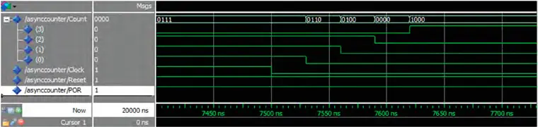

In addition to this timing uncertainty, the circuit in Fig.1 has other potential problems. Wasimonth we also looked at how the output can go through intermediate output values as changes ripple through the circuit from one flip-flop to the next (see Fig.2). Although this happens too fast for a human to detect it could cause false triggering of another circuit.

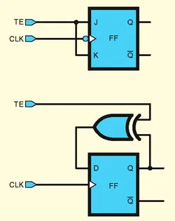

The symbol for a (negative-edge-triggered) toggle/hold flip-flop is shown in Fig.3. This is perhaps not one of the well-known classic flip-flop types (D, JK and RS) but it is an important building block in digital circuits. We can use JK flip-flops with J and K connected together, or a D-type with an XOR gate, to obtain a toggle/ hold function (see Fig.4). Other toggle/ hold flip-flops circuits are possible.

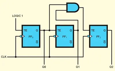

The circuit in Fig.6 is a 3-bit synchronous binary counter based on the arguments above. The first bit always toggles, so the first flip-flop has its toggle/hold wired to logic 1. The second bit (Q1) toggles if the first bit (Q0) is 1, so we connect Q0 to the Toggle Enable control of the second flip-flop. The third bit (Q2) toggles when both Q0 AND Q1 are 1, so we use an AND gate to obtain this function, connecting its output to the TE control of the third flip-flop. This circuit is synchronous because all the flip-flops are clocked together.

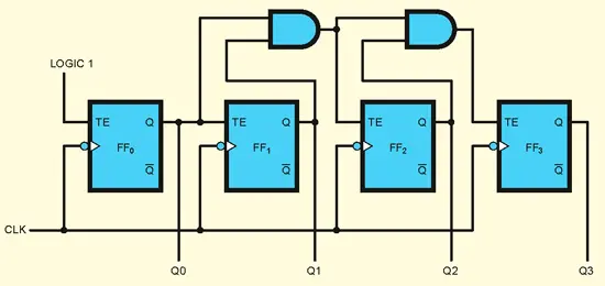

The structure of the synchronous counter follows a pattern, so it easy to extend the circuit in Fig.6 to add more bits. Fig.7 shows a 4-bit version. Adding more bits is simply a matter of including more copies of the TE flip-flop and AND gate stage for all but the last and first bits.

4-bit synchronous counter using toggle/hold flip-flops
Fig.7. 4-bit synchronous counter using toggle/hold flip-flops

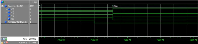

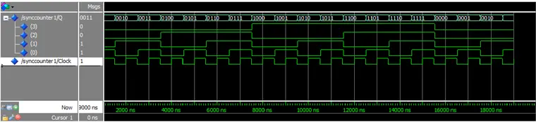

Fig.8 shows a simulation of the circuit in Fig.7. Fig.9 shows a zoom-in to the 0111 to 1000 change, a similar time point to Fig.2. Unlike the circuit in Fig.1, no intermediate output values are produced. The circuit in Fig.7 does not suffer from the output ripple effect inherent in the circuit in Fig.1. A synchronous counter with many bits will update its outputs as quickly as one with just a few bits. However, extending the asynchronous structure in Fig.1 makes the counter take progressively longer to settle its outputs.

Zoom in on the 0111 to 1000 change from Fig.7. Compare with Fig.2
Fig.9. Zoom in on the 0111 to 1000 change from Fig.7. Compare with Fig.2

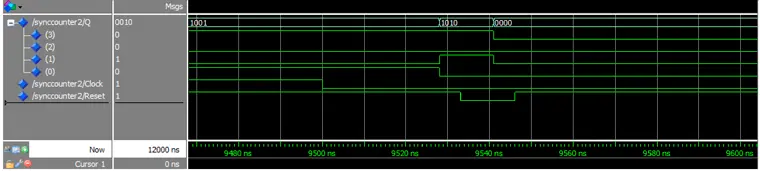

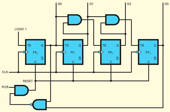

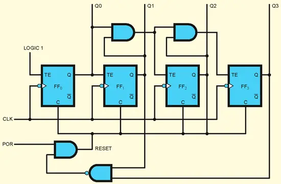

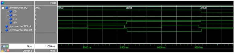

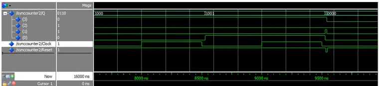

It is straightforward to make a synchronous decade counter using the same approach as Fig.1 - this circuit is shown in Fig.10. It uses toggle/ hold flip-flops with asynchronous clear inputs. The use of asynchronous resets means that the circuit is not really fully synchronous - the reset is not under the control of the clock. Fig.11 and Fig.12 show a simulation of the circuit in Fig.10 zoomed in to the point where the reset occurs. The output does not change cleanly from nine (1001) to zero (0000) because the circuit must output ten (1010) for long enough for the reset to take effect.
A 4 bit synchronous decade counter using toggle/hold flip-flops with asynchronous reset
Fig.10. A 4 bit synchronous decade counter using toggle/hold flip-flops with asynchronous reset
Fig.11. A 4 bit synchronous decade counter using toggle/hold flip-flops with asynchronous reset
A closer zoom on the reset action from Fig.11
Fig.12. A closer zoom on the reset action from Fig.11

When the fully synchronous counter reaches nine the NAND gate output goes high producing an active clear input into each of the flip-flops. However, unlike in the previous circuits, they do not reset almost immediately. The counter remains outputting value nine with the reset applied until the next active clock edge. At this point the flip-flops’ internal logic overrides the toggle/hold action and sets their stored value to 0 - the counter resets to zero shortly after the clock edge and does not temporarily output the value ten. In this circuit the reset pulse lasts for a complete clock cycle and does not have the glitchlike characteristic of the circuits in Fig.1 and Fig.10. The counter changes from nine to zero cleanly, without ever outputting ten.
