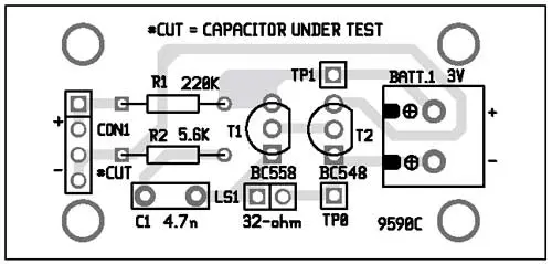

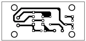

An actual-size, single-side PCB for the capacitor tester is shown in Fig. 2 and its component layout in Fig. 3.
An actual-size PCB layout for the tester circuit
Fig. 2: An actual-size PCB layout for the tester circuit
Component layout of the PCB
Fig. 3: Component layout of the PCB
Connector CON1 in the circuit is for inserting the capacitor under test. Four-pin berg strip female connector is used here to accommodate different sizes of capacitors. LSI is a small speaker used as headphone (shown in Fig. 4). Assembled PCB of the circuit can be enclosed in a matchbox as shown in Fig. 5.

After wiring, do verify that voltages are as per Test Points table.

For testing the capacitor, insert it in CON1. If the capacitor is good, a fire-siren like sound is produced. A continuous beep is produced if the capacitor is short.
