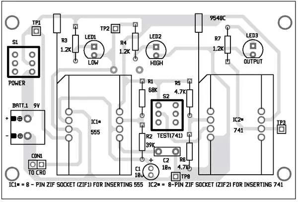

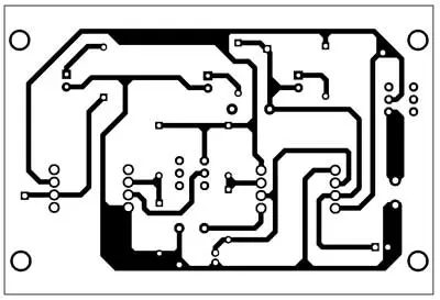

Construction and testing
An actual-size, single-side PCB for the 555 and 741 ICs testing circuit is shown in Fig. 2 and its component layout in Fig. 3. After assembling the circuit on a PCB, enclose it in a suitable plastic box. Solder two 8-pin ZIF sockets ZIF1 and ZIF2 on the PCB for 555 timer and 741 op-amp, respectively.
An actual-size PCB for the testing circuit
Fig. 2: An actual-size PCB for the testing circuit
Component layout for the PCB
Fig. 3: Component layout for the PCB
During testing, both the ICs should be inserted in their respective sockets. You can check frequency output of IC1 by connecting an oscilloscope's probes to CON1 in the PCB. In case of any problem, verify that voltages at test points are as per table.
