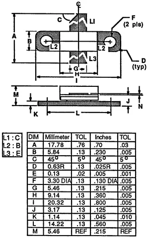

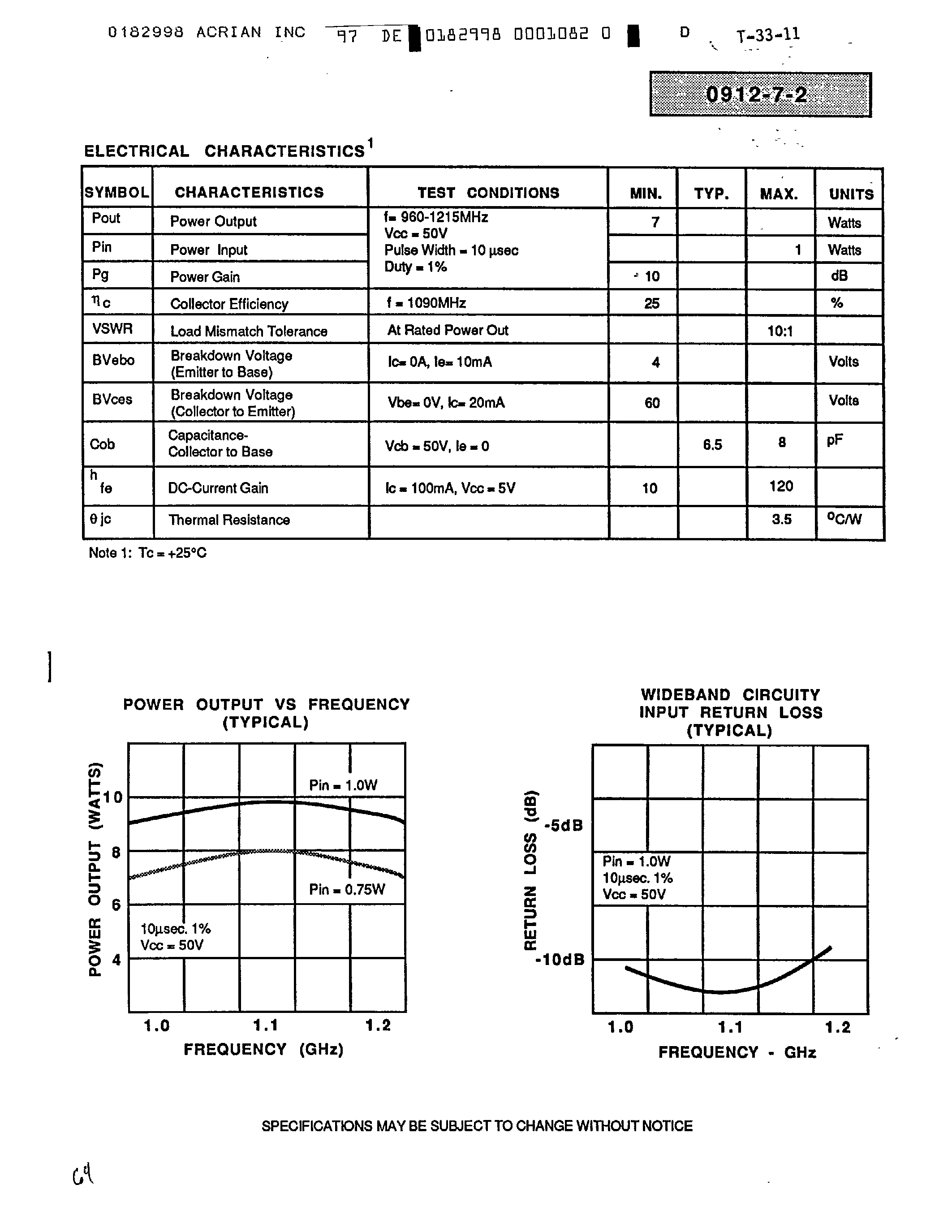

The 0912-7 is an internally matched, common base transistor providing 7 watts of pulsed RF output power across the 960-1215 MHz band. This hermetically sealed transistor is specifically designed for avionics pulsed radar applications.
ABSOLUTE MAXIMUM RATINGS
Maximum Power Dissipation @ 25ЯС Case Temperature 50 W Maximum Voltage and Current
BVces    Collector to Emitter Voltage    60    V
BVebo    Emitter to Base Voltage    4.0    V
Ic    Collector Current    1.0 A
Maximum Temperatures
Storage Temperature    -65    to +150°C
Operating JunctbnTemperature    +200    °C
