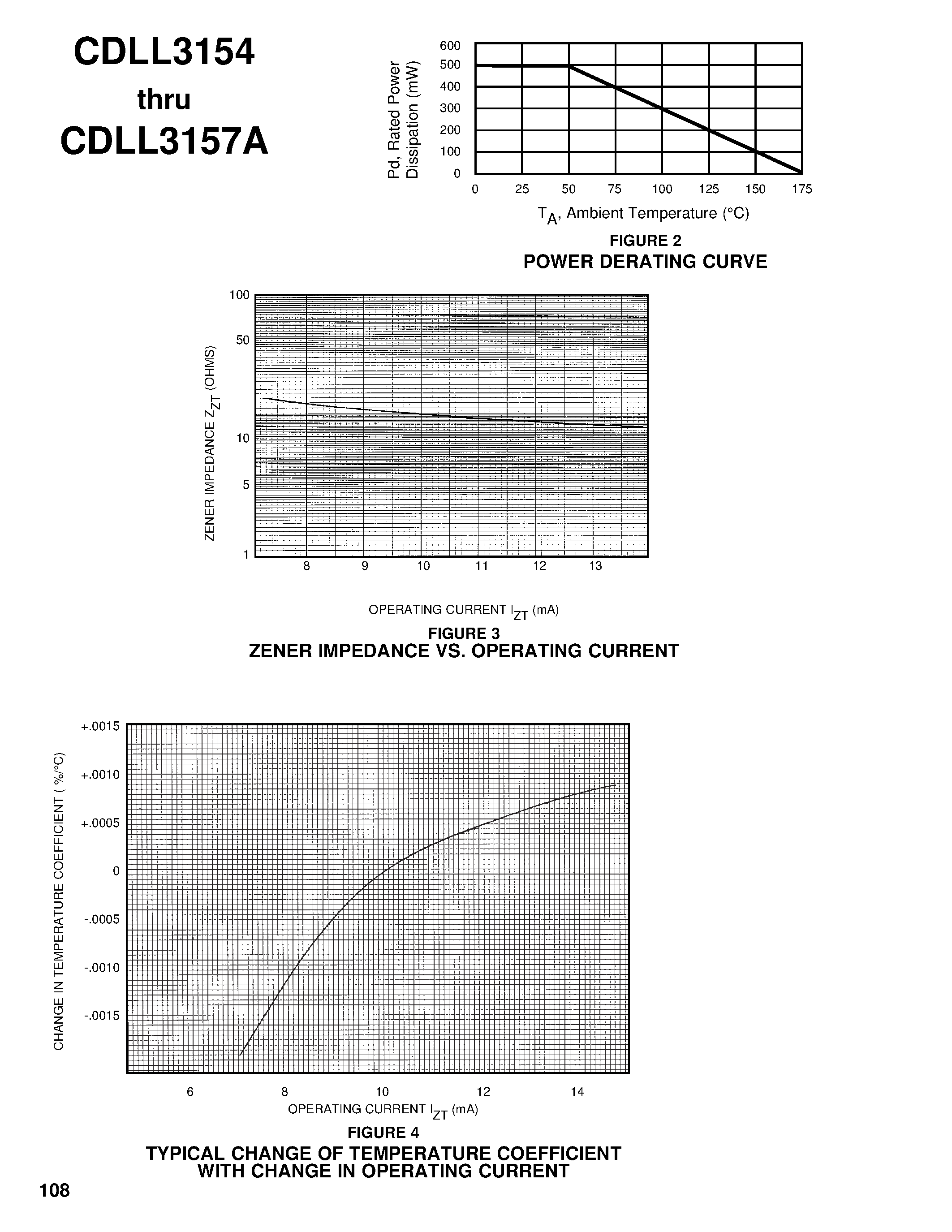

1N3154UR-1-(1N3154UR-1 - 1N3157UR-1) TEMPERATURE COMPENSATED ZENER REFERENCE DIODES
Description:(1N3154UR-1 - 1N3157UR-1) TEMPERATURE COMPENSATED ZENER REFERENCE DIODES
