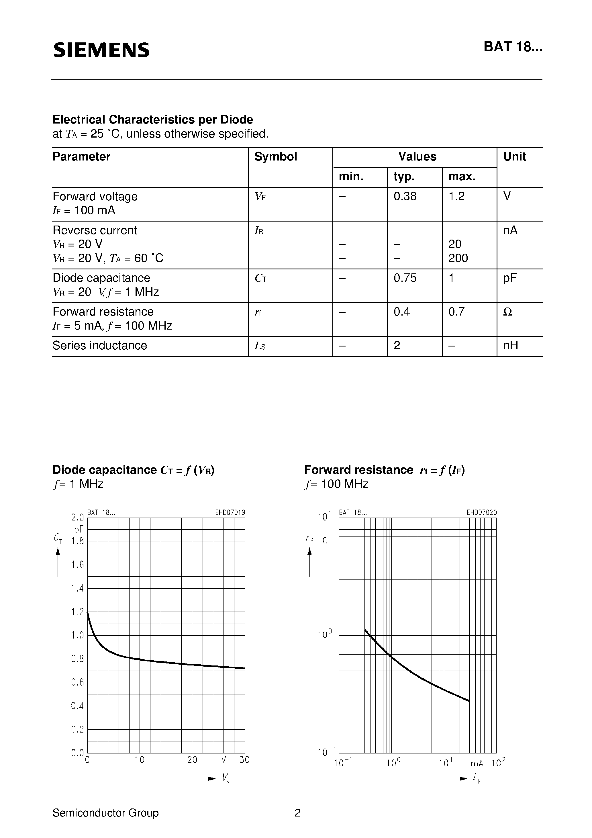

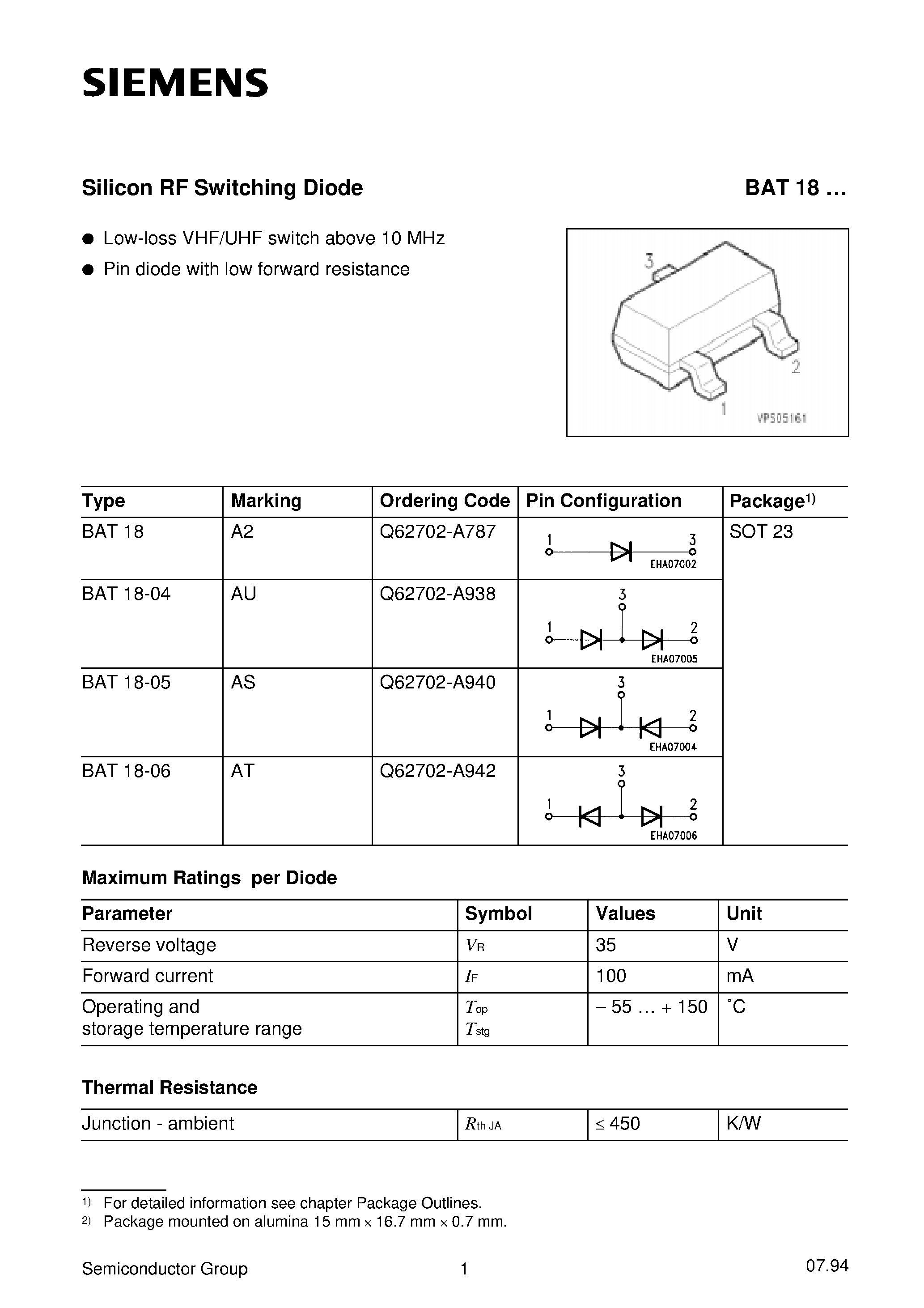

BAT18-Silicon RF Switching Diode (Low-loss VHF/UHF switch above 10 MHz Pin diode with low forward resistance)
Description:Silicon RF Switching Diode (Low-loss VHF/UHF switch above 10 MHz Pin diode with low forward resistance)
Others with the same file: BAT18
Datasheet BAT18 - Silicon RF Switching Diode (Low-loss VHF/UHF switch above 10 MHz Pin diode with low forward resistance) page 1
Datasheet BAT18 - Silicon RF Switching Diode (Low-loss VHF/UHF switch above 10 MHz Pin diode with low forward resistance) page 2
