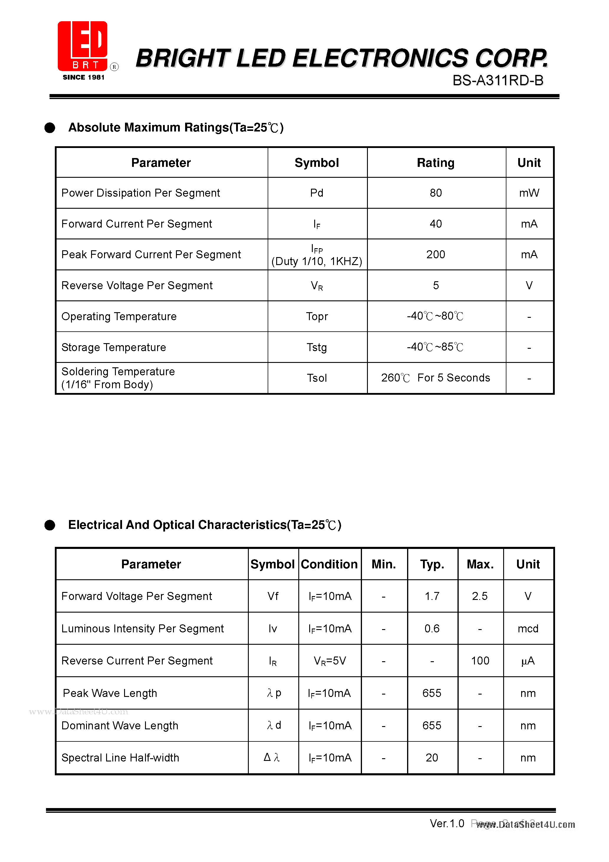

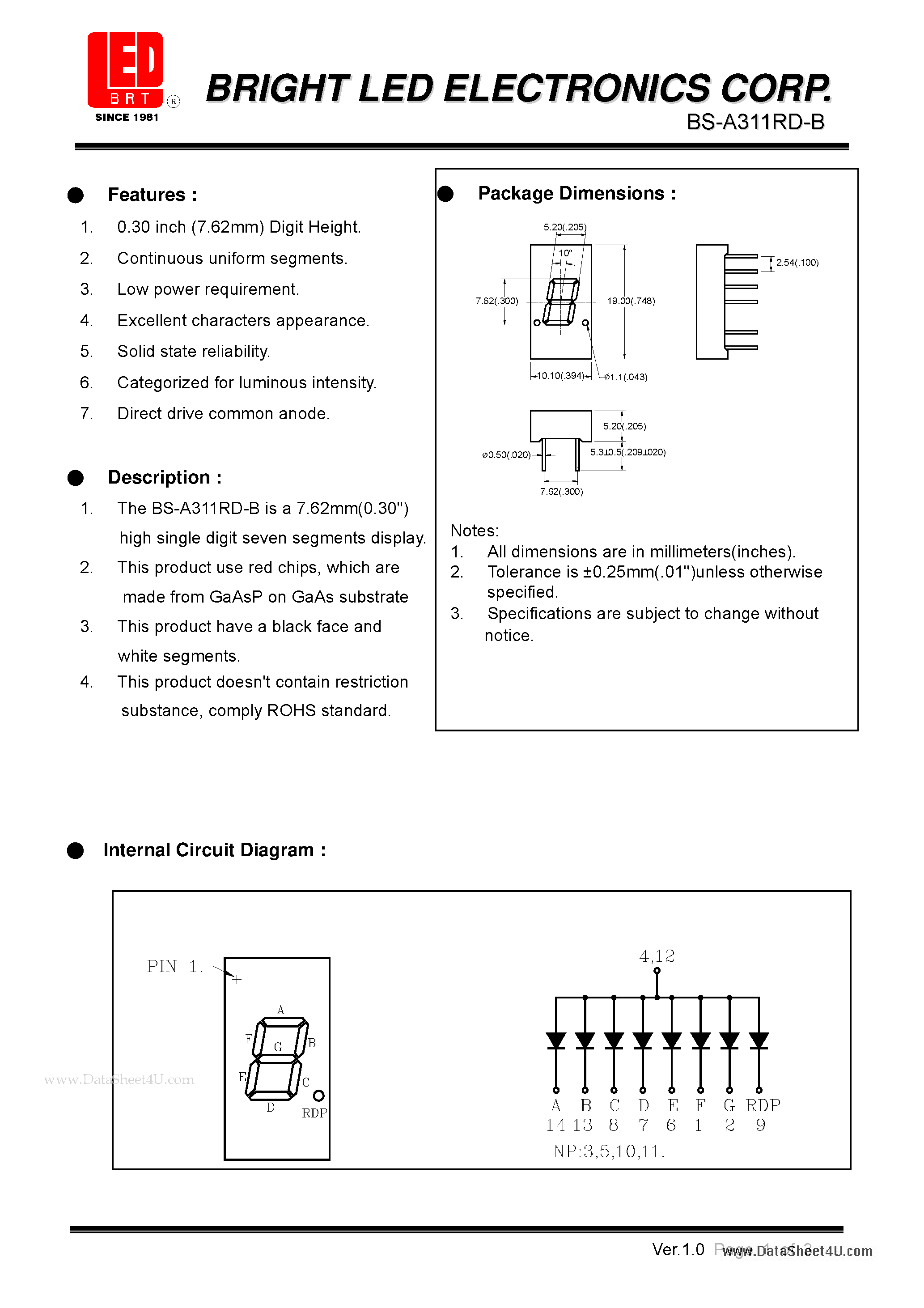

BS-A311RD-B-7.62mm (0.30) high single digit seven segments dispaly
Producer:BRIGHT LED ELECTRONICS
Description:7.62mm (0.30) high single digit seven segments dispaly
Others with the same file: BS-A311RD-B
Datasheet BS-A311RD-B - 7.62mm (0.30) high single digit seven segments dispaly page 1
Datasheet BS-A311RD-B - 7.62mm (0.30) high single digit seven segments dispaly page 2
