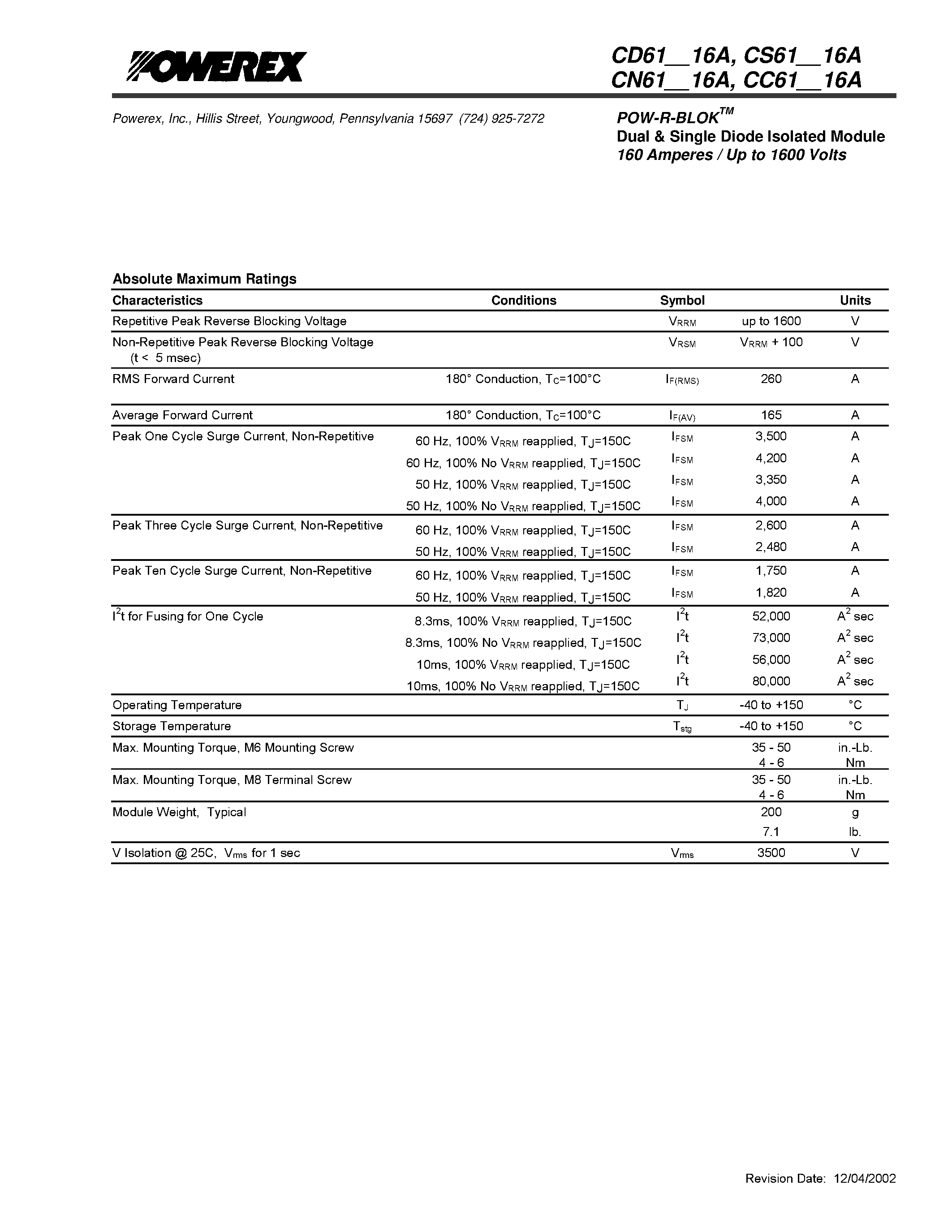

CD61-POW-R-BLOK Dual & Single Diode Isolated Module 160 Amperes / Up to 1600 Volts
Producer:Powerex Powers
Description:POW-R-BLOK Dual & Single Diode Isolated Module 160 Amperes / Up to 1600 Volts
