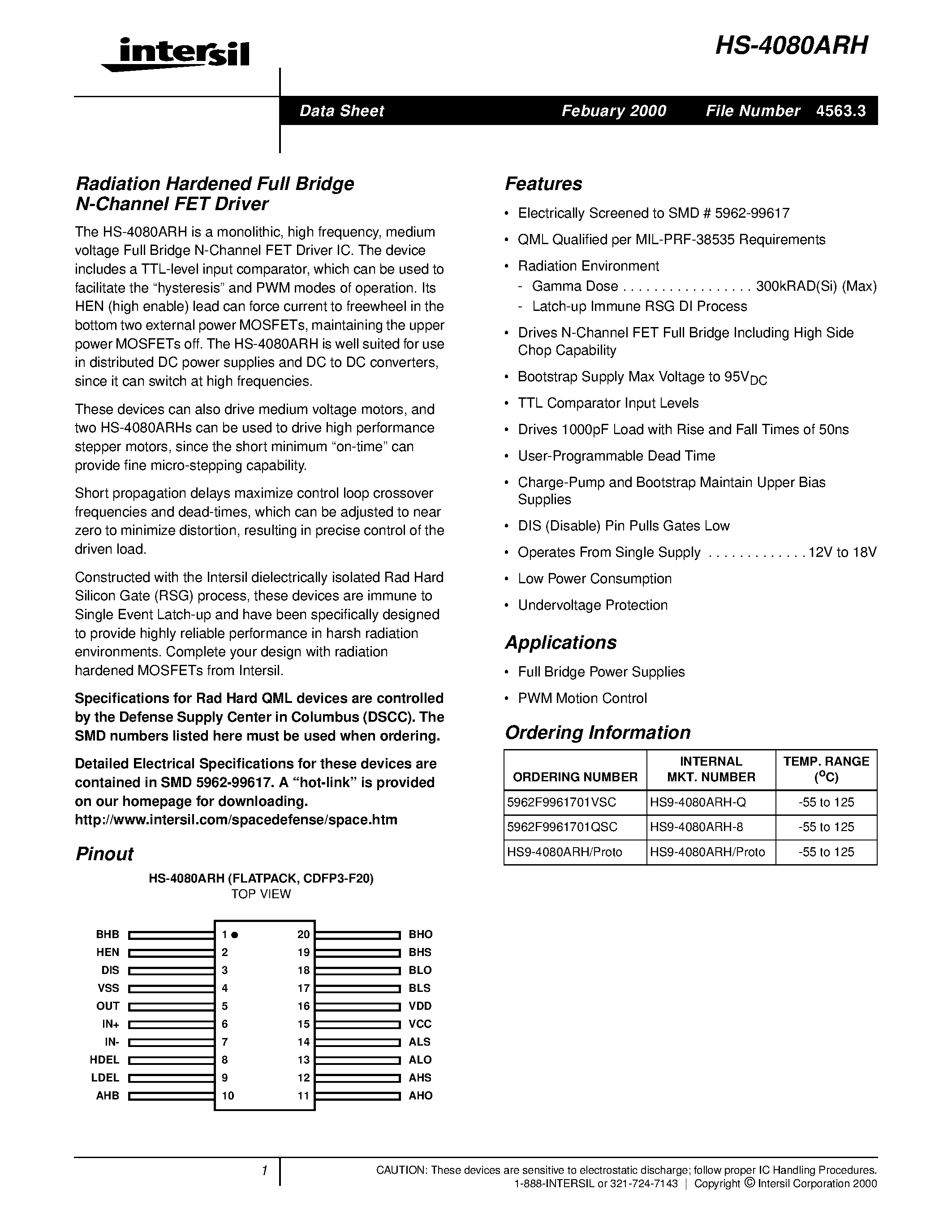

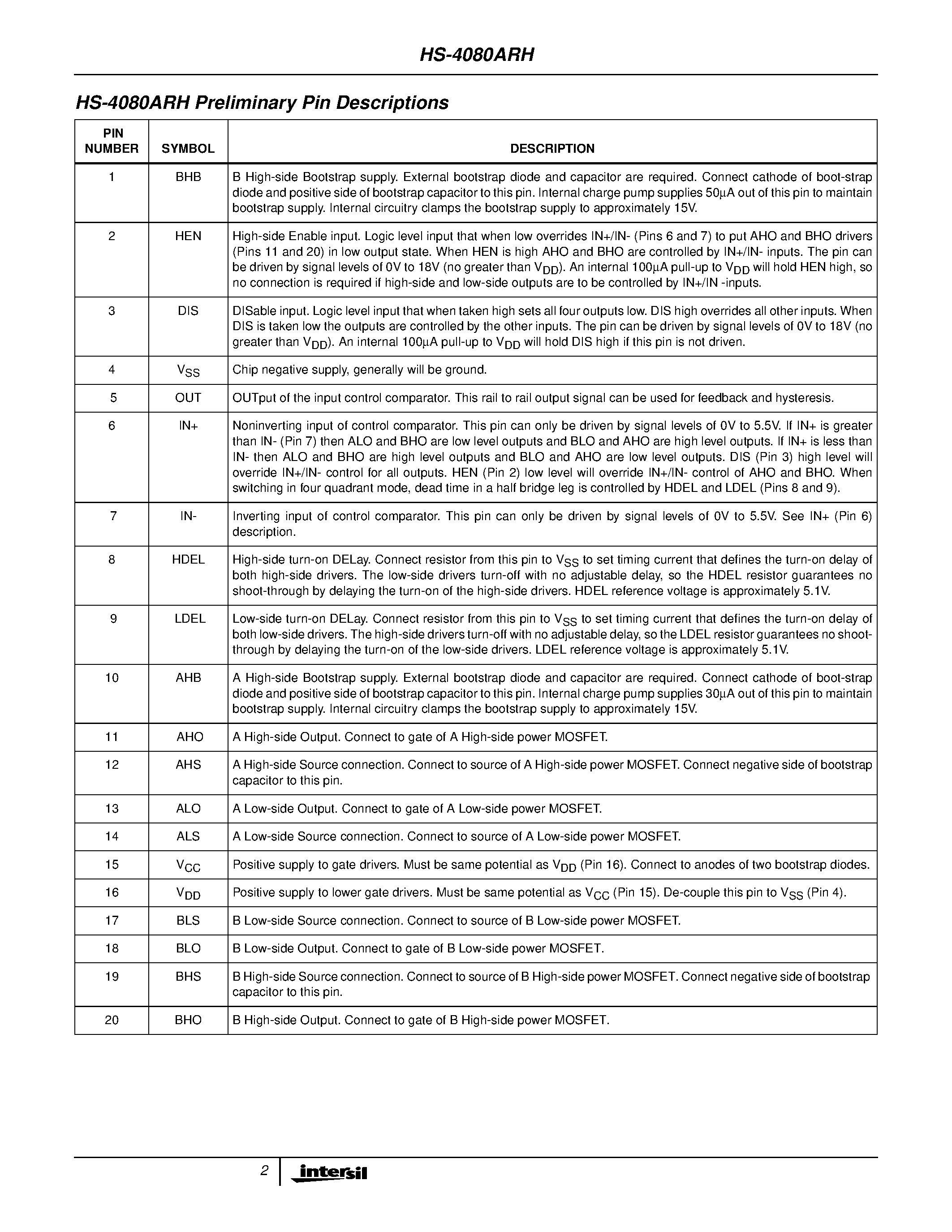

HS9-4080ARH-Q-Radiation Hardened Full Bridge N-Channel FET Driver
Producer:Intersil Corporation
Description:Radiation Hardened Full Bridge N-Channel FET Driver
