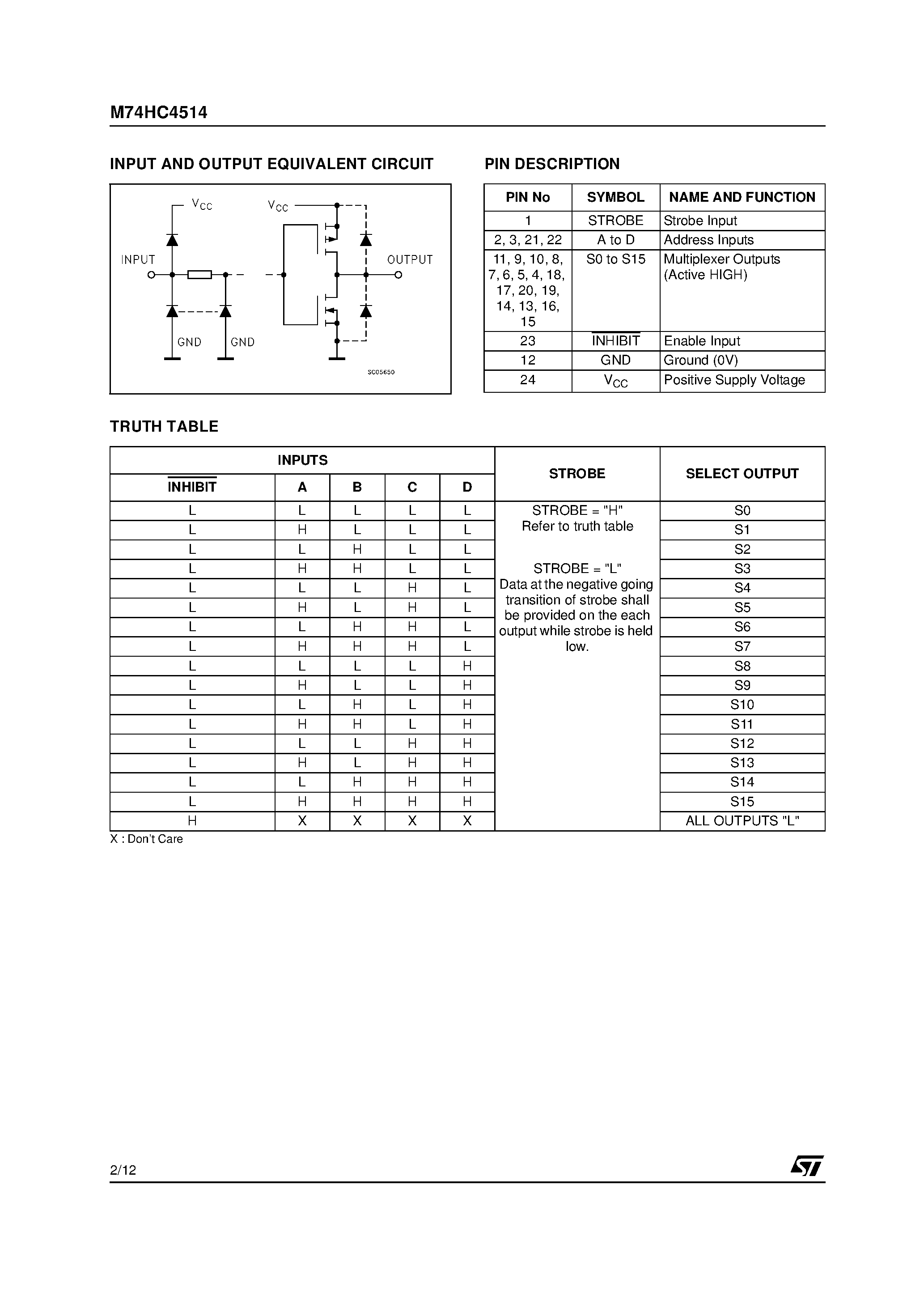

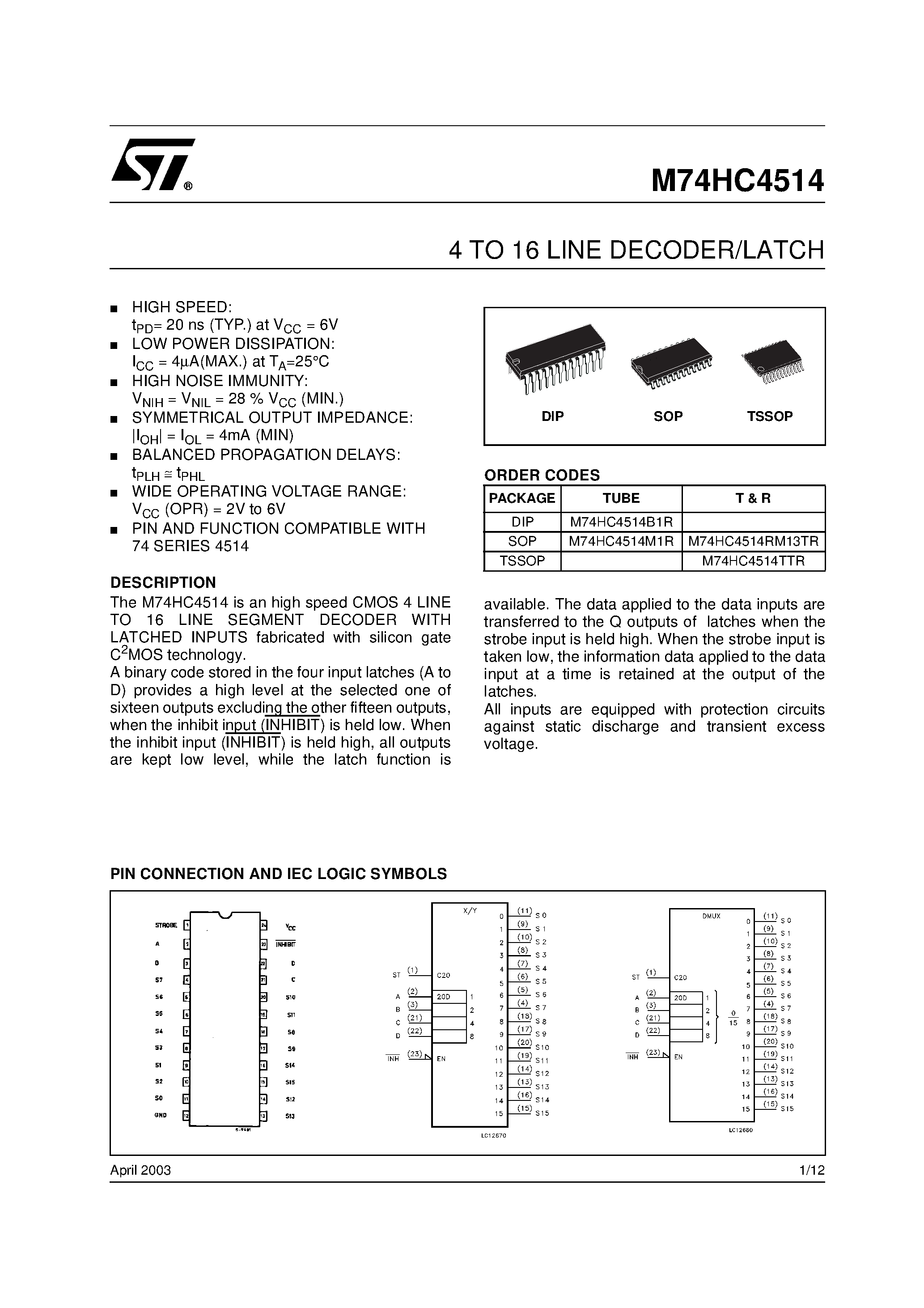

M74HC4514-HC4514: 4 TO 16 LINE DECODER/LATCH HC4515: 4 TO 16 LINE DECODER LATCH INV.
Producer:ST Microelectronics
Description:HC4514: 4 TO 16 LINE DECODER/LATCH HC4515: 4 TO 16 LINE DECODER LATCH INV.
