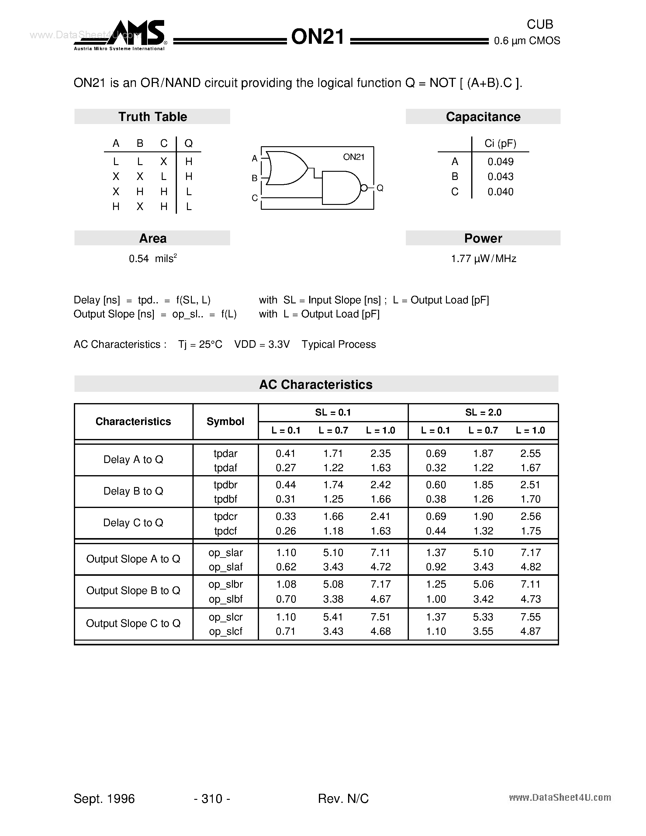

ON21-OR / NAND circuit providing the logical function Q = NOT
Producer:ETC
Description:OR / NAND circuit providing the logical function Q = NOT
Others with the same file: ON21
Datasheet ON21 - OR / NAND circuit providing the logical function Q = NOT page 1
