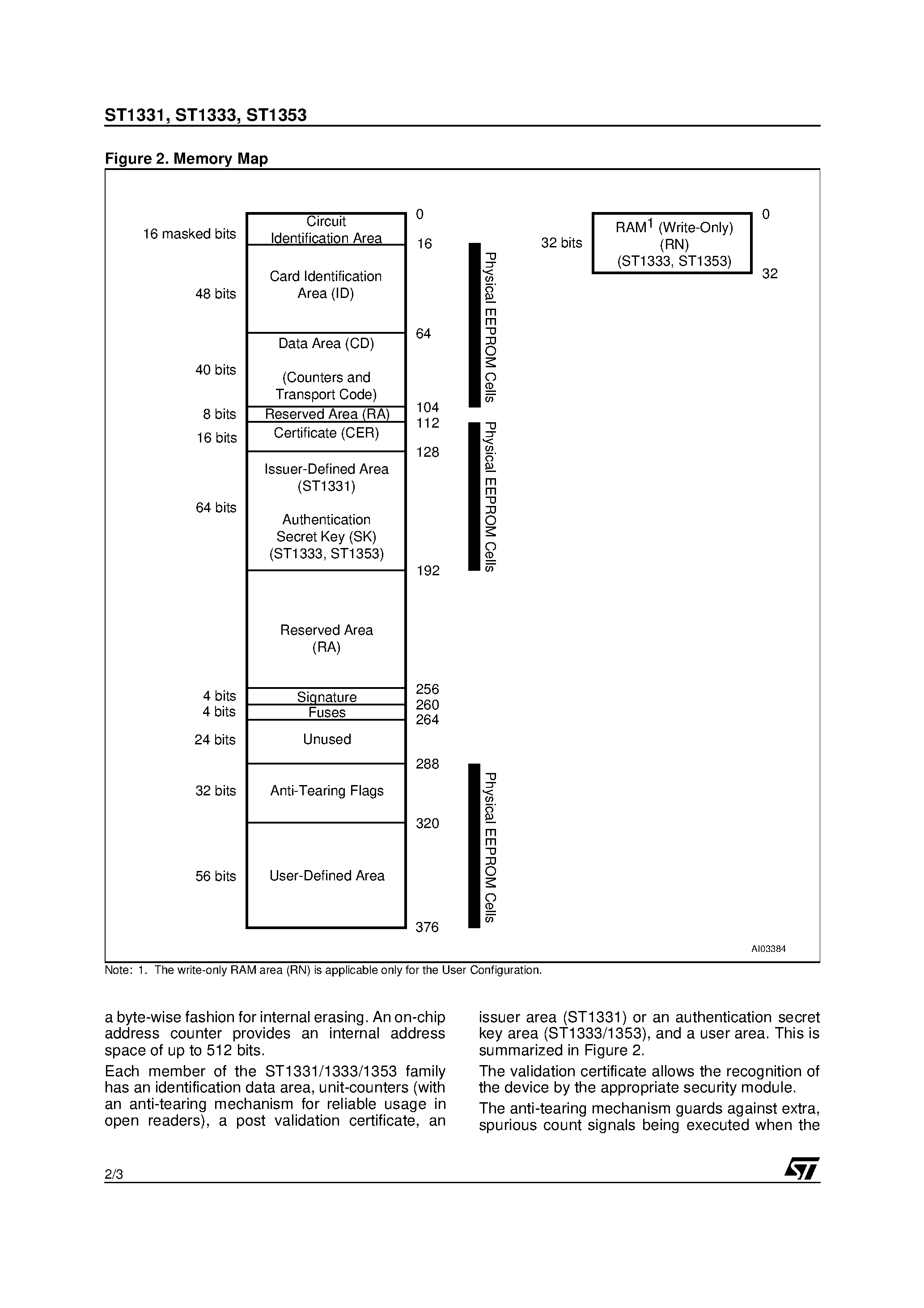

ST1331-(ST1331/1333/1353) 6-Contact Memory Card IC 272-bit EEPROM with Advanced Security Mechanisms
Producer:ST Microelectronics
Description:(ST1331/1333/1353) 6-Contact Memory Card IC 272-bit EEPROM with Advanced Security Mechanisms
