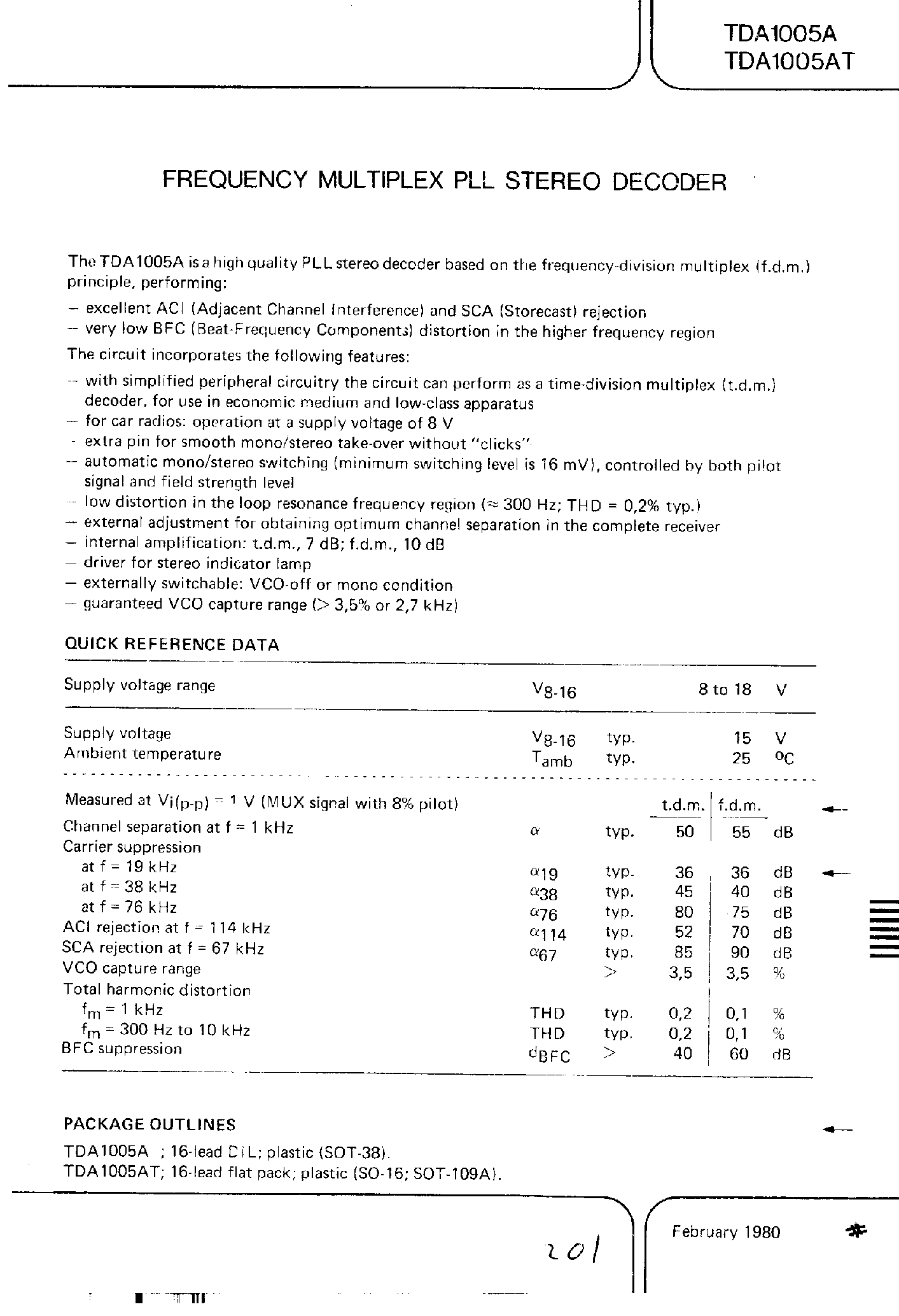

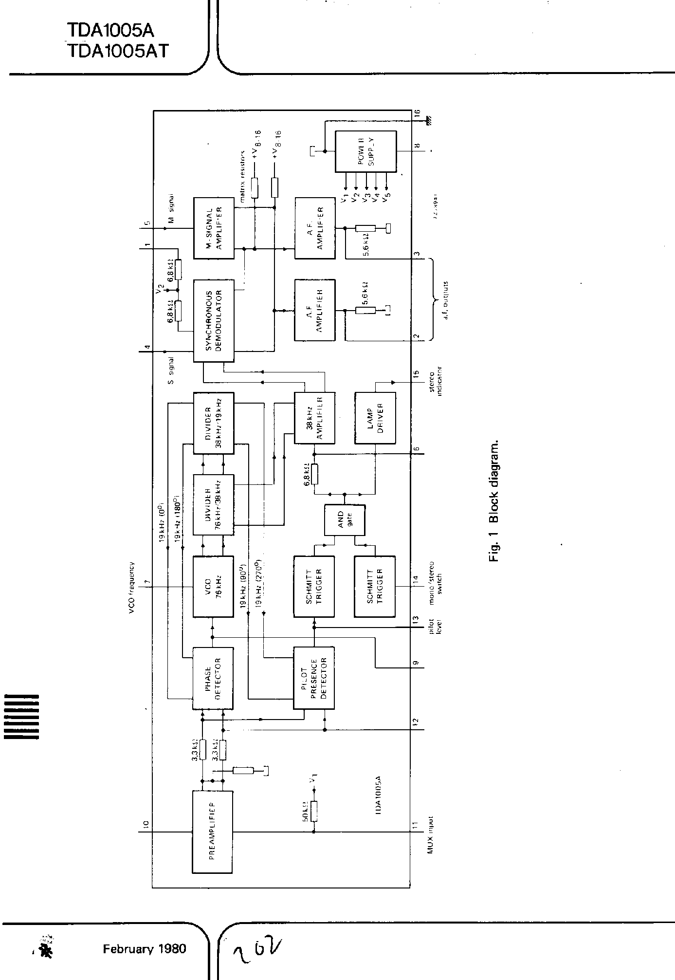

TDA1005AT-FREQUENCY MULTIPLEX PLL STEREO DECODER
Description:FREQUENCY MULTIPLEX PLL STEREO DECODER
Others with the same file: TDA1005AT
Datasheet TDA1005AT - FREQUENCY MULTIPLEX PLL STEREO DECODER page 1
Datasheet TDA1005AT - FREQUENCY MULTIPLEX PLL STEREO DECODER page 2
