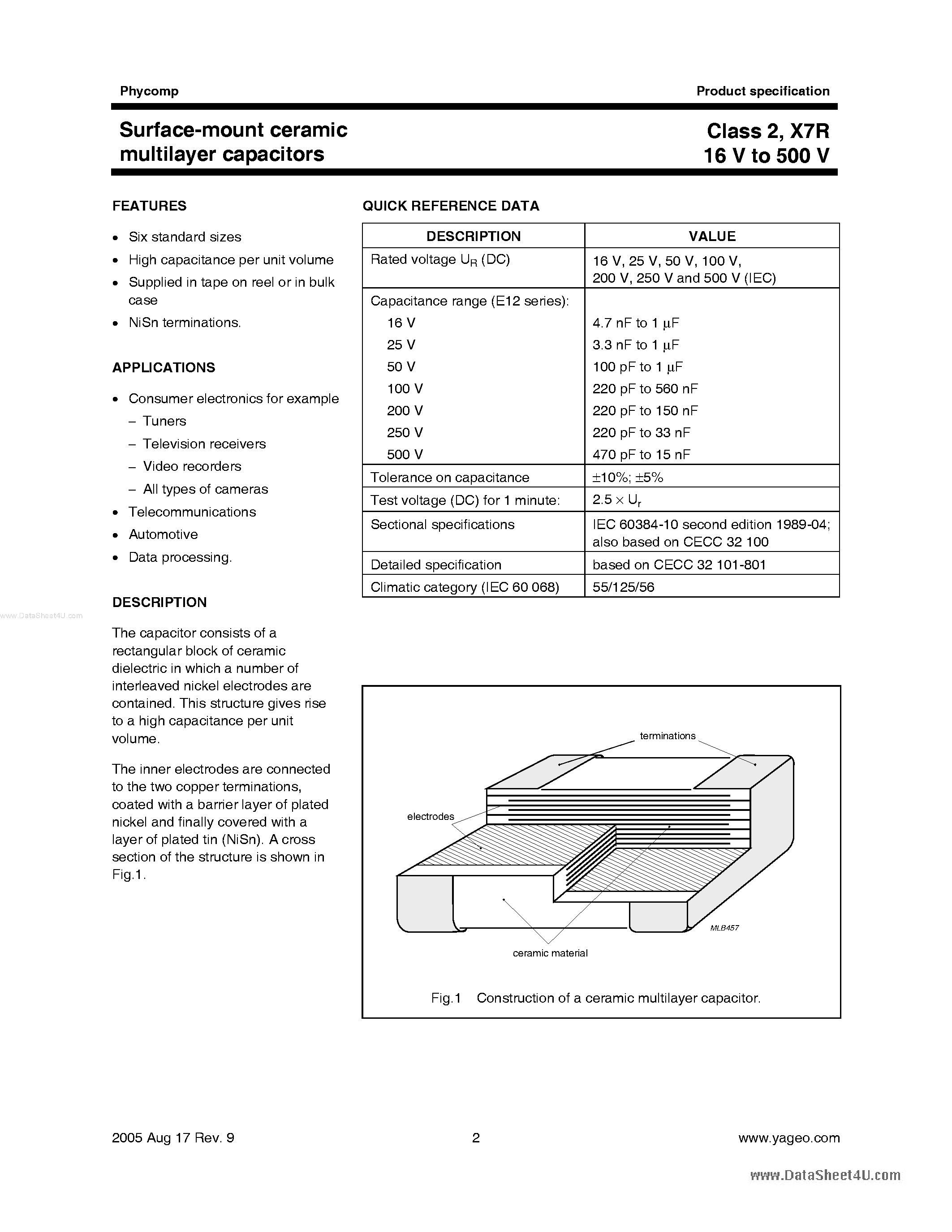

FEATURES • Six standard sizes • High capacitance per unit volume • Supplied in tape on reel or in bulk case • NiSn terminations. APPLICATIONS • Consumer electronics for example − Tuners − Television receivers − Video recorders − All types of cameras • Telecommunications • Automotive • Data processing. DESCRIPTION The capacitor consists of a rectangular block of ceramic dielectric in which a number of interleaved nickel electrodes are contained. This structure gives rise to a high capacitance per unit volume. The inner electrodes are connected to the two copper terminations, coated with a barrier layer of plated nickel and finally covered with a layer of plated tin (NiSn). A cross section of the structure is shown in Fig.1.
Construction of a ceramic multilayer capacitor

Rated voltage UR (DC)
16 V, 25 V, 50 V, 100 V, 200 V, 250 V and 500 V (IEC)
Capacitance range (E12 series): 16 V 25 V 50 V 100 V 200 V 250 V 500 V
4.7 nF to 1 pF 3.3 nF to 1 pF 100 pF to 1 pF 220 pF to 560 nF 220 pF to 150 nF 220 pF to 33 nF 470 pF to 15 nF
Tolerance on capacitance
±10%; ±5%
Test voltage (DC) for 1 minute:
2.5 x Ur
Sectional specifications
IEC 60384-10 second edition 1989-04; also based on CECC 32 100
Detailed specification
based on CECC 32 101-801
Climatic category (IEC 60 068)
55/125/56
