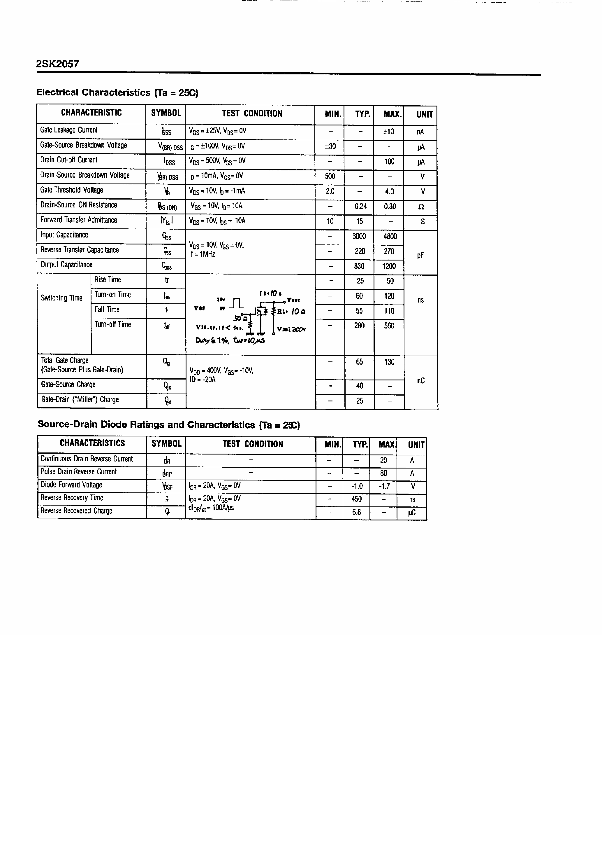

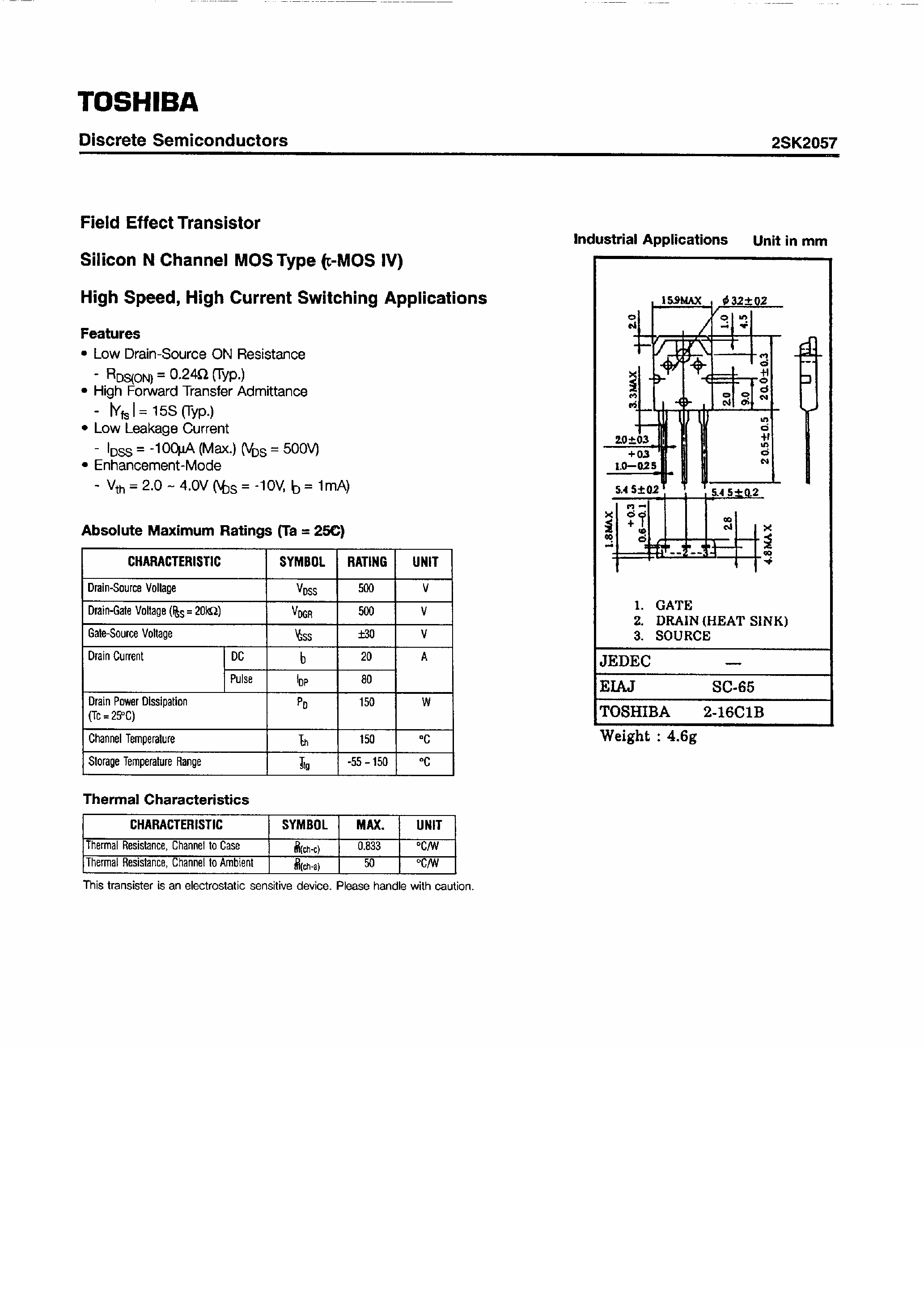

2SK2057-Field Effect Transistor / Silicon N Channel MOS Type
