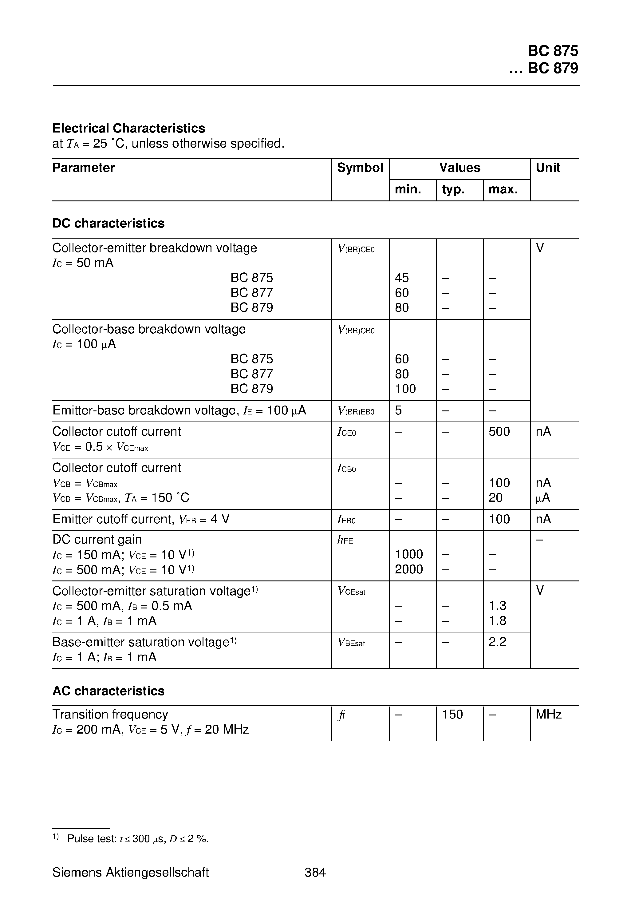

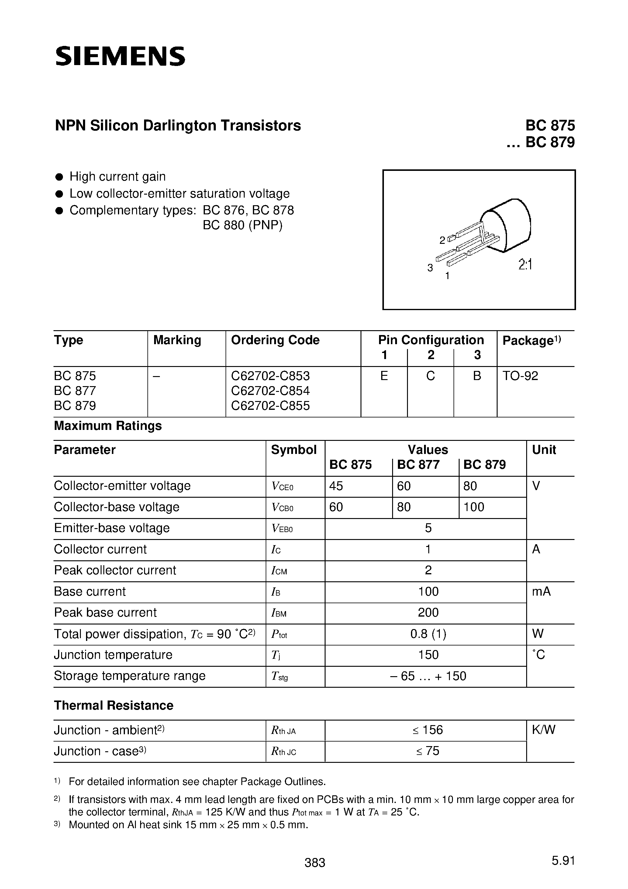

BC875-NPN Silicon Darlington Transistors (High current gain Low collector-emitter saturation voltage
Наименование:BC875
Описание:NPN Silicon Darlington Transistors (High current gain Low collector-emitter saturation voltage
