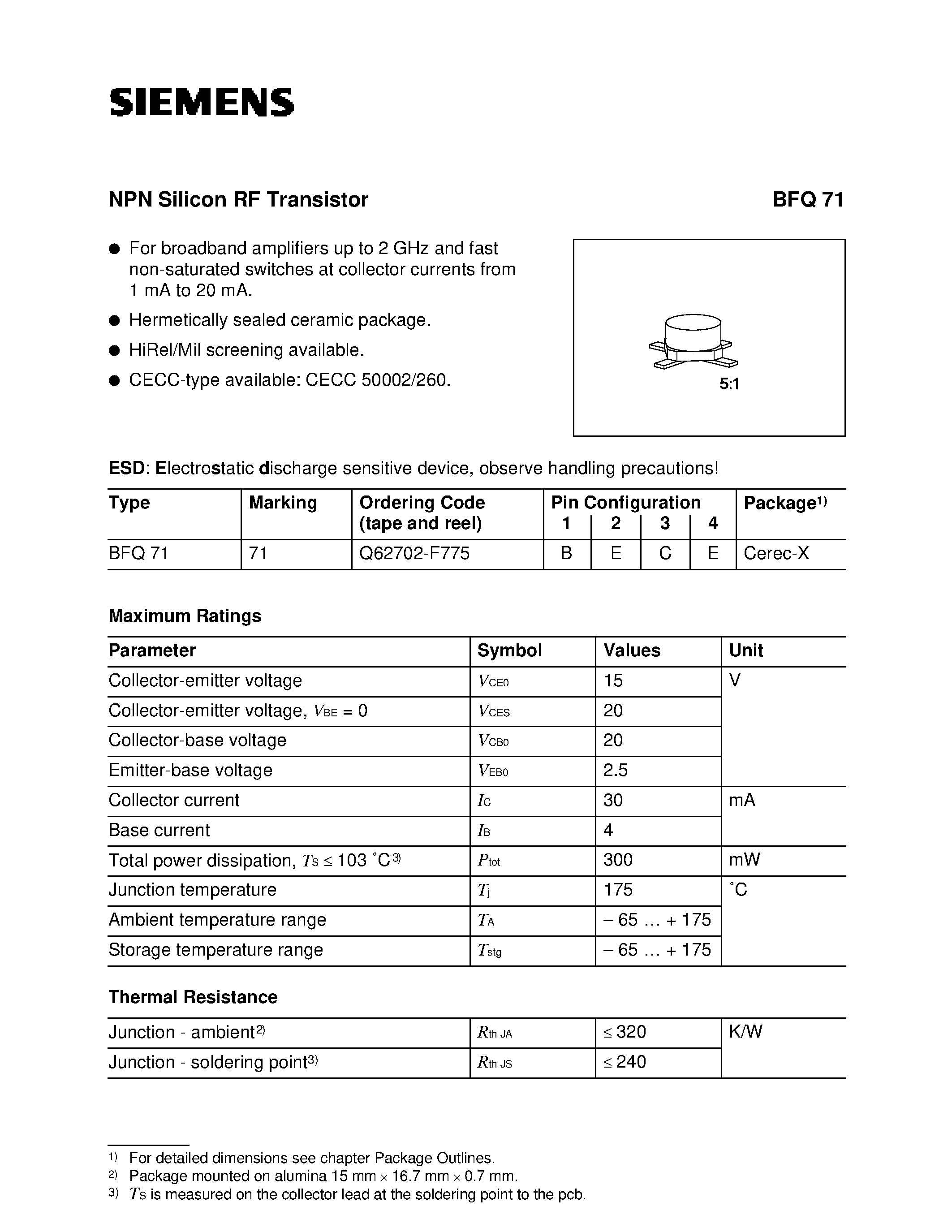

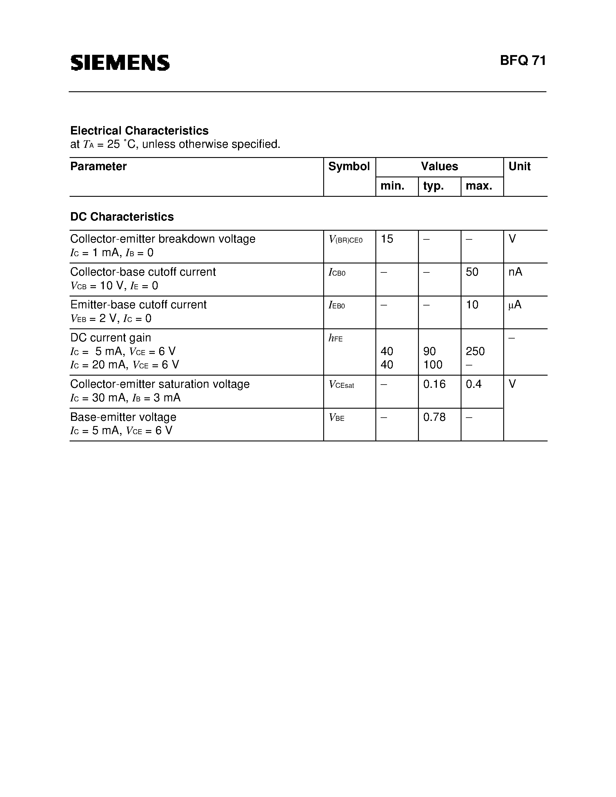

BFQ71-NPN Silicon RF Transistor (For broadband amplifiers up to 2 GHz and fast non-saturated switches at collector currents from 1 mA to 20 mA.)
Наименование:BFQ71
Описание:NPN Silicon RF Transistor (For broadband amplifiers up to 2 GHz and fast non-saturated switches at collector currents from 1 mA to 20 mA.)
