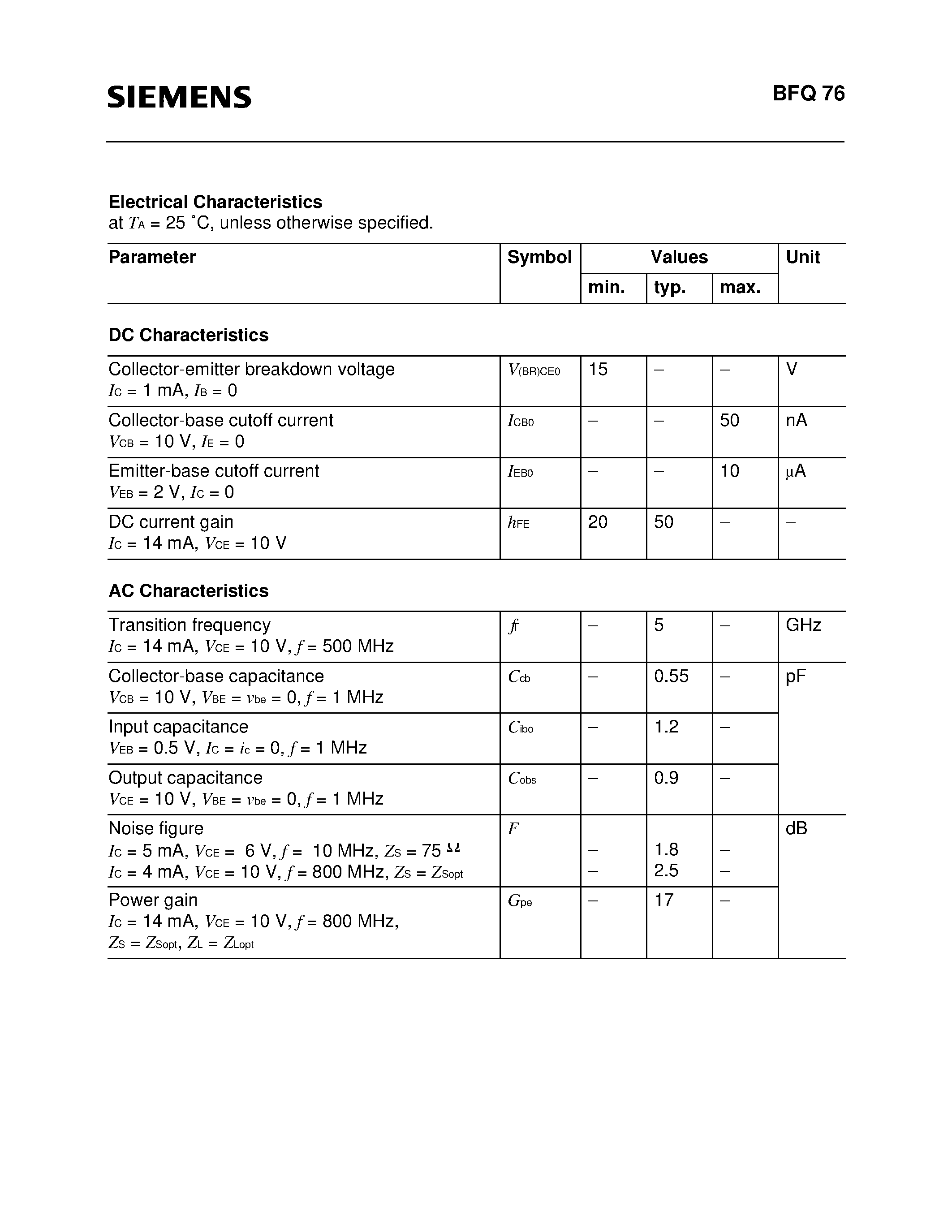

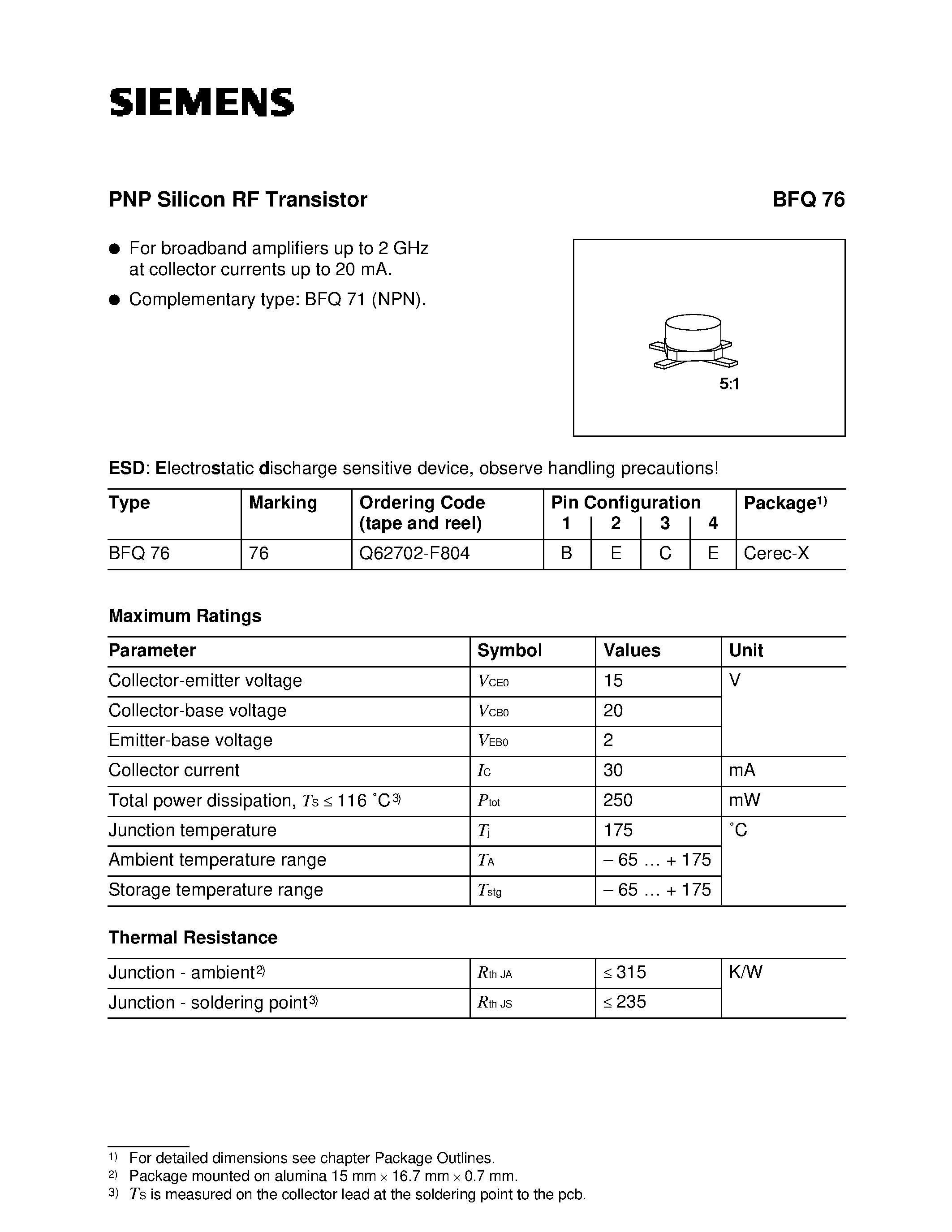

BFQ76-PNP Silicon RF Transistor (For broadband amplifiers up to 2 GHz at collector currents up to 20 mA.)
Наименование:BFQ76
Описание:PNP Silicon RF Transistor (For broadband amplifiers up to 2 GHz at collector currents up to 20 mA.)
