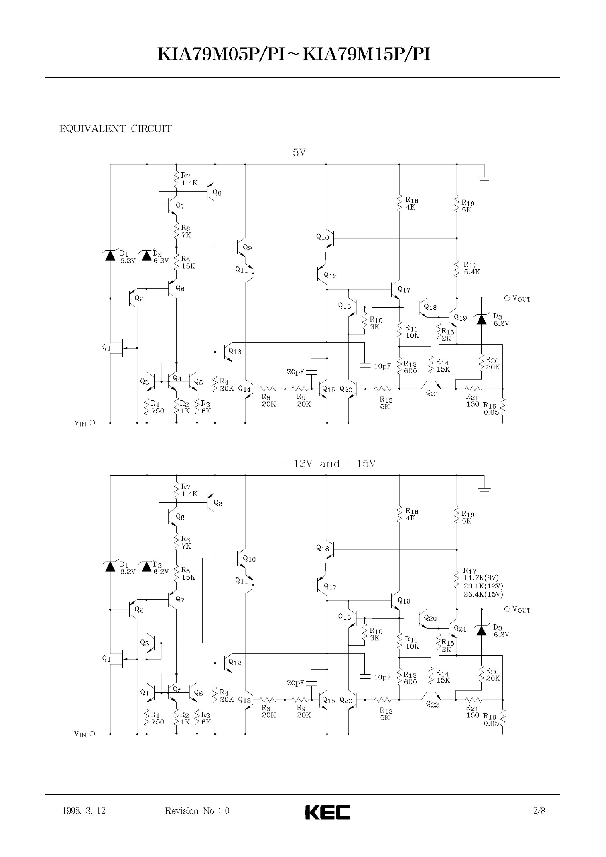

KIA79M12P-BIPOLAR LINEAR INTEGRATED CIRCUIT (THREE TERMINAL NEGATIVE VOLTAGE REGULATORS)
