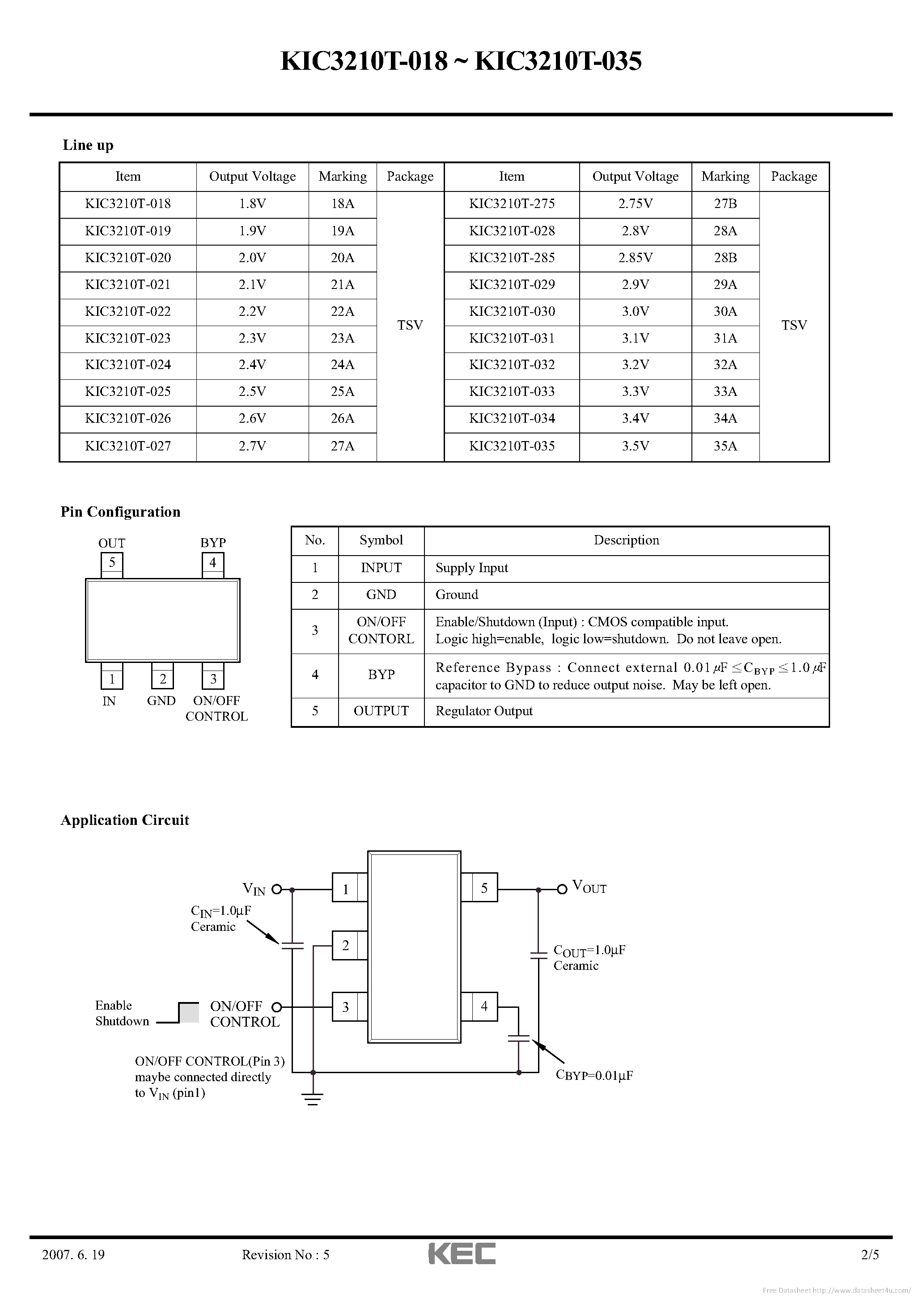

KIC3210T-018 ~ KIC3210T-035
150mA CMOS High Performance LDO Regulator
The KIC3210T series Low Dropout Linear Regulator is ideally suited for portable applications. It offers 1% initial accuracy, extremely-low dropout voltage(135mV at 150mA) and low ground current (typically 90uA). Designed specifically for handheld and battery-powered devices, the KIC3210T provides a TTL-logic-compatible ON/OFF control pin. When disabled, power consumption drops nearly to zero. The KIC3210T also works with low-ESR ceramic capacitors, reducing the amount of board space necessary for power applications, critical in handheld wireless devices.
Features
• Input voltage range : 2.7V to 6.0V
• Stability with ceramic output capacitors
• Ultra-low dropout : 135mV @ 150mA
• High output accuracy : 1.0% accuracy
• Low quiescent current: 90mA
• TTL-Logic-compatible ON/OFF control input
• “Zero” off-mode current
• Thermal shutdown and current limit protection
Applications
• Cellular phones,Smart Phones, PDA
• Battery-powered equipment
• Laptop, notebook and palmtop computers
• Consumer/personal electronics
