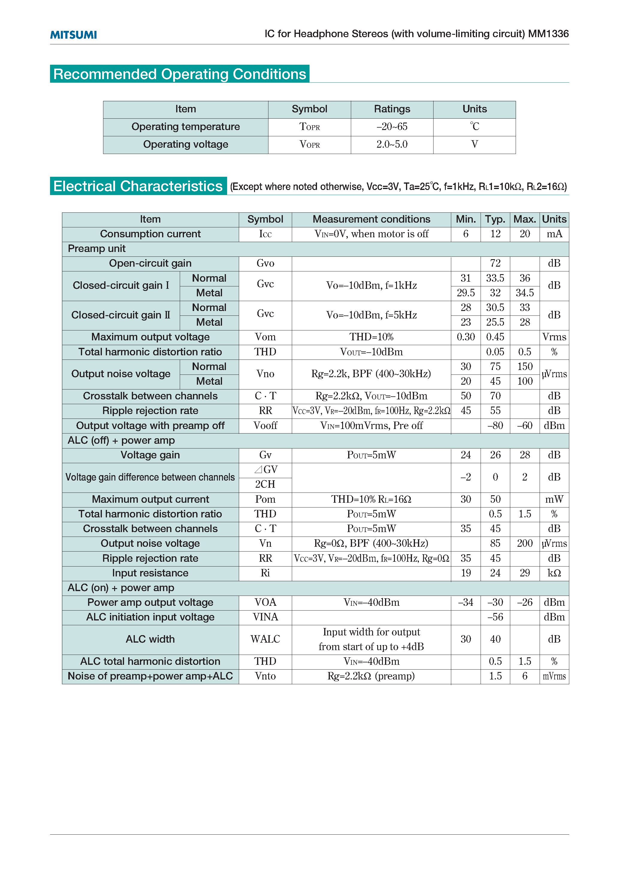

MM1336-IC for Headphone Stereos (with volume-limiting circuit) Monolithic IC MM1336
Наименование:MM1336
Производитель:MITSUMI
Описание:IC for Headphone Stereos (with volume-limiting circuit) Monolithic IC MM1336
