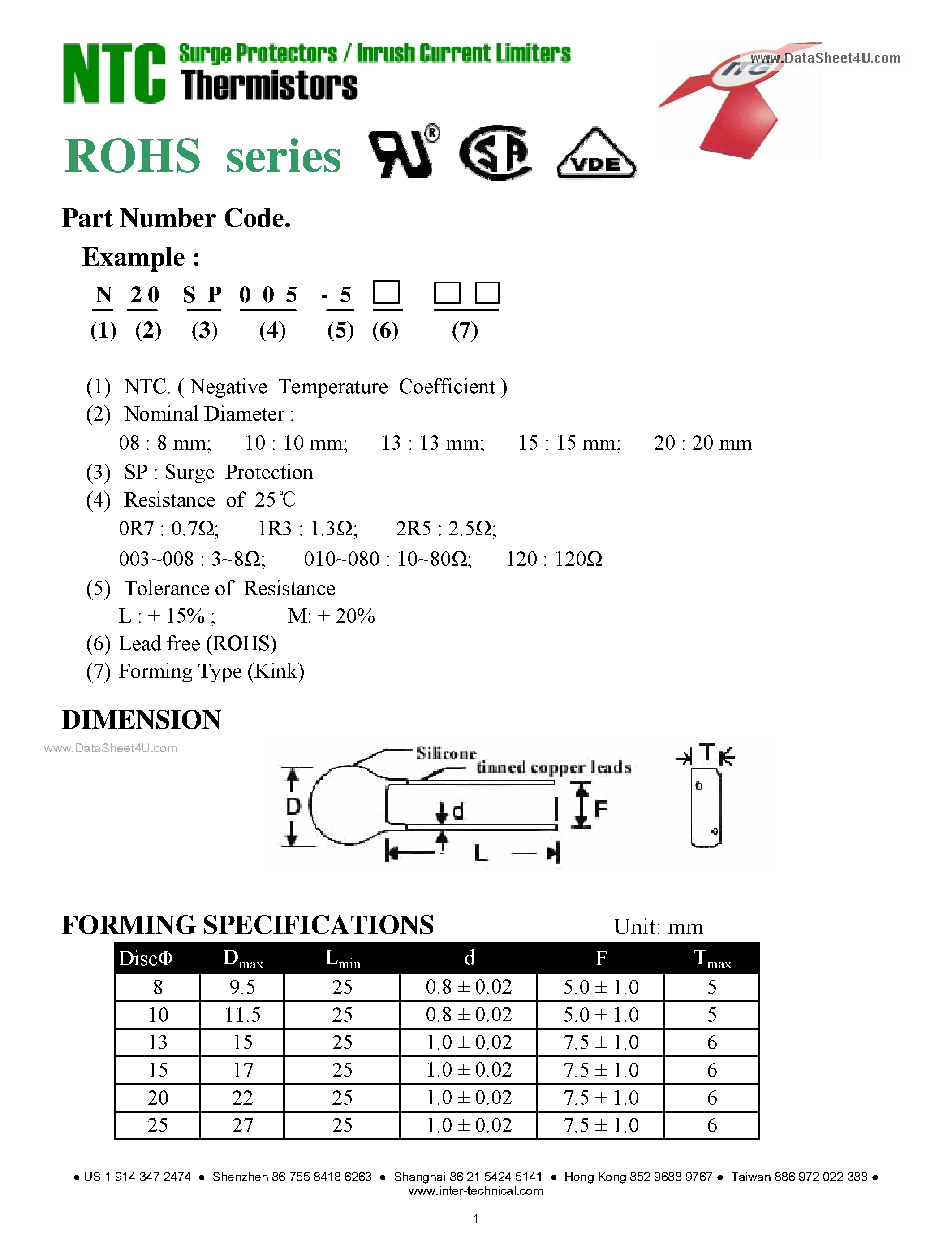

08SP003-5-ROHS series Наименование: 08SP003-5 Производитель: NTC Скачать даташит (datasheet): Скачать Описание: ROHS series Подробное описание: Part Number Code. (1) NTC. ( Negative Temperature Coefficient ) (2) Nominal Diameter : 08 : 8 mm; 10 : 10 mm; 13 : 13 mm; 15 : 15 mm; 20 : 20 mm (3) SP : Surge Protection (4) Resistance of 25℃ 0R7 : 0.7Ω; 1R3 : 1.3Ω; 2R5 : 2.5Ω; 003~008 : 3~8Ω; 010~080 : 10~80Ω; 120 : 120Ω (5) Tolerance of Resistance L : ± 15% ; M: ± 20% (6) Lead free (ROHS) (7) Forming Type (Kink) DIMENSION
FORMING SPECIFICATIONS Unit: mm DiscФ
Dmax
Lmin
d
F
Tmax
8
9.5
25
0.8 ± 0.02
5.0 ± 1.0
5
10
11.5
25
0.8 ± 0.02
5.0 ± 1.0
5
13
15
25
1.0 ± 0.02
7.5 ± 1.0
6
15
17
25
1.0 ± 0.02
7.5 ± 1.0
6
20
22
25
1.0 ± 0.02
7.5 ± 1.0
6
25
27
25
1.0 ± 0.02
7.5 ± 1.0
6
