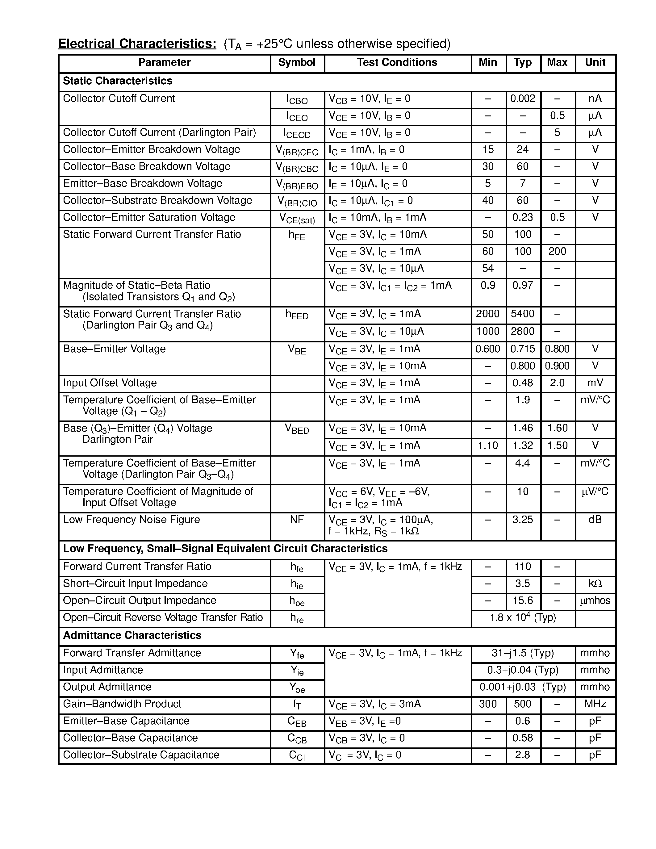

NTE904-Integrated Circuit General Purpose Transistor Array (Two Isolated Transistors and a Darlington Connected Transistor Pair)
Наименование:NTE904
Производитель:NTE Electronics
Описание:Integrated Circuit General Purpose Transistor Array (Two Isolated Transistors and a Darlington Connected Transistor Pair)
