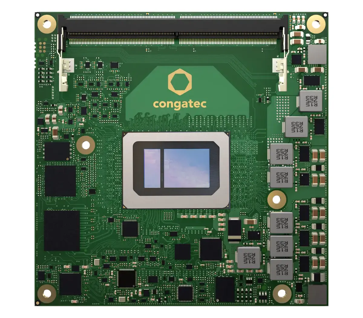

congatec conga-TC300 COM Express module
congatec conga-TC300 COM Express Type 6 Compact module with Wildcat Lake processor
Processor Options
  • Intel Core 7 350: 6 cores (2P + 4E), up to 4.6 GHz, 21 TOPS GPU, 17 TOPS NPU
  • Intel Core 5 320: 6 cores, up to 4.6 GHz, 20 TOPS GPU, 16 TOPS NPU
  • Intel Core 3 305: 6 cores, up to 4.3 GHz, 9 TOPS GPU
Key Specifications
  • Up to 64 GB DDR5-6400 SO-DIMM memory
  • Optional onboard UFS 3.1 storage
  • Intel i226 2.5GbE controller with TSN support
  • Display interfaces: up to 2x DDI (shared with USB4), LVDS or eDP
  • Up to 2x USB4, 4x USB 3.2 Gen2, up to 8x USB 2.0
  • PCIe: 4x Gen4 + optional 4x Gen3
  • TPM 2.0 security, congatec Board Controller
  • Dimensions: 95 × 95 mm (COM Express Compact)

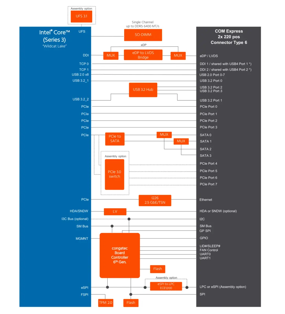

conga-TC300 block diagram
Block diagram of congatec conga-TC300 COM Express module

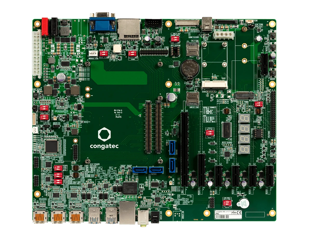

congatec COM Express carrier board
conga-TEVAL COM Express carrier board for module evaluation
