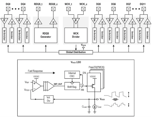

  • Efficiency Mode with dual-subchannel architecture: Enables parallel operation or powers down inactive sub-channels to save energy.
  • LDO-based WCK tree: Reduces write clock jitter by 30% for better timing and stability.
  • Dynamic write NT-ODT: Dynamically adjusts on-die termination for improved signal integrity and lower power.
  • Fast CS control: Optimizes chip-select handling across frequency ranges, cutting setup/hold delays and current draw.
  • System meta mode: Interleaves metadata into data packets, eliminating dedicated pins and reducing complexity/power.
WCK distribution network with LDO regulator
WCK distribution network and global LDO regulator diagram
