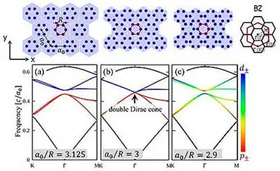

However, in the new approach, called topological nanoarchitectonics, the MANA researchers are said to have realised a topological photonic crystal by merely adjusting the positions of insulator or semiconductor nanorods in a honeycomb lattice.
When hexagonal clusters are formed by adjusting the positions of nanorods, electromagnetic modes carrying spin appear. As a result, the MANA researchers theoretically clarified that a photonic crystal exhibits topological properties when the separation between hexagonal clusters is narrowed from that of the honeycomb lattice.

Schematic of photonic crystals consisting of nanorods derived from the honeycomb lattice viewed from above, and (bottom) the corresponding photonic bands
Pic: (Top) Schematic of photonic crystals consisting of nanorods derived from the honeycomb lattice viewed from above, and (bottom) the corresponding photonic bands.
